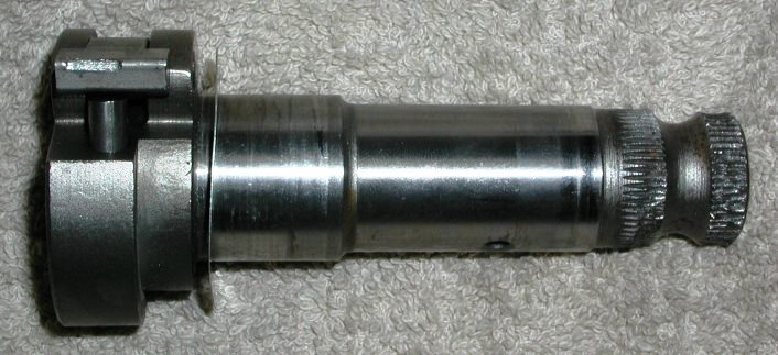

i am looking for some advice my norton commando 1974 with the spark plugs out i can turn the engine with the kickstart but with plugs in it does not catch inside the gearbox the spline on the shaft and kickstart is good
Sounds like the pawl inside the k/s shaft is worn or it's small spring has rusted out and broken. Both covers need removal and even if you have a manual and are capable take a look at this site http://www.oldbritts.com/ob_start.htmlgo to Tech articles - Gearbox etc. Lots of pics including one of a worn pawl.
