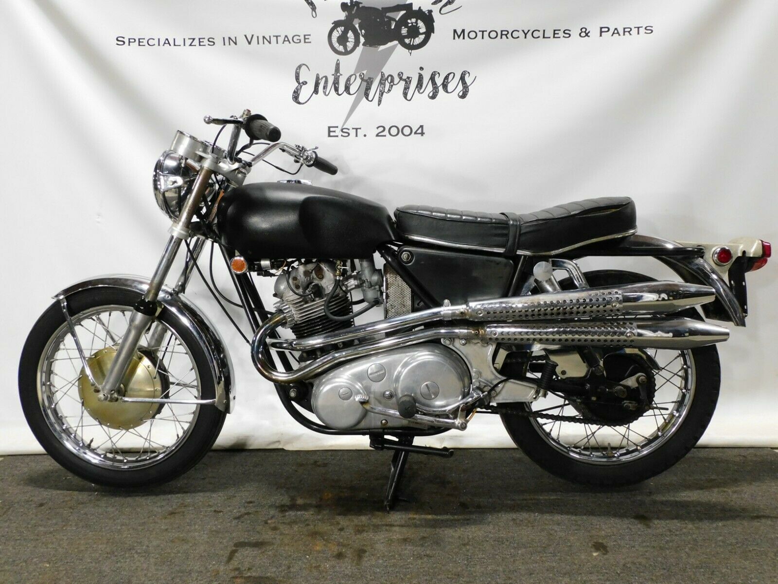

Anthony- need pictures of the 70 S please!

The fibre tanks do have a different shape and they're always visibly different but the same tank was used on the Roadster and they were sold fibre and steel together for a while in different markets so to Norton, they were interchangeable.
The steel tank that looks most like the fibre was used on the '75 Mk3 850s as it seems that they lost the press tooling and made a batch of fully-welded tanks with no seam behind the headstock.

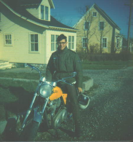

"I have a 1970 Commando Roadster, which is an S type but with out the high pipes."
As an origtinal owner of a new 70 Roadster I wonder about this statement? Sorry I did not keep it. Which is a noteable story in it's self.
The only real; issue is was the chrome air filter and silver metal flake tail light housing consistant for both? I do not think so, but not sure.
I currently own 2 series 1 commando's and am building one as "S" and the second as a "clone" of my first commando I owned in 1970.
The "S" front fender (bridge) and stays are a one model only item. "S" is definitely shorter than standard commando bridge and stays. Tank colors and decals were the only difference I could notice
