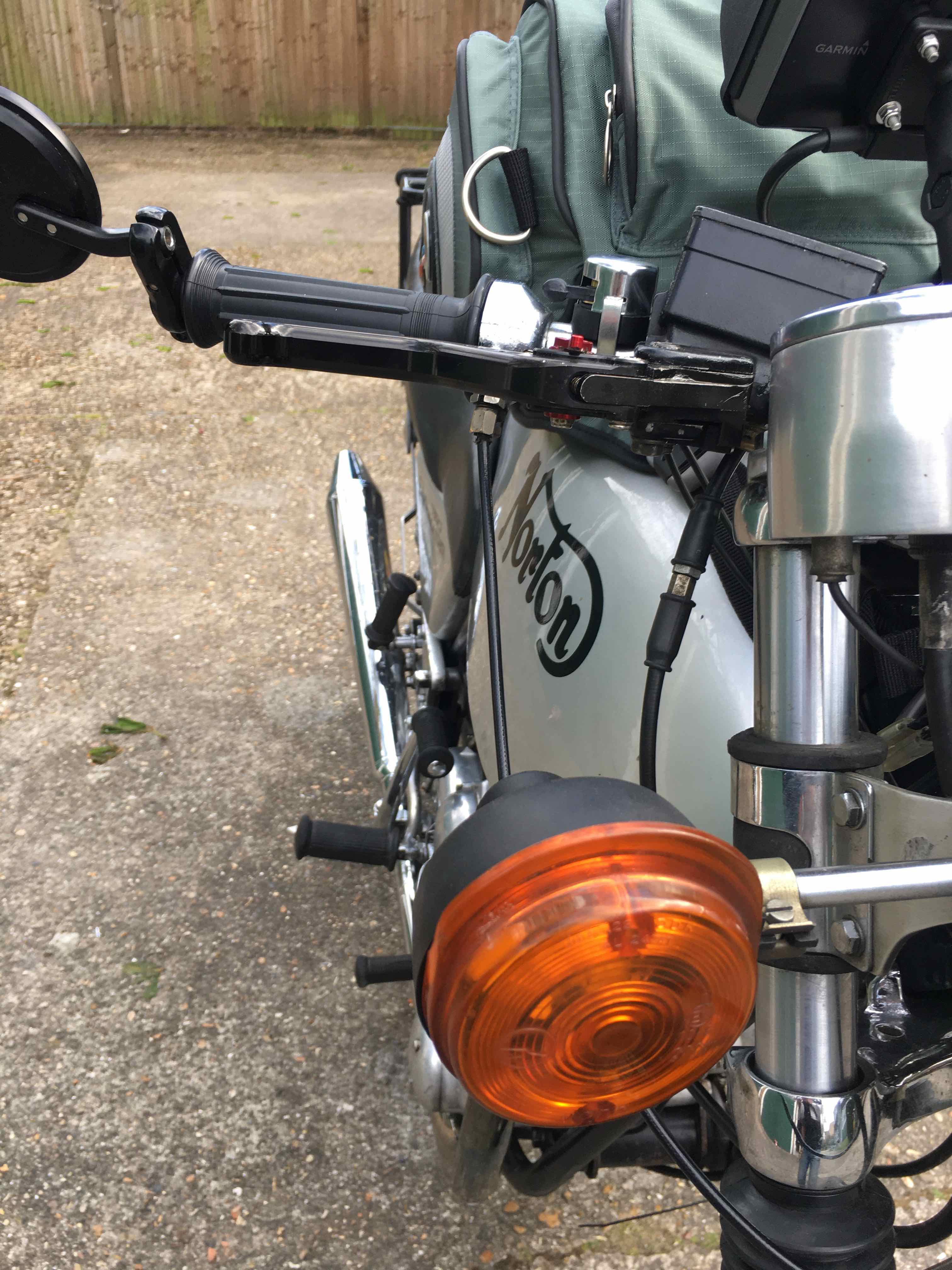

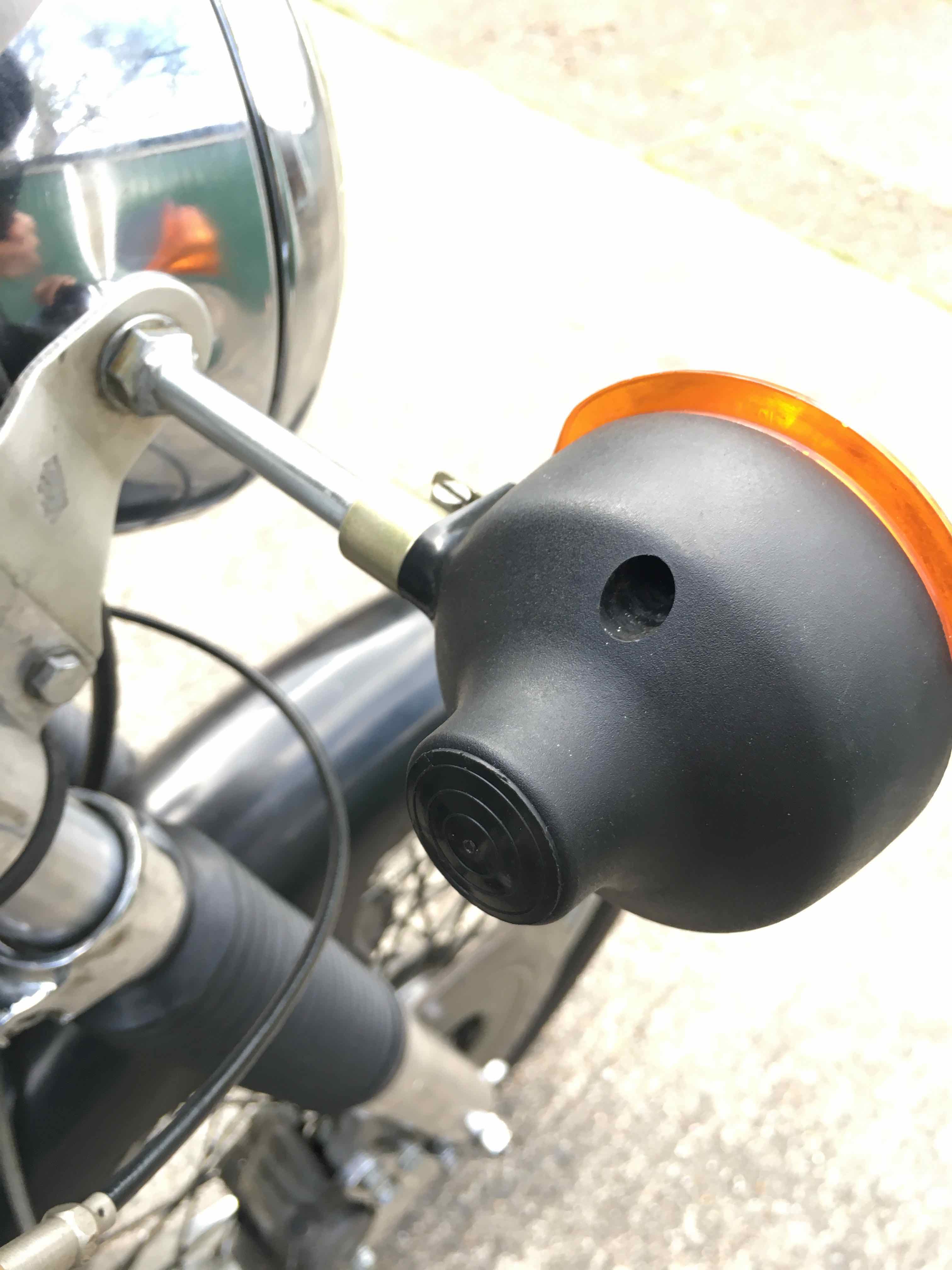

By a happy accident, my among my Fastback's souvenirs from a career on the Continent is a headlamp shell with captive nuts that proved to have the exact same metric thread as MZ indicators, hence the set-up shown in the attached pictures. (The stems for the rear indicators are cut down from bent front indicator stems — and the brackets from the carrier are off-cuts from un-needed portions of the Craven carrier stays.)
For my money these are much nicer, because less obtrusive, than the flashy (sorry!) Lucas ones. They are also have convenient tell-tales moulded into the front lenses (which means you are legally exempted from having an indicator warning light, since they can be seen from the saddle), and have proper wired earths.
Lovely result but OH those jubilee clips, a quick wipe with a rag and you can get 'bleeding' fingers!!
