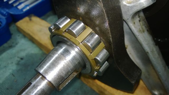

HelloI would like to ask, What and how caused problem which you can see in attachment.Attachments

Certainly something that s…
Certainly something that shouldn't have been there. Ouch.
Could be the start of a ma…
Could be the start of a major engine rebuild. If the followers are like this, what are the bearings like?
I would say that this engi…
I would say that this engine has been rebuilt after a major component failure and then run again with some debris left inside of it. As John says the rest of the engine could also be on the verge of failing again.
The bad news is........if the followers are this scored then the follower tunnels are not likely to be much better and may need to be lined.
Bearings are ok.
Looks like someone sand or…
Looks like someone sand or bead blasted with the followers in positionand did not clean out .Bearing in mind the age of our engines ,is it time that someone made up some followers oversize?.

Using emery cloth to clean off old gasket etc, remnants of bead or sandblasting,a total lack of oil, take your pick.
