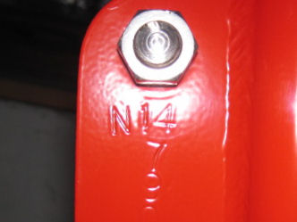

Sorry to be the bearer of bad news but I'd be worried too. The 'N' prefix applies to 1958 models - i.e. pre-slimline frame. The font used for the N is different to that used by Norton (see my pic) as well. This and the remains of the second frame number tends to indicate that all is not as it should be. From the look of the font, the vertical frame number on the left appears to be the genuine one.
Norton stopped using the pre'fix letter after 1960 (R) so your frame may not have had one. Sadly, however,the frame number would have been the key to dating it and would have told what model it was.
The piece welded into the frame is in the spot where a 'loop' would be put in if someone wanted to put a BSA motor in - it needs this modification to clear the oil pump housing in the crankcase. Maybe this has been done in the past and someone has 'un-modified' it
Here's a picture ot that frame prefixnumber on my own 1958 99 thatI'm restoring at the mo'. It's been in the family since 64 and I'm as certain as anyone can be that its number and fontis genuine.
