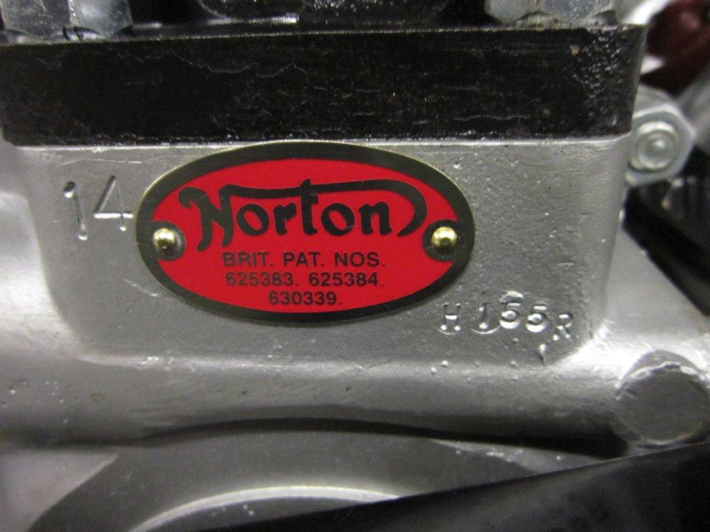

That makes alot more sence, the numbers on the frame are 0504 so it sounds to me like its a new built frame. Could someone tell me if the engine number is an original norton number because the bore and stroke of this engine is 66 x 72.6 and it has been tuned by hemming.
Here is a picture of the engine number.

Unfortunately, you have missed the engine number. It's at the front, left side of the crankcase. A bit forward of what your photo shows. The 14 is the model code and is for a 99 600 but 66 x 72.6 are standard 88 dimensions. Have you actually measured these? At the top back of the left crankcase there should be the model type, 88 for a 500 or 99 for a 600. You should see 99 to go with the 14. Of course, you might have an 88 crank inside! Have you got any provenance to show that this motor was one built by Mick Hemmings?

Ihave not measured the bore and stroke, the 66 x 72.6 is what is stamped on the right hand crank case.I shall have another look around the crank cases for the model type and fingers crossed an engine number. so i am guessing that the H115R is the crankcase mating number. the previous owner told me the engine was built by Mick Hemming and the rocker cover has got his name stamed on it.
here is the picture

Just a thought, you could easily have a 99 engine and 88 crank & barrels. The engine model code(14) is telling us what was originally in the engine (600cc crank & barrel), but if you count the fins on the cylinder, there are 8 on the modeld 88 (500cc), and 9 fins on the model 99 berrel (600cc). Its an easy thing to check without doing any work
