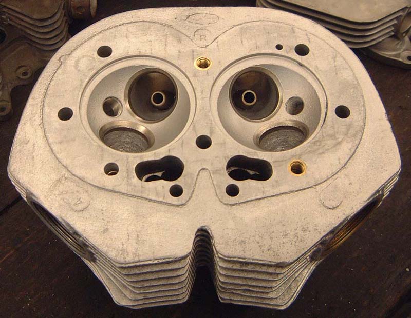

Here's a relevant pic attached of Ian's work on a Commando Head?
