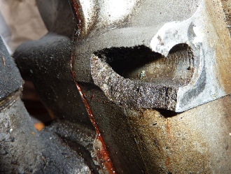

About to start rebuilding and this is the worst bit of the standard components. Is this repairable with the magic goo they call hts2000?
It looks good on the video, stronger and less brittle than the original material. Must be snake oil????

Attachments crankcase2.JPGThe only magic goo to repa…

Thanks for quick reply, looks like I'll have to pay some nice man to weld it for me. Thought goo was too good to be true.

The only magic goo to repair that is ally welding rod applied with a tig torch. Regards John.
