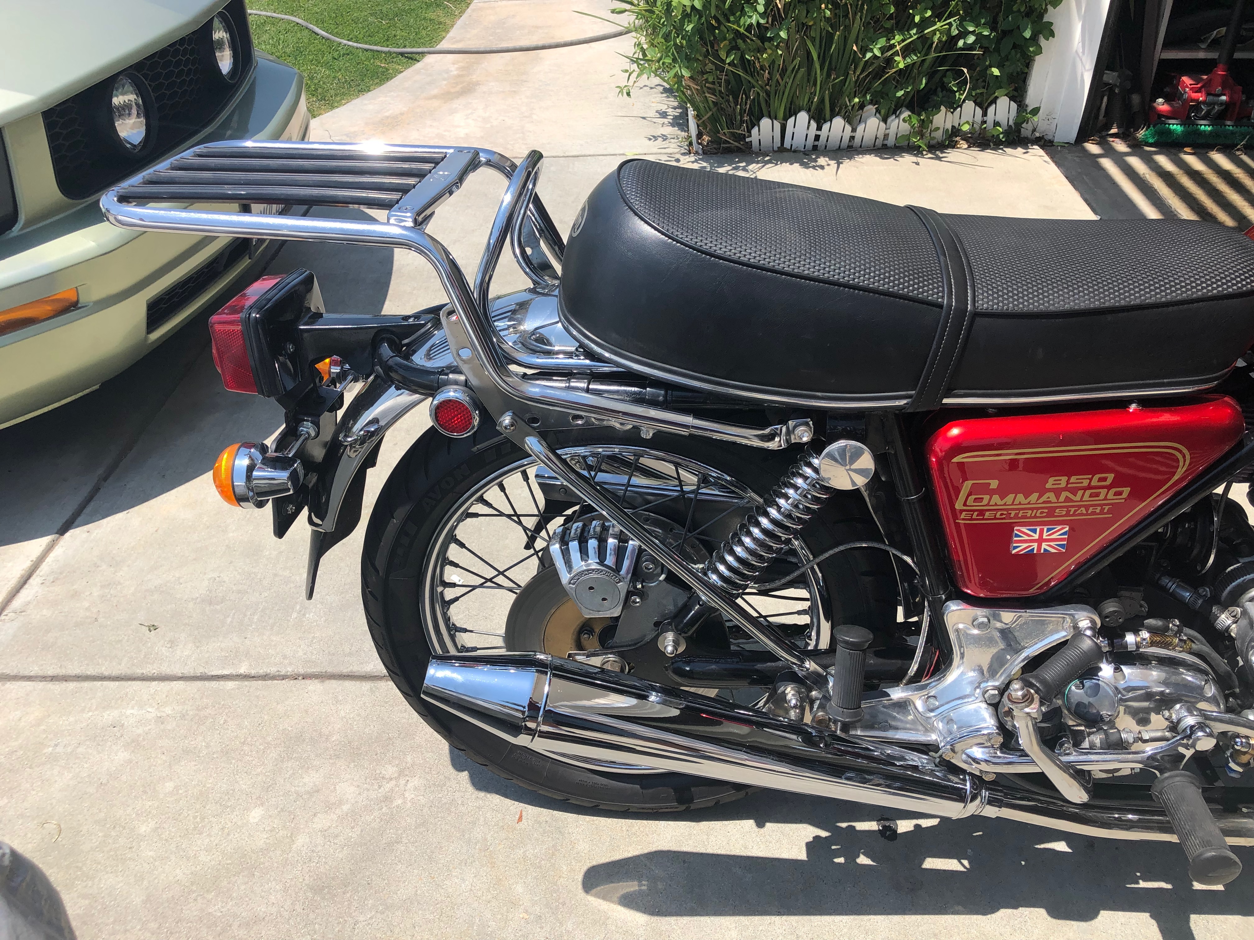

All in stainless and well made, any brown staining at the welds will rub out with 5% phosphoric acid and nylon souring pad.
Mk2 and 2a's have the…
Mk2 and 2a's have the extended rear shock gusset plates so less need for rear hoop supports, my MK2a has had a rack for years and no rear hoop droop. Adding them is not difficult if you plan to carry heavy luggage on the back.

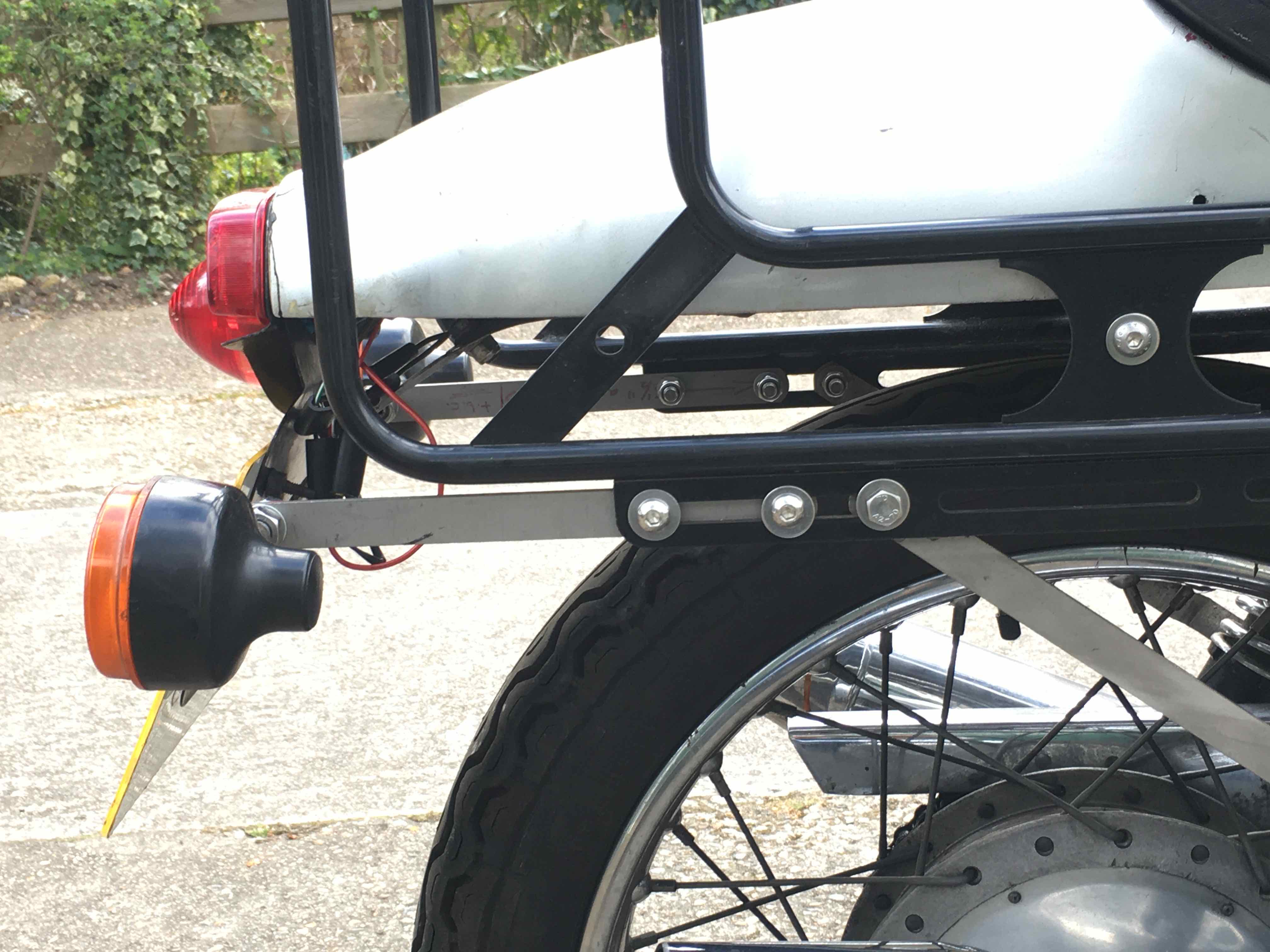

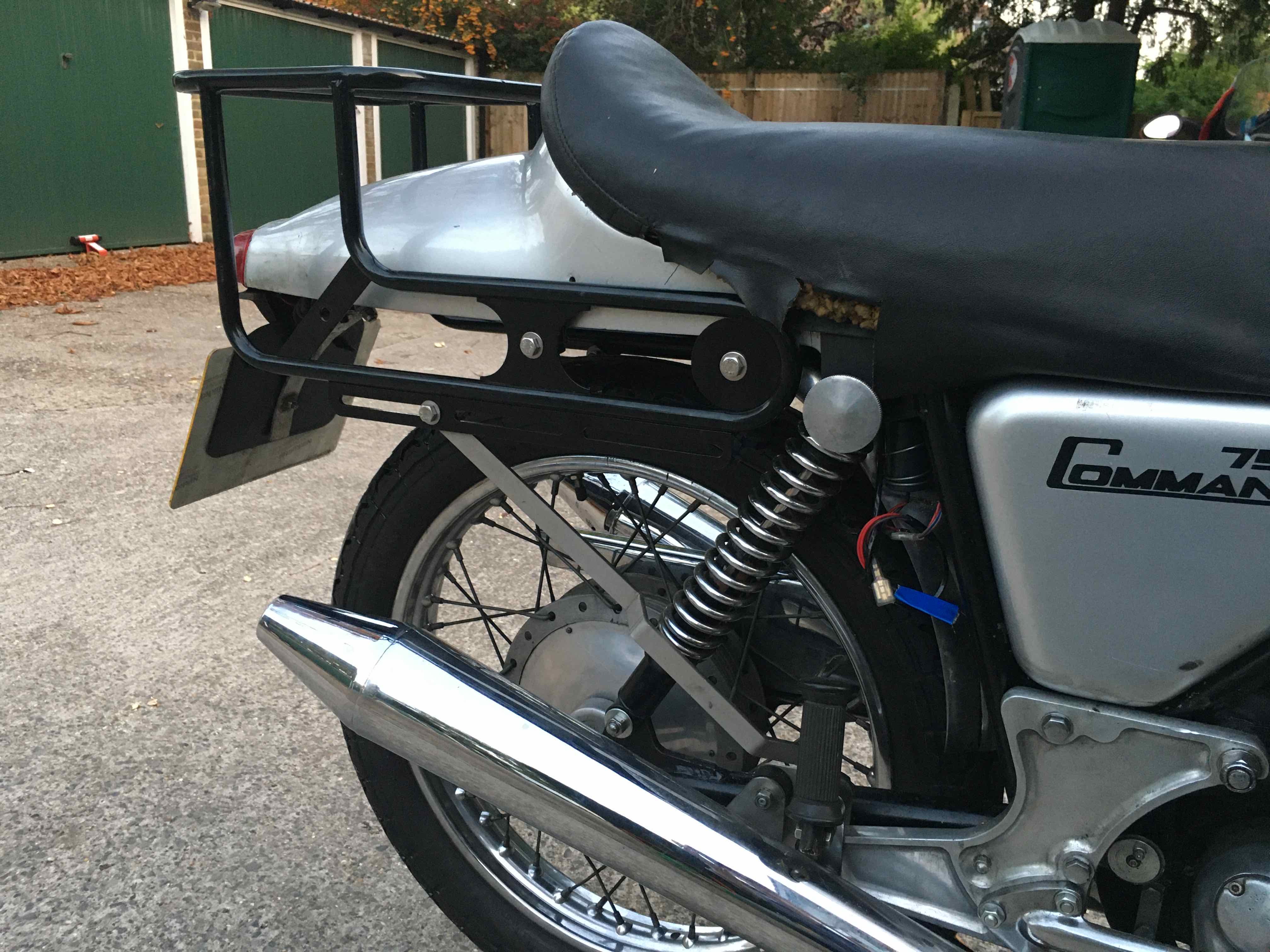

Craven's kit for their L-rack is apparently designed for later models with hinged seats and lacks any means of attachment for other models. Also, it comes by default with J-stays to the pillion footrest mountings which by my lights would put the carrier far too high and too far back.
On my Fastback I was able to easily reproduce the frame-clip and spacer arrangement needed through the good fortune that I still had racing number plates that I made up for Vincent/Velo Club high speed trial in the '70s, designed to fit to the carrier mountings, which thus gave me the required locations for the frame clips.
For the rest, cutting off the short arm of the J-stays gave me items of a suitable length to bolt to the so-called "skis" attached to the lower horizontal rail of the carrier (a worthwhile innovation, in my view).
The J-stay offcuts proved exactly right to hang rear indicators from the carrier skis.

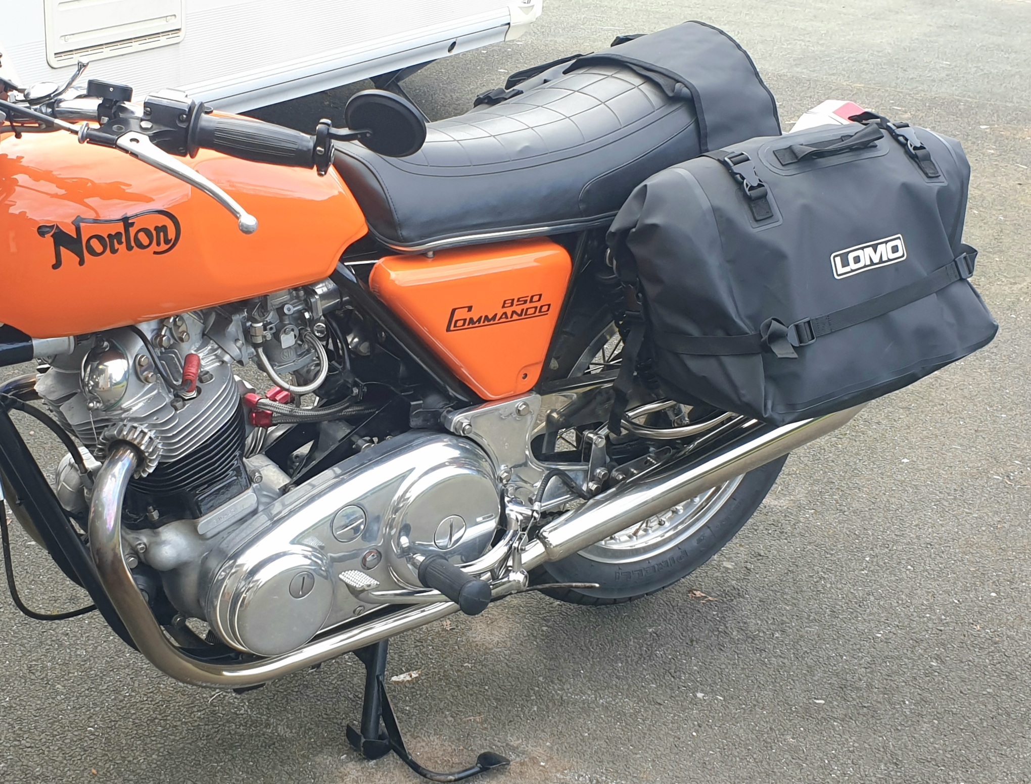

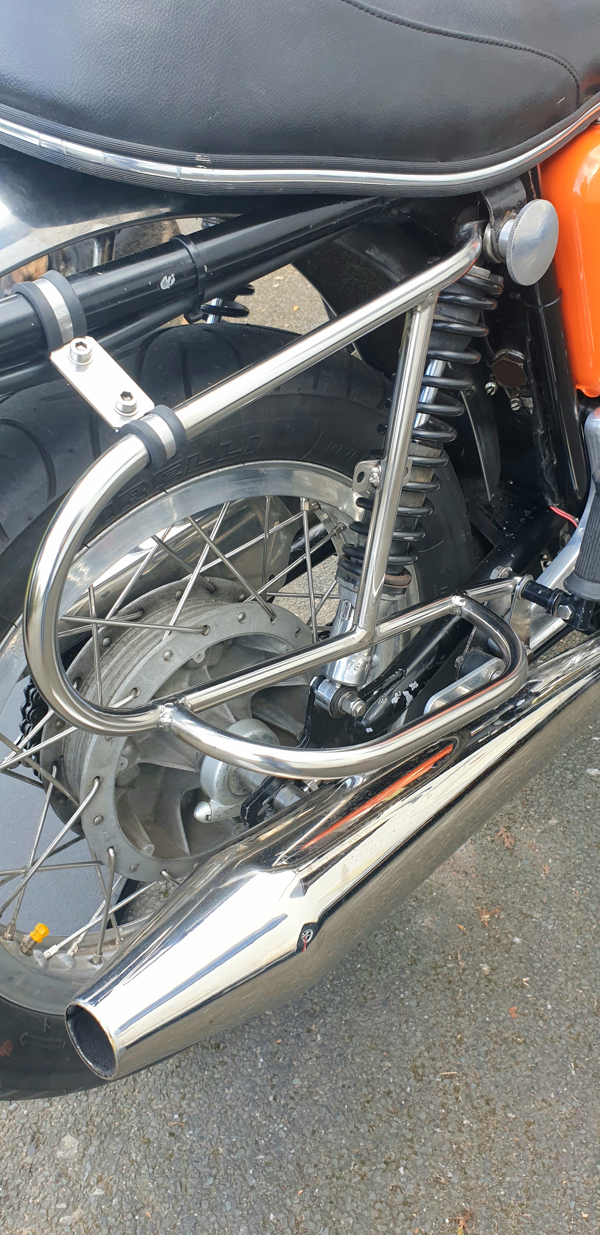

I made my own, £30 for 316…
I made my own, £30 for 316 stainless tube and around £55 for the softbags but realise that's probably too much hassle for you, seems to work well though

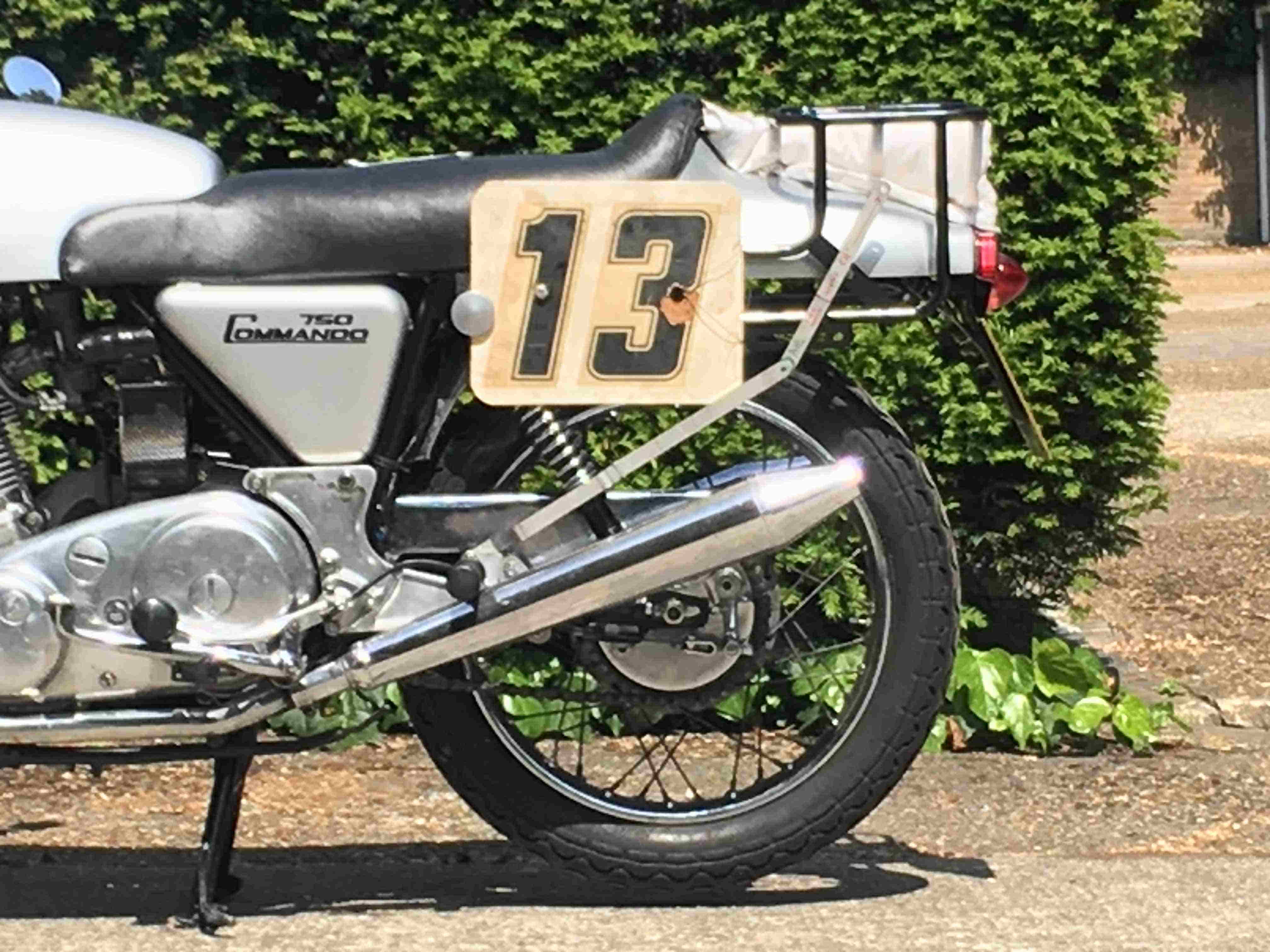

This is what I did.
This is a KG touring carrier from the 80's. Available quite used on ebay. You can mix and match the various mounting kits to fit. I used K-107.
