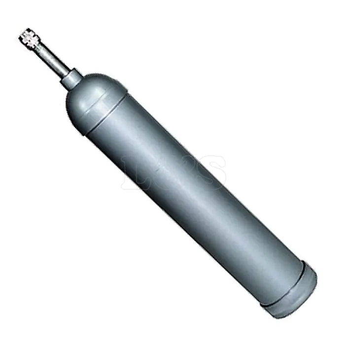

With the gearbox out you can apply grease to the ring and turn the ring so the grease gets pulled in, do this several times. You can also unscrew the grease nipple and with a O ring and oil gun squeeze the grease in. But in the end just get the grease gun but you need one with the right fitting or put some cloth over the nipple and the wrong fitting should still be able to insert some grease. But even though I have the right grease gun I still take the gearbox off and apply grease internally, just don't trust grease guns and nipples to work unless there's somewhere the grease can appear as a tell tale.
... already be greased. If you want to add more you can just prise off the thin metal cover on the inside giving access to the gearing components. Usually the nipples aren't Zerk type but simple ones which accept the old-style pompom type grease gun.grease gun
