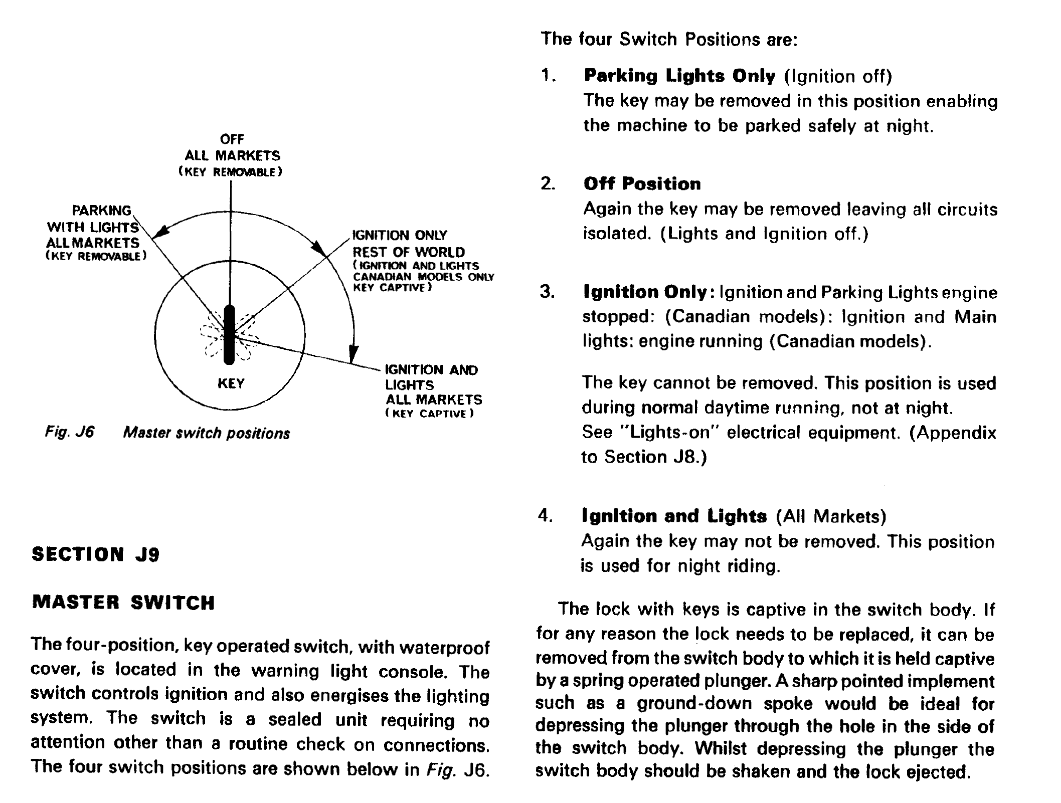

Hello
I bought a Ignition switch two years ago, unfortunalty it was faulty, I should have measured  it before mounting. Pin 4 had even no resitance to the case. So it blew up some fuses.  I replaced it with a newer one.
Please measure the resistance between the pins depending on the switch position, the pins should always have no shortcut to the tumbler-case. In the haynes manual is a sketch with the internal connections depending on the positions.
Marcel
I attached a screenshot from the Norton-Manual, there you can guess internal connections.
See also 850_man.pdf (britmoto.com) Page 163
Update : Valid for all switches except Canadian
Switch position      Connection Pin
1                            1,3                 Parking Lights
2                            2,3                  Off
3                            1,2                  On
4                            1,2,3,4            On with Lights
