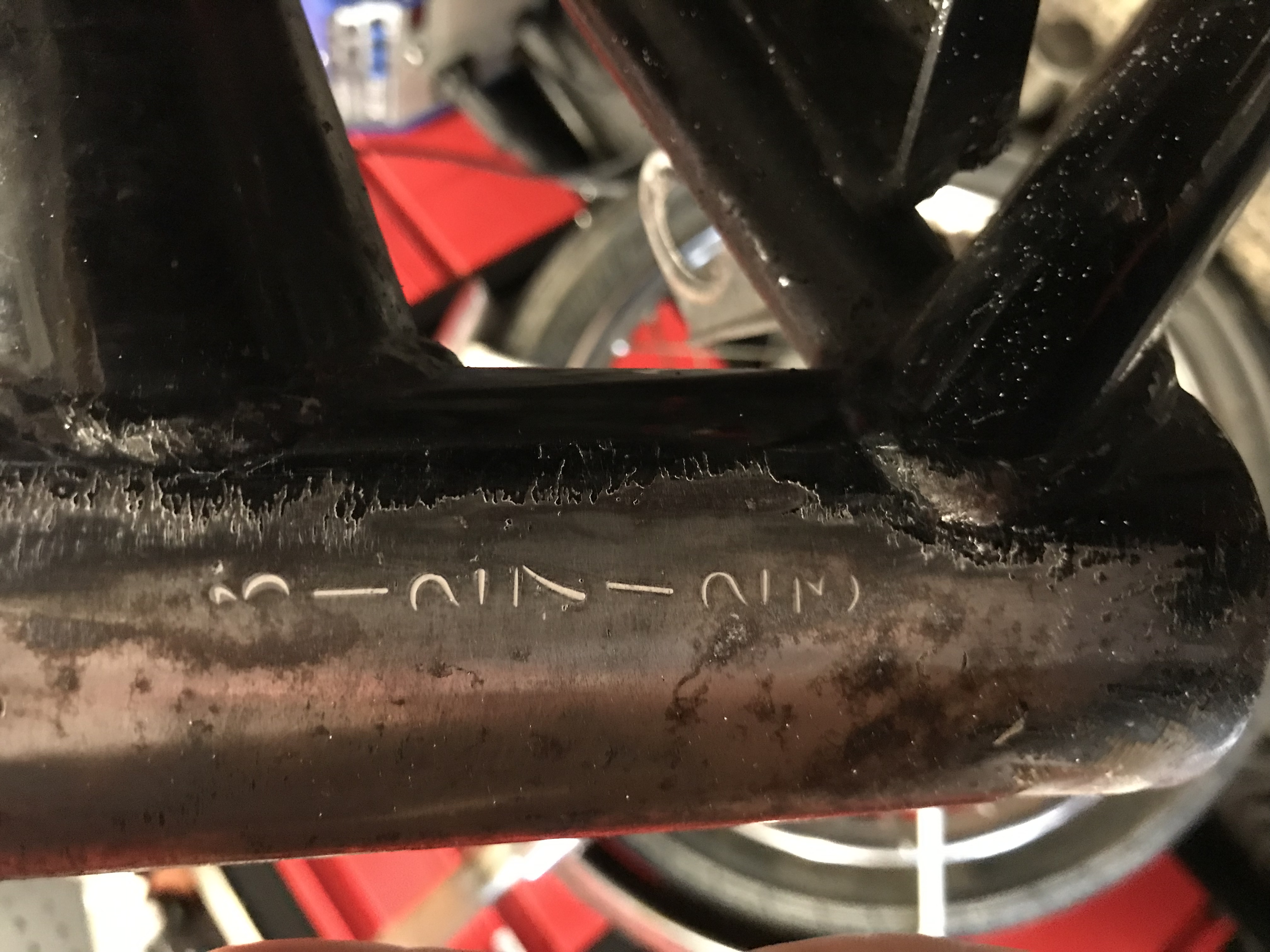

Hi there,
I was wondering if anyone can help me out? I have recently been gifted a Fastback from a family member in Canada and I am just trying to work out the age of the frame.
Any help would be appreciated. Kind regards
RossNumbers found on headstock
Hi Ross ,  according to Roy Bacon in his book Norton twin restoration ,If your frame  number is 321721, it falls between January 1974 (307311)  and february  1975(325001) .   hope this helps .
so I am I reading the number top to bottom or bottom to top? I was told the frame was a 1969.and I was reading the number as 127123. The partial stamp above the 1 looks like a mistake. There is no red tag at all showing any numbers. Its definitely a commando frame. There is no other stamps anywhere on the frame that I can see.
3217123 is not a Norton number ( One too many digits and the stamps look modern format), for the Fastback the number was never stamped directly to the frame but only on the red plate. What is the number on the red plate.

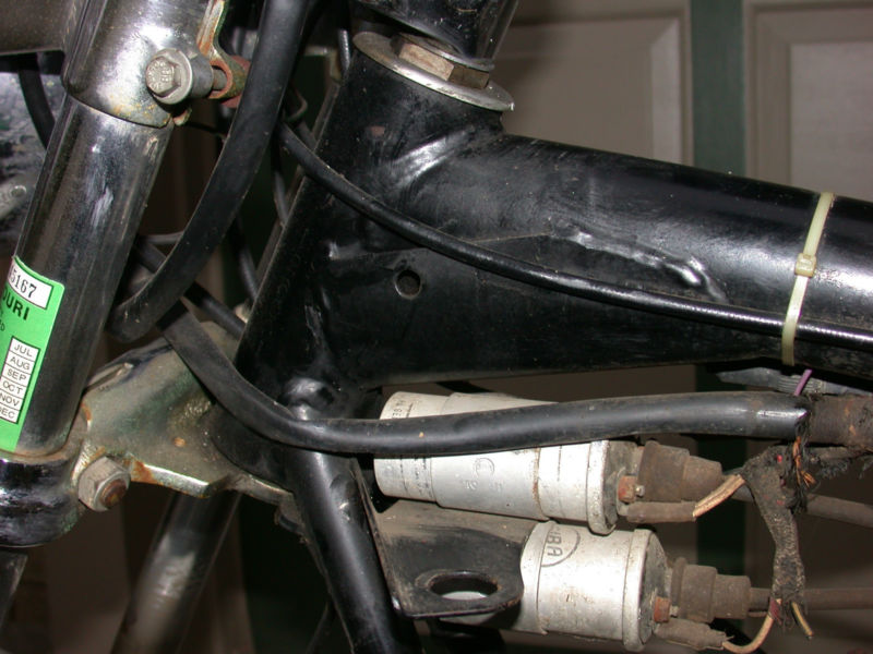

Hi Ross,
Your frame appears to be a replacement, it should have one with a head stock as shown in the
attached picture. A lot of the early original frames where replaced as they broke, detailed in the link
below.
What is your engine and gearbox number? The frame number makes it 1968.
Best wishes,
Terry.
Early frame headstockhttp://www.workingatamc.london/testing_commando_frame.html
In the headstock or on the main tube under the seat… if it’s not a replacement.
J
Later series 1 bikes have two tabs on the headstock to limit front end rotation. I have now verified the earlier frames have a welded on plate such as the last atlas' to restrict rotation ? Evidence is seen on the pix above.

Many thanks for all the replies, I think I am dealing with an early type widow maker frame which has undergone the recall strengthening process. So frame number is 127123.
