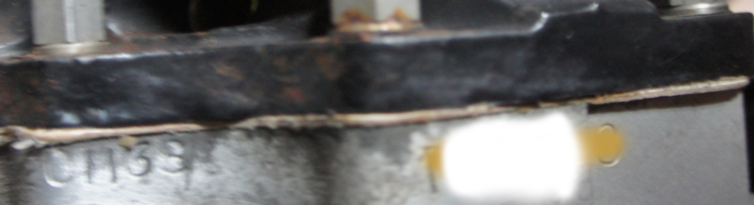

Hi Everyone been offered a 69 fastback
please see bottom posts for new pics
engine number is 1334 XX Other numbers
registered 03/06/69
the position of the number seems a little differentt on a few commandos ive seen seen spotted 8 with the full number on the flat but this girl has the 203ms/ bit on the curve then the rest of the number on the flat, few places did say they moved it around this engine number to the flat part, compared the 1 digits to other 69s an they look the same what does everyone reckon ?
any info would be very much appreciated,
Thanks,
Tom

ignore that got some better pictures and can just about make out th middle of the m is worn down
quick one though on the second half of the engine number the 133 bit where should that be stamped under the barrel on the flat part of the case or on the curve after the 20m3s bit?

My 1970 roadster (imported from the US) has the engine number straight after the 20M3S stamping. (20M3S/1382XX)

Is it just me ? I can see…
Is it just me ? I can see numbers directly after the 20M3S. It looks to me as if the number has been sanded away and a new number stamped on the flank.
There could be any number of reasons for this. It could have been to correct an original mistake or even because the original number was not clear and some licensing authorities insist on legible stamps.
However, most likely in my opinion is that it's had a replacement second-hand engine.
As a riding machine, it makes no difference but it would have a bearing on re-sale values at the top end of the market.
My personal worry is that the authorities or an insurer could become difficult if the worst came to the worst but there are thousands of old bikes with altered numbers and I've never heard of it happening.
My preference is to see original but non-matching numbers rather than an attempt to disguise the origins.

It looks to me as if the l…
It looks to me as if the last digit, just at the end of the curve is a '3' or an '8'.
New cases were supplied unstamped and many 750s have had blow-ups. I can imagine that it was easier to stamp numbers on the flat section rather than the concave curve. Have the cases that you've seen all had camshaft breathers ?
It could just be that someone had the cases too heavily bead blasted and an MOT garage insisted on a readable number. Easiest thing in situ would be to whack it on the end.
Don't forget that these were ride-to work hacks for years, not pampered collector's items !

Restamped numbers applied…
Restamped numbers applied fraudulently but now on the V5 because the authorities are easily duped I would walk away from. Restamped cases due to serivce issues really only affects top end values eg a rare or good example but its only down to buyers and sellers knowledge or if it bother them. As a buyer you use is a a negoitation tool to get it lower in the expectation you will have the same issue on disposal.
Tom, you're quite right o…
Tom, you're quite right on the camshaft breather. Basically the 20M3 and 20M3S engines - prior to 1972. Post 72, there was a raised pad on the side for number stamping.
I endorse for 100% what John says. In terms of value, some people won't care at all, and certainly mismatched numbers on Commandos have little effect, especially if the replaced components are of a preferred type. Probably only a few % of Commando owners are collecting / restoring as historical artifacts.
However, if it ever comes to a an official / Insurers inspection and someone knows how to use their acid kit...and you turn out to have a stolen motor then it's a worry.
Norton Commandos were the most stolen make / model in the UK for several years in the early 1970s. (The RD 250/350 LCs took over the honour). There must inevitably be quite a few still around of dubious origins although of course the current owners are likely to be quite unaware of what sort of thieving b*st*rds hung around Commandos forty years ago. (Some of them were even NOC committee members but that's a very long story....)

bit of an update got a pic…
bit of an update got a pic of the vin number the text is worn a bit by the cables but the frame number is there and the gearbox number is on the gearbox which matches the frame
also got the high res of the engine number after the 20m3s it looks like there may be a 1 after the / but rest looks like factory casting
so guessing its been restamped back in the early 70s or norton screwed up and stamped it further round, noticed a engine a few numbers on from this in the 133 range had all the numbers on the flat part of the case on a few so a little confused now wether it was factory or not
least the gearbox an frame match mind

Hi Tom Just for info, my 6…
Hi Tom
Just for info, my 69 fastback 1334XX has numbers directly after the 20M3S as does the bike used in my Haynes manual. On page 45 picture 32.6c re-fit cranckcase breather you can just make out numbers 133476.
