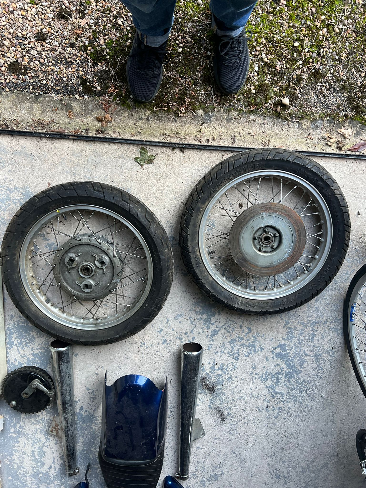

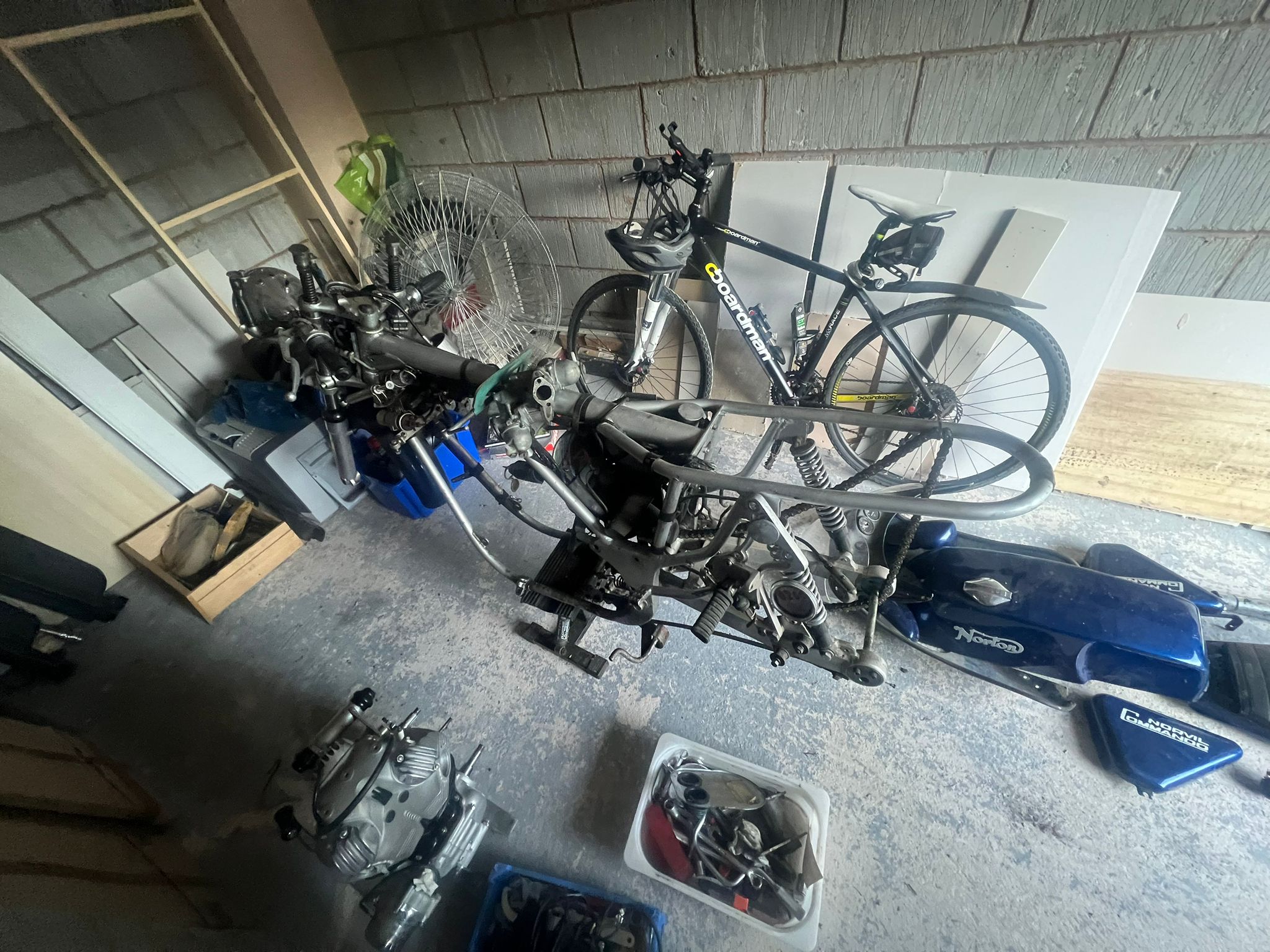

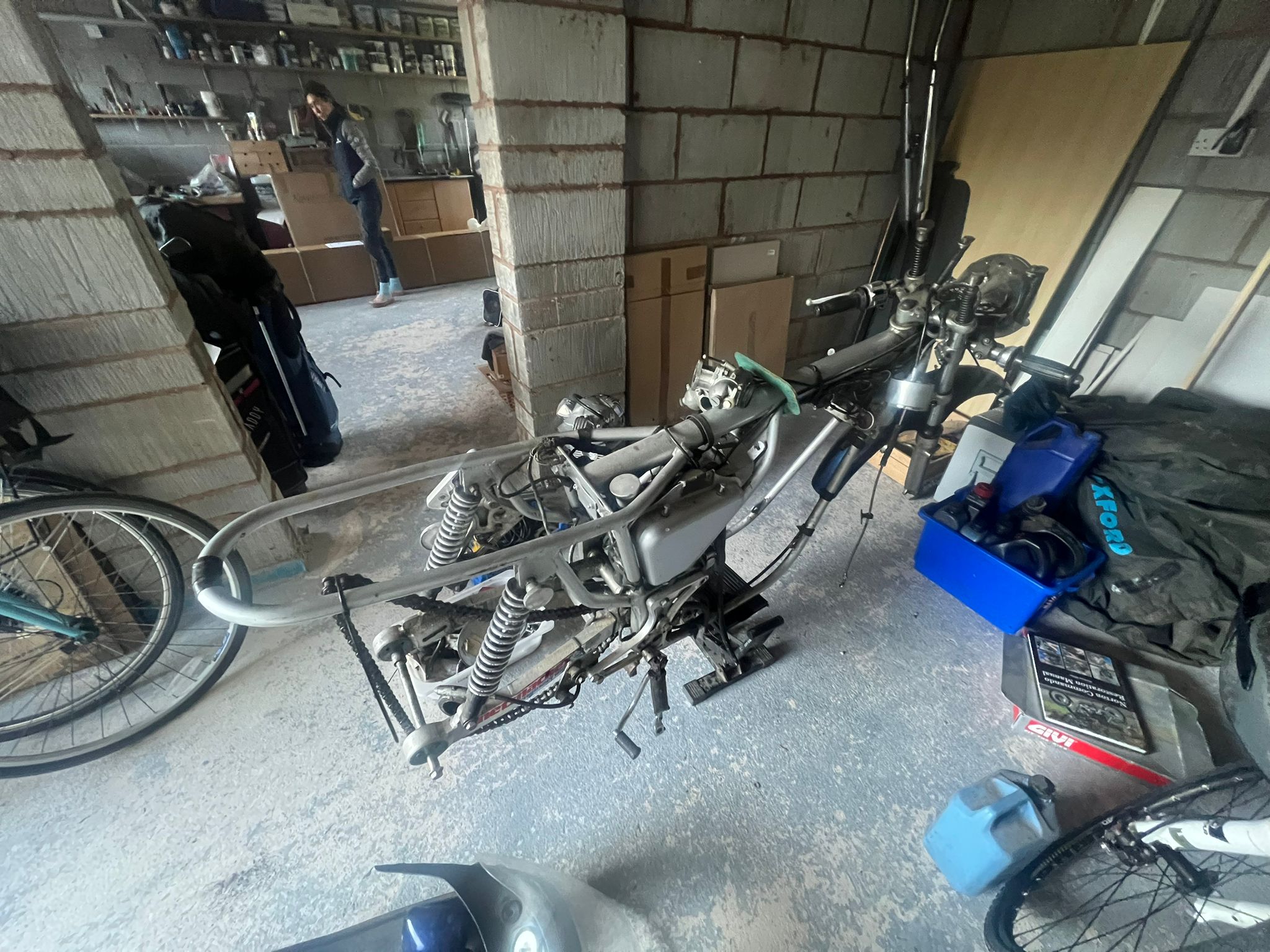

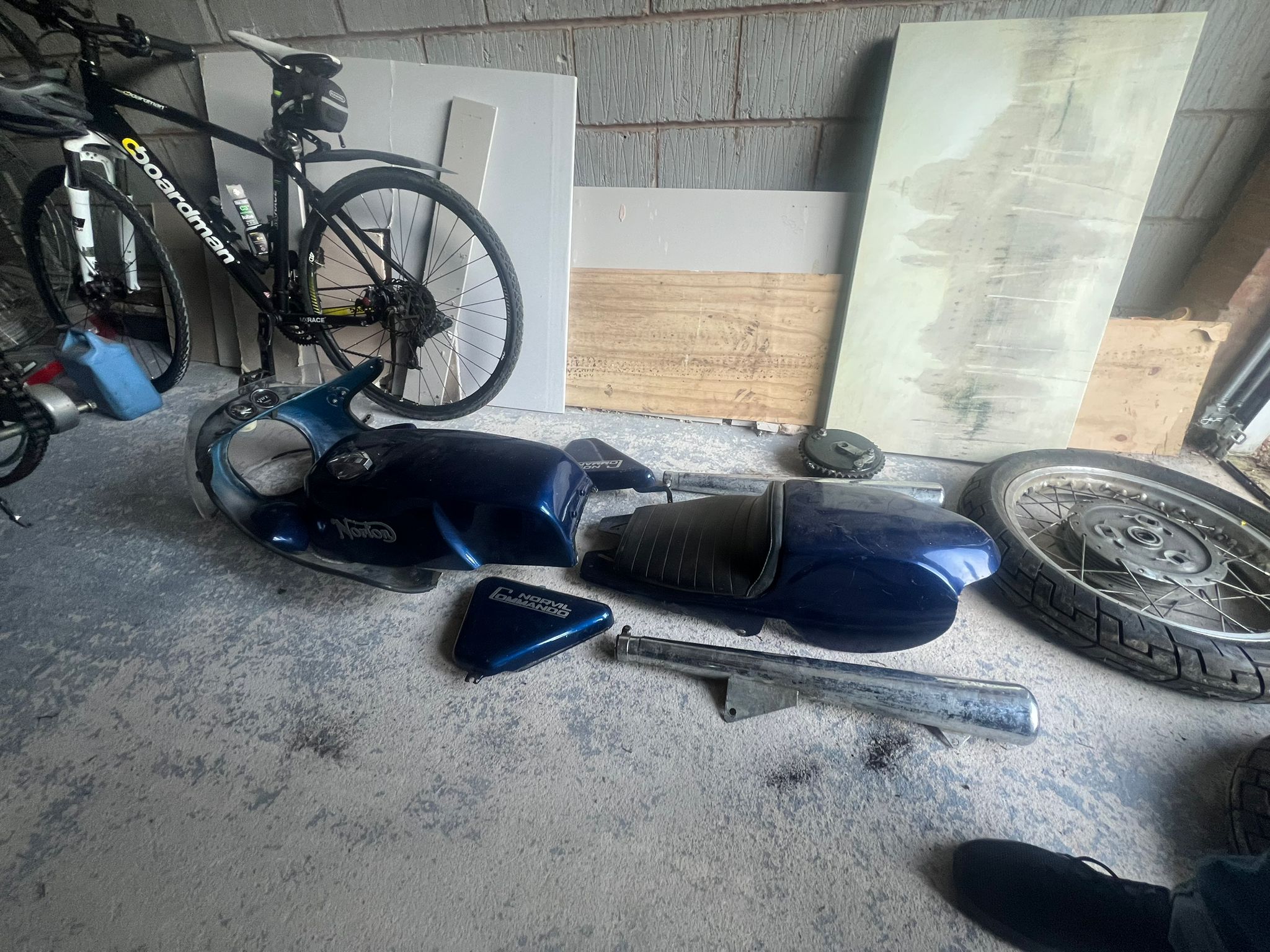

First 4 pictures of the large bits attached, boxes of small bits do exist.
The frame is early, one of the 'ones that broke' and has been seriously messed about - so scrap. The swinging arm is a Metmachex alloy affair that doesn't fit the Isolastics; would devalue a standard bike even if it could be made to fit. Engine looks shiny but it depends what's inside. Ditto gearbox. PR body kit looks too shiny to have been raced but perhaps it was repainted. Wheels are standard with 18" Akront flanged rims, so worth a couple of hundred if they're straight.
At this distance it's a basket case. It'll cost a lot to put together unless you have a spare frame & swinging arm to hand. You have no idea what's inside that engine. Fuel tank is GRP so no use on the road, fairing is non standard. And you don't know whether it's complete.
I'd break it for spares and flog any decent bits off individually. If the grieving widow wants it gone then list as 'spares or repairs' and see what you're bid.
I bought a similar set of parts recently for around £2000.
I will probably spend another £2 to £3k powder coating, chrome plating and some new bits and stainless fasteners. Only planning to make a weekend rider not a show bike. Assuming the engine is ok and you put this one together with similar spend it would, in my opinion, be worth around £5 to £6k in today's market.
