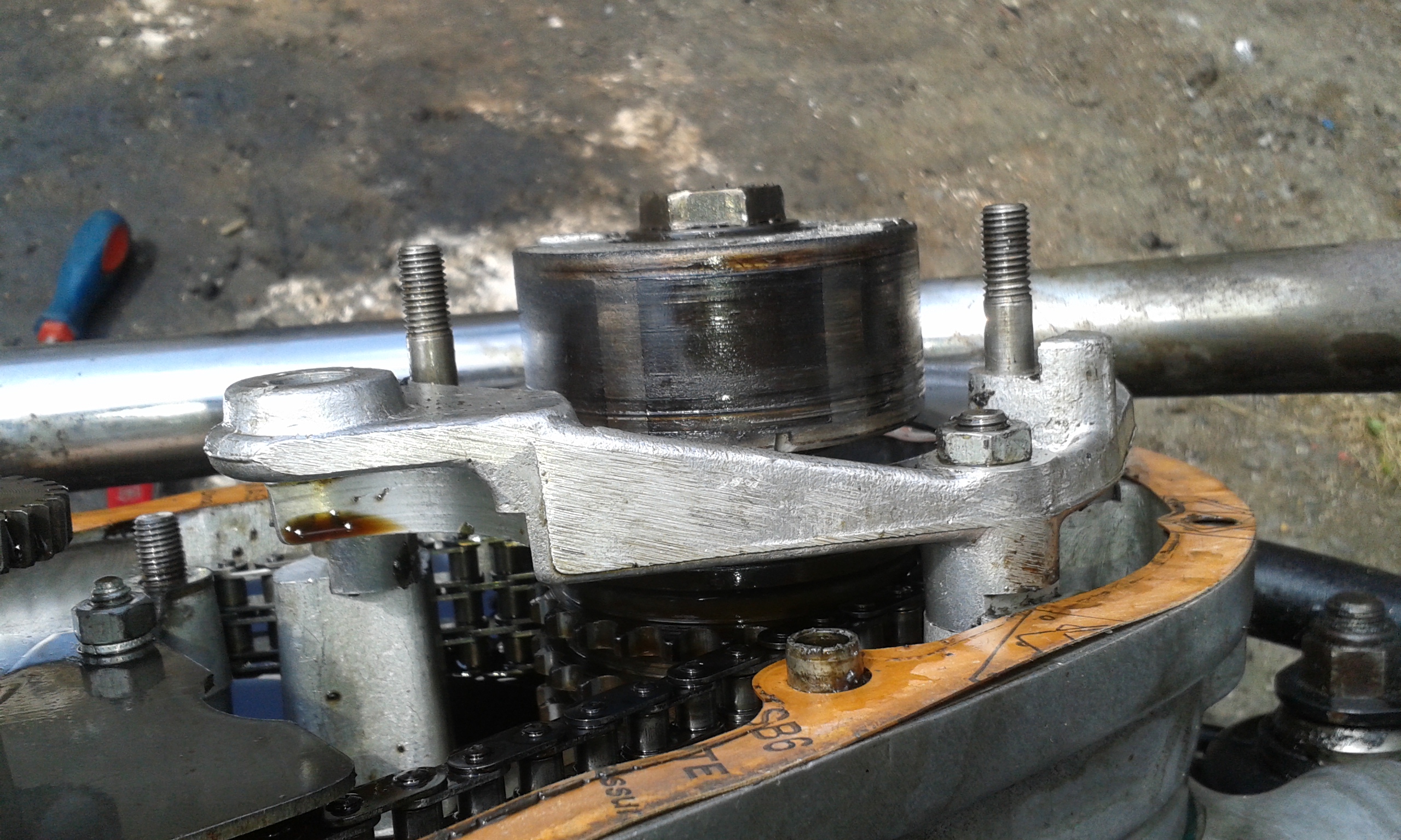

Hi all
spun the stator up in a lathe/ bore size now 75.5 mm so roughly a sixteenth of clearance on the rotor which when new was 74mm. cleaned up the rotor with emery cloth and file
Re-assembled both using plastic drinks bottle cut in a strip and wrapped around rotor to ensure clearance all around. kicked her over a couple of times the plastic shimming didn't move .so even if the rotor was running slightly eccentric I know it won't touch the stator
Fired the bike up 14.45 volts at battery doing 3000rpm, slight dip to 13.8 when switching on headlight returning to 14.45, so I think I got away with it
The only conclusion I can come up with is I may have missed some crap when I changed the stator last year, lodged in the chain maybe getting trapped between stator/rotor and started a snowball effect, because the stuff on the rotor was a plastic residue

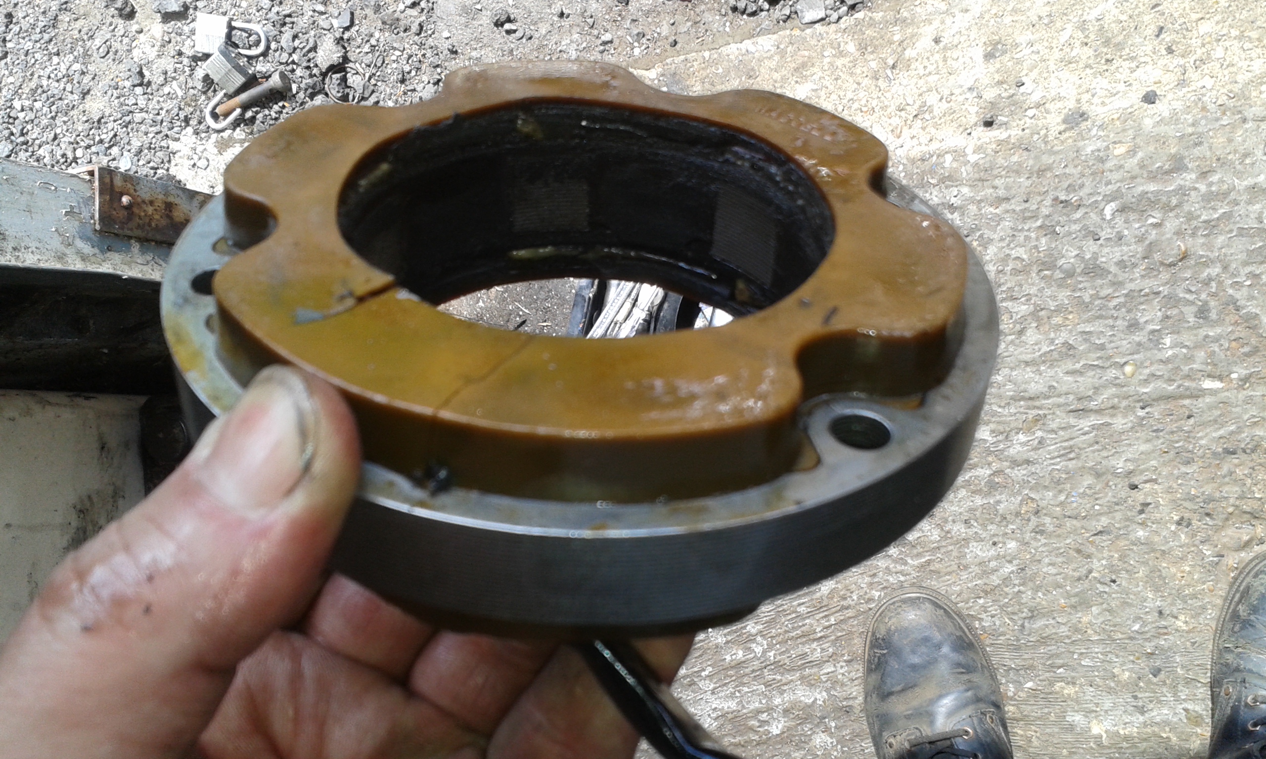

Hi Steve
Just pulled cover off to check my belt drive on my M50 I have found the same problem stator seems to have over heated and melted it was new with the rota about 500 miles ago. Set up with spacers and has no sign of metal to metal contact even had a coat of black plastic on the rota are was full of black plastic the hole thing is destroyed cracker and pieces breaking apart.At first I thought it was the belt breaking up but the belt was unscathed.
Still have no idea what has caused it to over heat was still showing a charge.
I have seen this on 2 Wassell stators, even with the recommended gap all the way round and with the crank rotated so checks were in several positions the stators still overheated in one spot. As Wassell now own the rights to use Lucas and so all the latest ones in Green Lucas boxes are Wassell (does anyone know any different ?) the only alternator you can rely on is a pattern part made by LAP in England on the original Lucas tooling. A very perverse result, the branded product is a pattern part and the unbranded is made on the original tooling.
The LAP version can be found hidden away saying non Lucas but made in England. Cost is £5 to £10 more than the Wassell/Lucas version.
