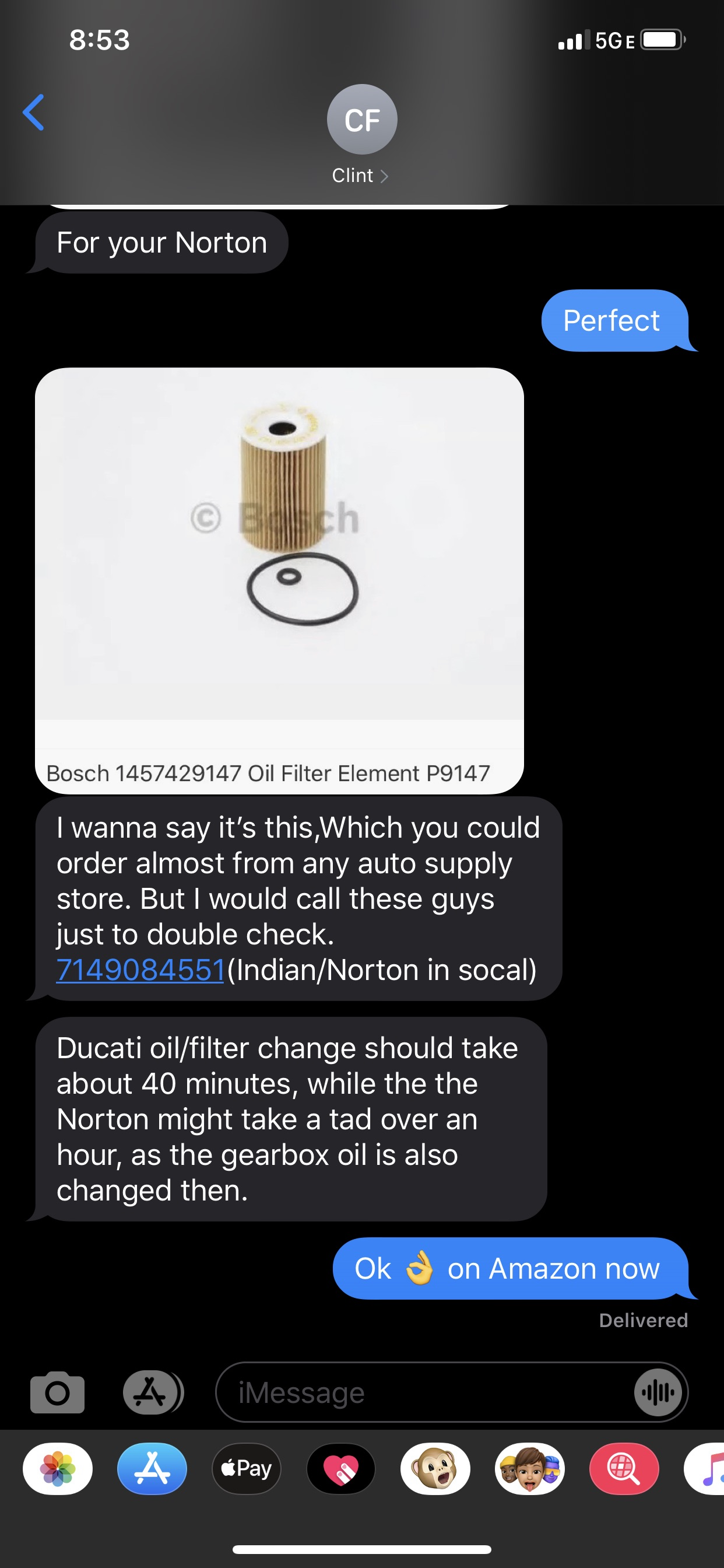

Im new to the site and no doubt other owners have experienced the same spares problems with the Donington Nortons but Im in need of a replacement oil filter. I have heard that a Bosch car one fits. Help.

Bosch Filter
Hi Kevin,
Here`s the number i just got from my Dad anyway:
BOSCH P9147
Kind regards,
Ian
961 oil filter
Good afternoon oil filter 961 is a Bosch P9147 you can buy on line or phone krazy horse and do a fram oil filter which will fit

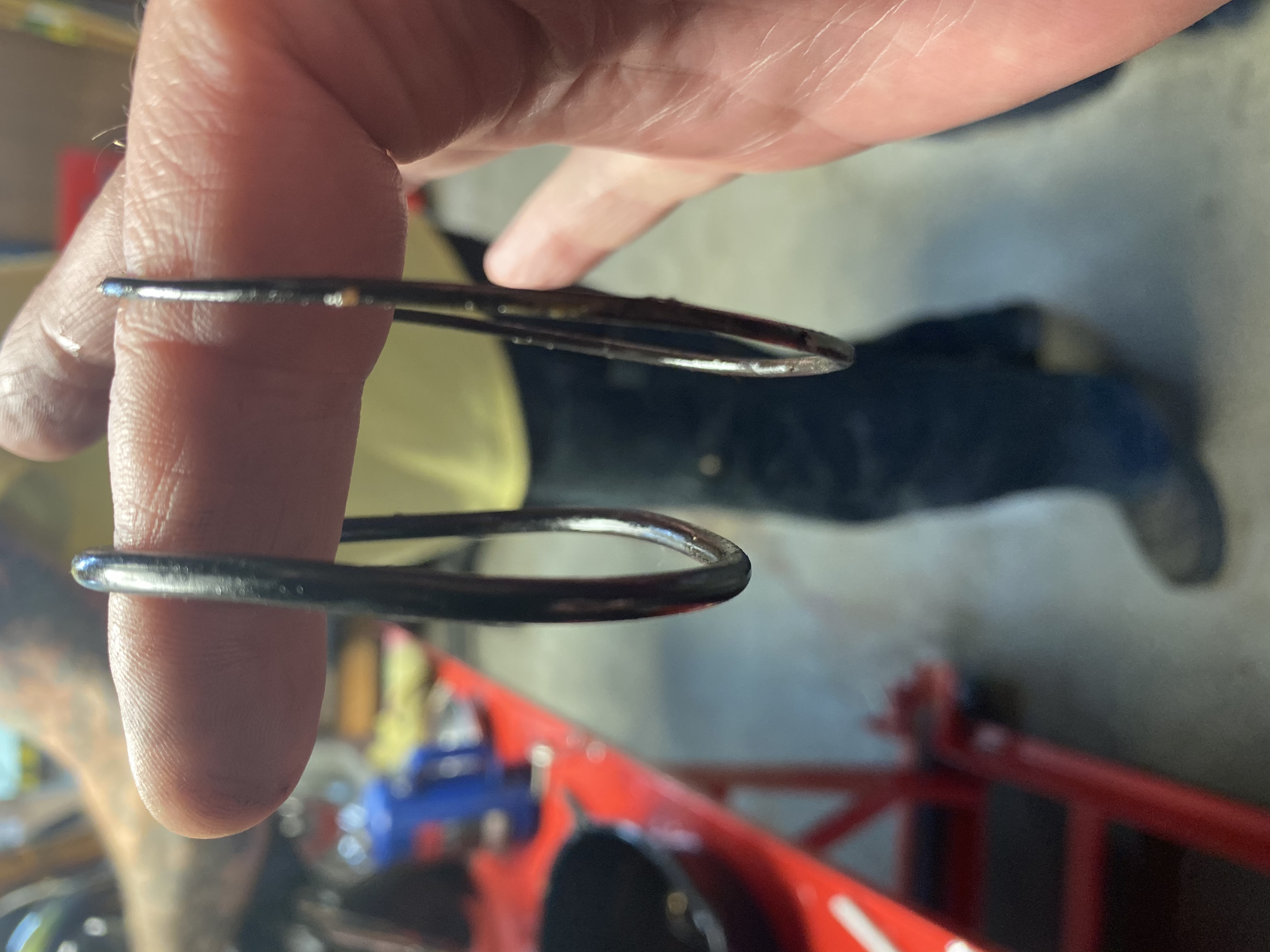

rings that came with Bosch filter are too thick I would make sure you have right rings for plug as well as oil cap on side picture shows ring thicker was one that came w Bosch filter
