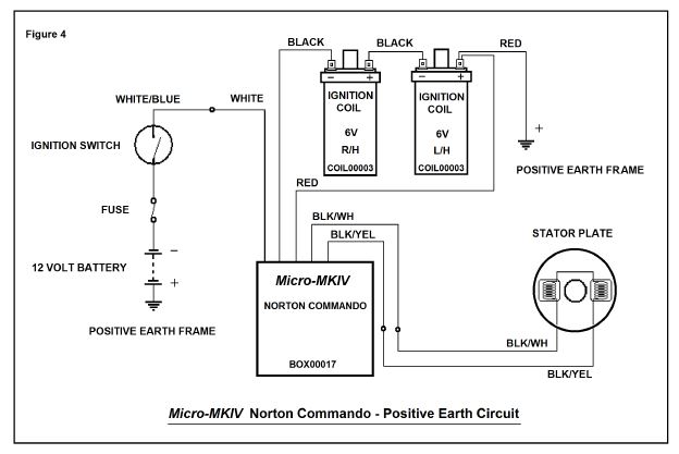

 3. Dont forget it is negative earth. Double check the coils have the correct positives and negatives. Coils will work if it is wrong but they tend to produce a weaker spark and fade. Probably you are sure of this if you have run an external earth wire but its worth double checking as you dont know what has been done to the bike in the past.

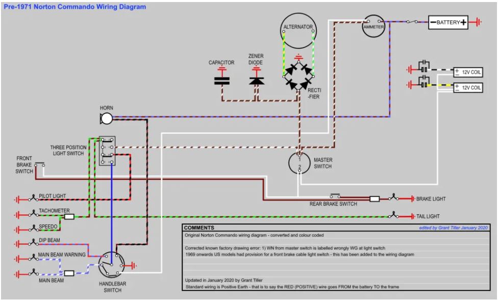

I bought the bike as a non running import from the USA. I junked all the wiring as it had already been butchered and was 50 years old. Wiring is fairly basic as per attached wiring diagram, Boyer wired in as per their diagram. No blown fuses to report and earthed to frame/headlight/engine at several points
One thing I did find a bit odd was that the ammeter flicks to the discharge side when ignition switched on as you would expect, but after a couple of seconds goes back to zero. The only other bike I ever had with an ammeter was an AJS 16MS and that stayed over in the minus side until it got going (or the 6v battery went flat) but that had a magneto setup. Is this normal behaviour, just the coils taking a charge, ready to discharge the initial sparks, or have Mr and Mrs Cockup galloped into town on the wiring front?

If the NGK has an R in the number it has a resistor (or not as the case may be).                              As regards Ammeter behaviour, the Commando is alternator while the AJS was Dynamo, although battery charging is similar as the two systems are different the results on the meter can be different. So in this case the Ammeter results are not anything to worry about. If the lights work well then the battery has enough to get the machine going. Charging the battery is almost incidental.
Sorry Mike. I just noticed I wrote negative earth. Of corse I meant to write "Don't forget its positive earth"  Nobody picked up on it so I suppose my mistake was obvious.
