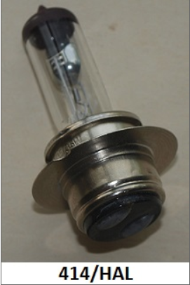

If your bike is running 12V electrics you could try one of the Halogen BPF bulbs instead of swapping reflectors.
NOC Shop has these although showing out of stock. I have one spare. If you want to try it then message me.
BPF Halogen Bulb
I used these for while and found them fine just a bit heavy on power use as they are 60W/55W so the charge warning light came on occasionally riding in town and at low revs.

What I am running is a standard dynamo set-up with Lucas CVC unit.  It's still 6V, with two Cyclons in parallel.  The headlamp is a period Lucas BPF with a halogen bulb from Paul Goff (he sells BPF halogen bulbs in 6V and 12V).  It's a little better than a tungsten bulb, but not much.
