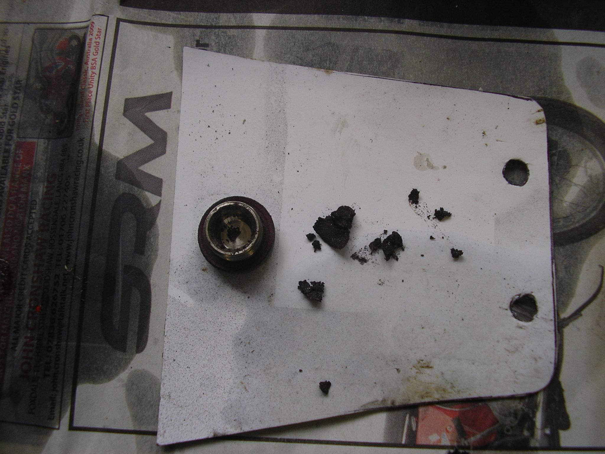

I purchased a new Aluminium 930 Concentric 18 months ago. When new it was brilliant but from a cold start needed a minute with some choke before my 650 Norton would pull away. Now I just need some choke when starting from cold and I can ride off almost immediately.
The problem I have is the drain plug in the carb bowl keep filling up with black silt every 1000 miles. This then blocks the main jet and also gets into the pilot jet. Three times now this has led to the engine cutting out and not running again until some cleaning has taken place.

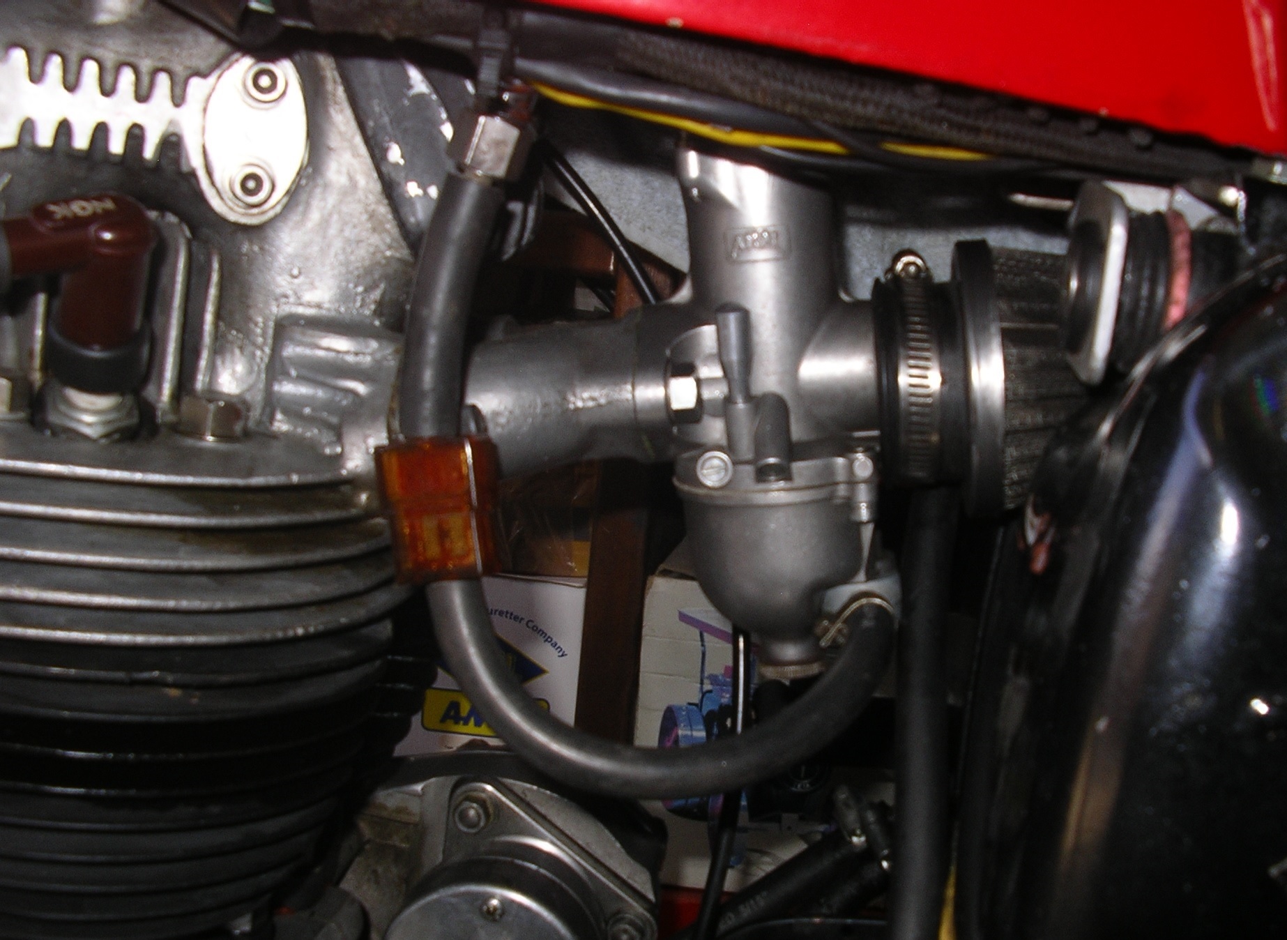

I have three filters in the fuel line. The fuel tank tap, the carb feed and a third one inline between the other two. Where is this jet blocking rubbish coming from?
Thats curious Phil,  Have you got some black rubber fuel tubing thats disintegrating?. or an old cap seal to the tank?. Can't say i have ever seen the like on a bike. Do you tend to buy your fuel from the same place?  perhaps they have an issue where someone has used some black silicone to seal something , I once tried to seal a car tank gauge sender with silcone,  What a mess !!. Still learning.

Roberts suggestion on rubber fuel lines seems likely. Another possibility is the inline filter. I have read reports on filters unable to catch very fine particles. A more efficient filter might be the answer.
 My new Premier carb has a 3 ring Pilot jet. Setting the idle speed is difficult unless the engine is hot. The fuel line set-up has Ethanol proof tubing which is about 4 years old. The centre filter never gets anything like the drain plug fills up with.  See photos.
This version of the Premier 930 has a Pilot jet that can be removed from the outside. If the Pilot Screw is also taken out then a squirt of WD or similar will do a quick clean job.
