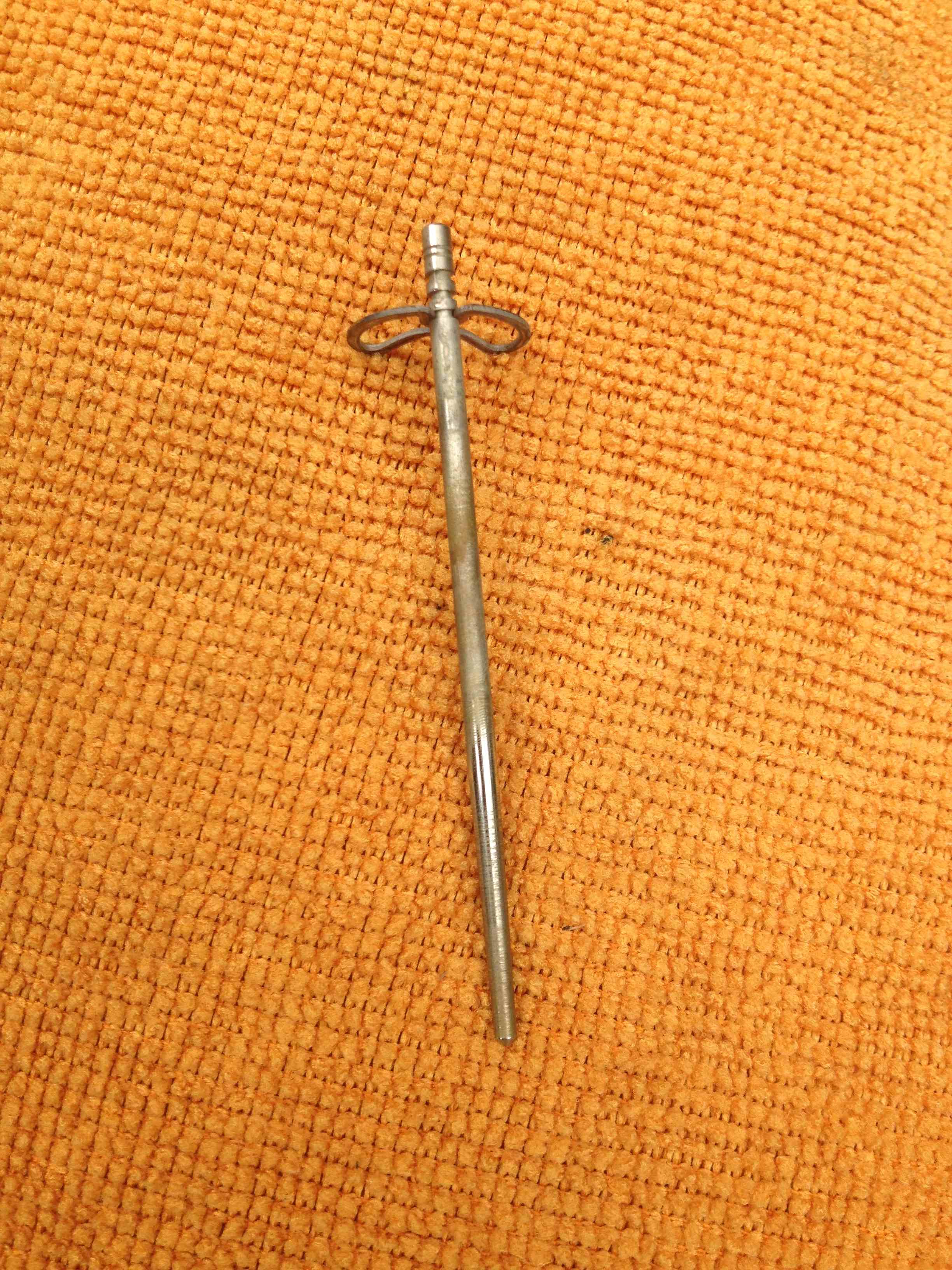

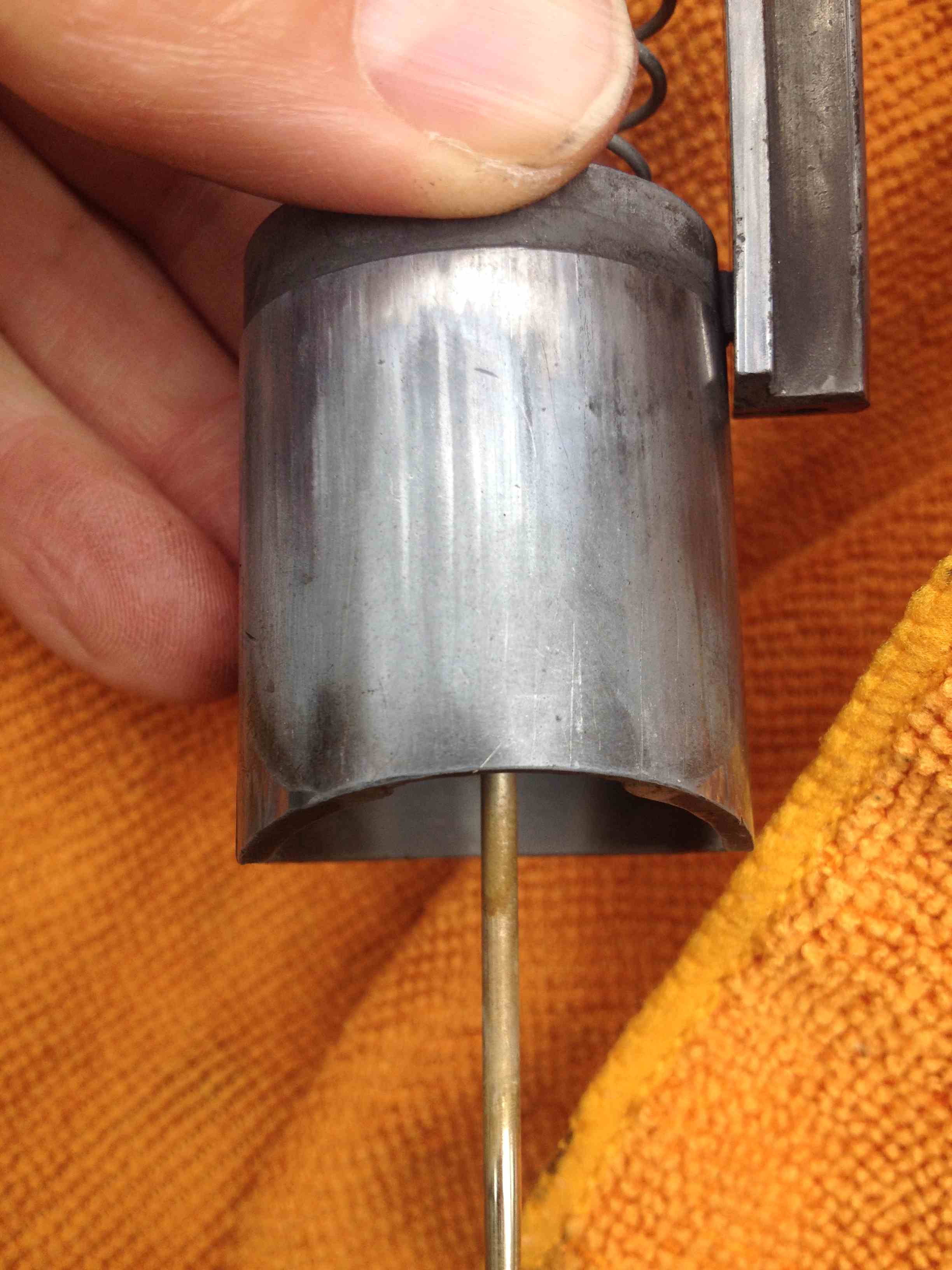

Needles certainly do wear
The ones in place when I first acquired my Fastback were in a terrible state — see my earlier post in this thread, and the pictures attached.
If the slides are badly worn…
If the slides are badly worn then they put pressure on the needle in the jet ,then you get accelerated wear on both.If using a slightly worn slide (or body ) a smear of molibdimen sulphide grease on the slide is helpfull in reducing clearance and wear. It will affect the mixture slightly.
