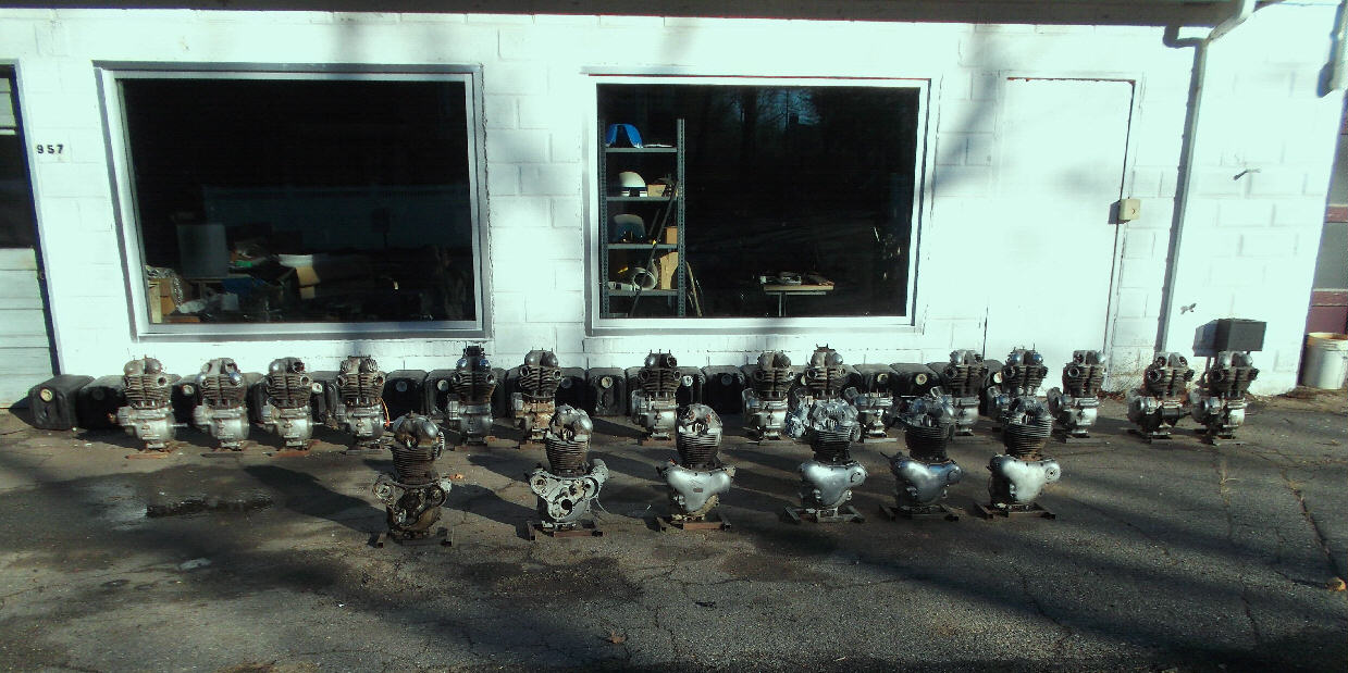

As shown below the current sample of my research subjects. It is every major version of norton engine except hybrids and an alternator 14 (99). The 25 engines currently sit on several display tables behind me in my office. In addition I own 14 various commando, 4 slimline and 2 gardengate/model 7 (1 Dunstall atlas +1 71 Dunstall commando)
The advice givers will sometime show their complete lack of knowledge. It some time frustrates contributors who will then be denigrated and finally be driven away. I have departed a number of internet norton forums and will now be on one less.
12D 122D 122A 14D (no14A) 650 all domi in front line
20M1 20M2 20M3 20M3S 200000 300000 325000 in rear
