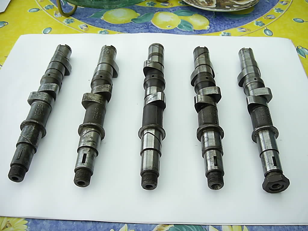

Peter:
Can you state left to right what we are looking at?
Mik
I can not remember which is what  Mike. The photo was taken too long ago.  I would guess that the one with no number is the Dunstall and that with the pointy cam profile is probably out of a Model 7. Perhaps one of our wiser Dominator Engine contributors can ID them? Where's Anna when you need her?
