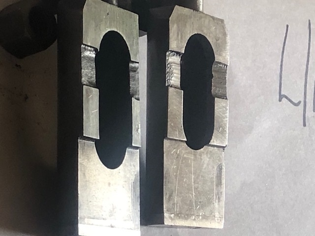

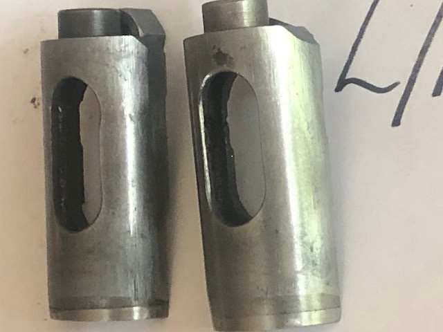

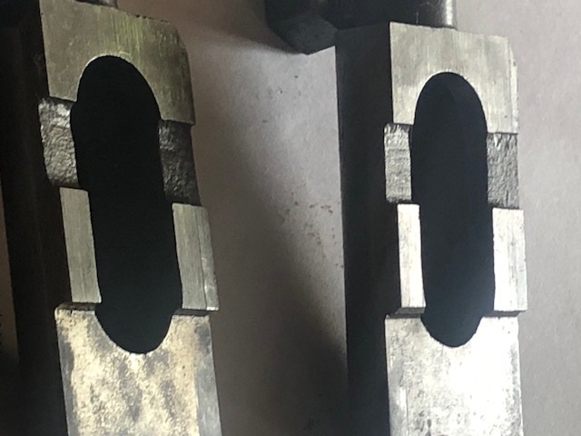

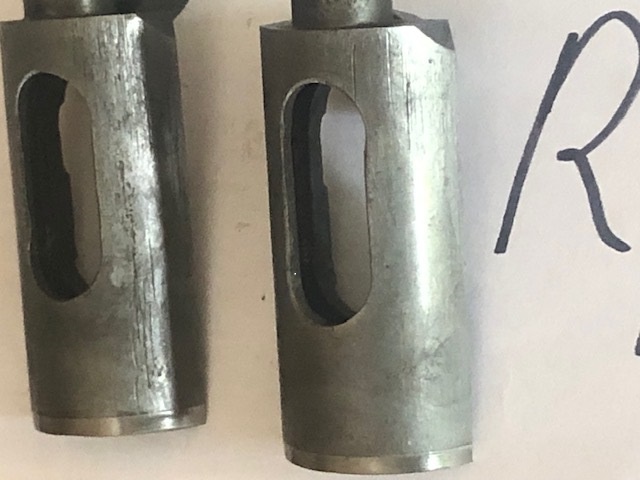

I wouldn't know what would be acceptable on the flat faces of the followers or indeed the diameters. I'll be fitting a new cam so the stallite needs touching up but it looks like the L/H side's finish on the diameters don't look too bad they aren't a matched pair - one of them hasn't a chamfer along it's length. The R/H pair - the ouside diameter is quite badly scored and the chamfers aren't handed so that one would be to the front and the other to the back!!
The follower's bores in the barrel feel horrible.

The odd collection of tappets above are not shot and could be recovered, the damage they show is from debris, either glass bead or chill cast shot, from above the tappet which scores the tappet as it works past the tappet body. The chamfers to the rear may well have prevented them looking a lot worse. No matter whose or tappets you fit, if the engine is not clean neither system will last long, and the engine they were taken from needs stripping and cleaning.
If you need to get parts vapour blast or shot blast, clean the parts and when you think they are clean then clean them again. Personally I would get them soda blasted and if the facility says it is the same as vapour blast then walk away.

They don't look too good.
Firstly, the followers (as far as I know) are made as matched pairs, so you could be looking at an expensive rebuild here. Are the follower bores OK?
The chamfer should be at the front so that oil returning from the head can fall onto the camshaft, and hopefully find its way between cam and followers.
As for the satellite pads, they can be ground flat again, but you/the machine shop need to grind them in the direction of cam travel ie. from the chamfer.
Good luck, and hopefully not too many more horrors awaiting you.
