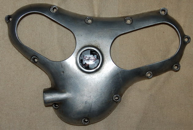

Contact someone from your nearest Norton Owners Club section and borrow a Domi cutaway timing cover. You'll need one to avoid damaging the inner location for the intermediate timing gear spindle, both when slackening & tightening the camshaft & magneto sprocket nuts, also whenadjusting the chains.
