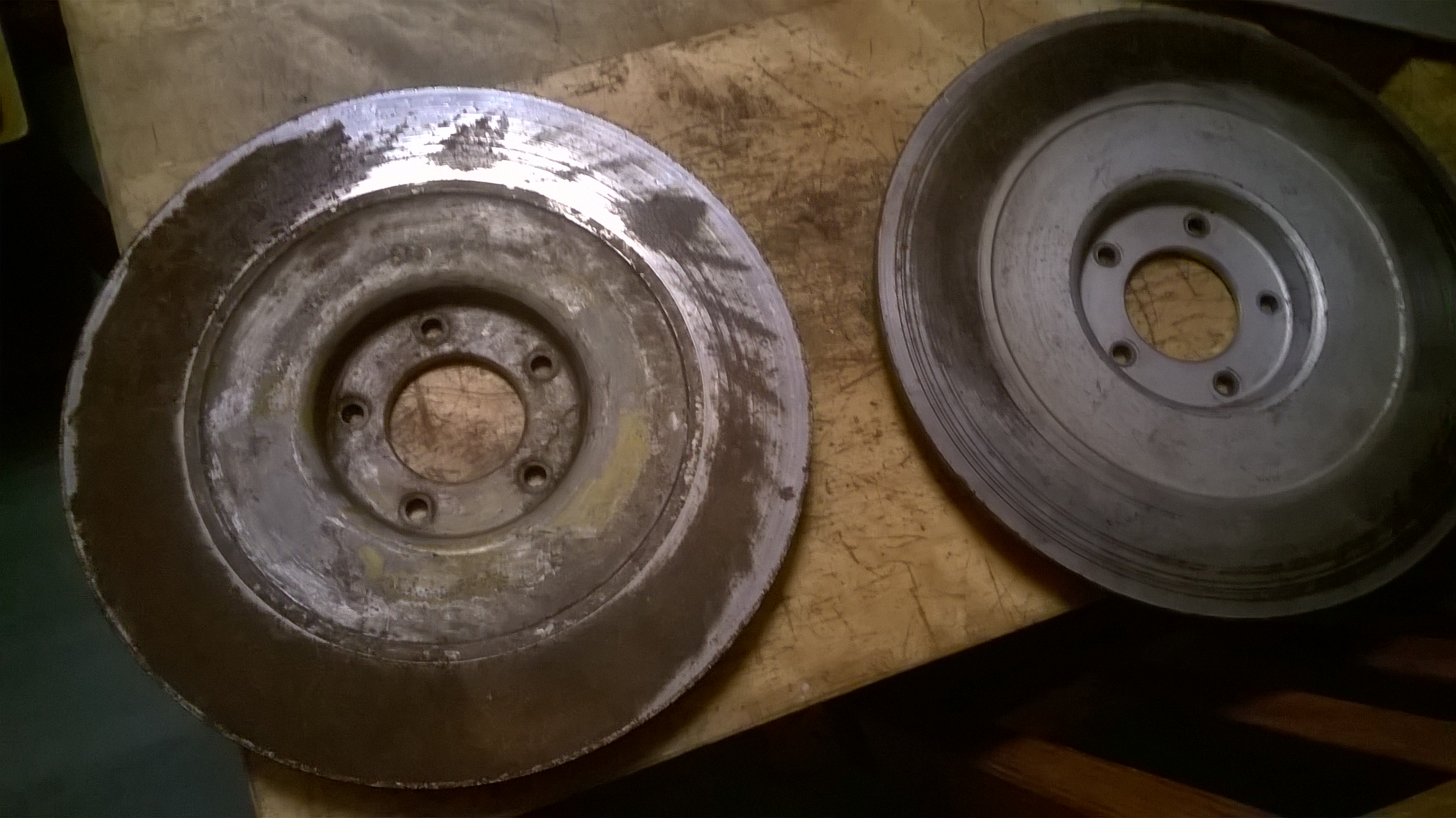

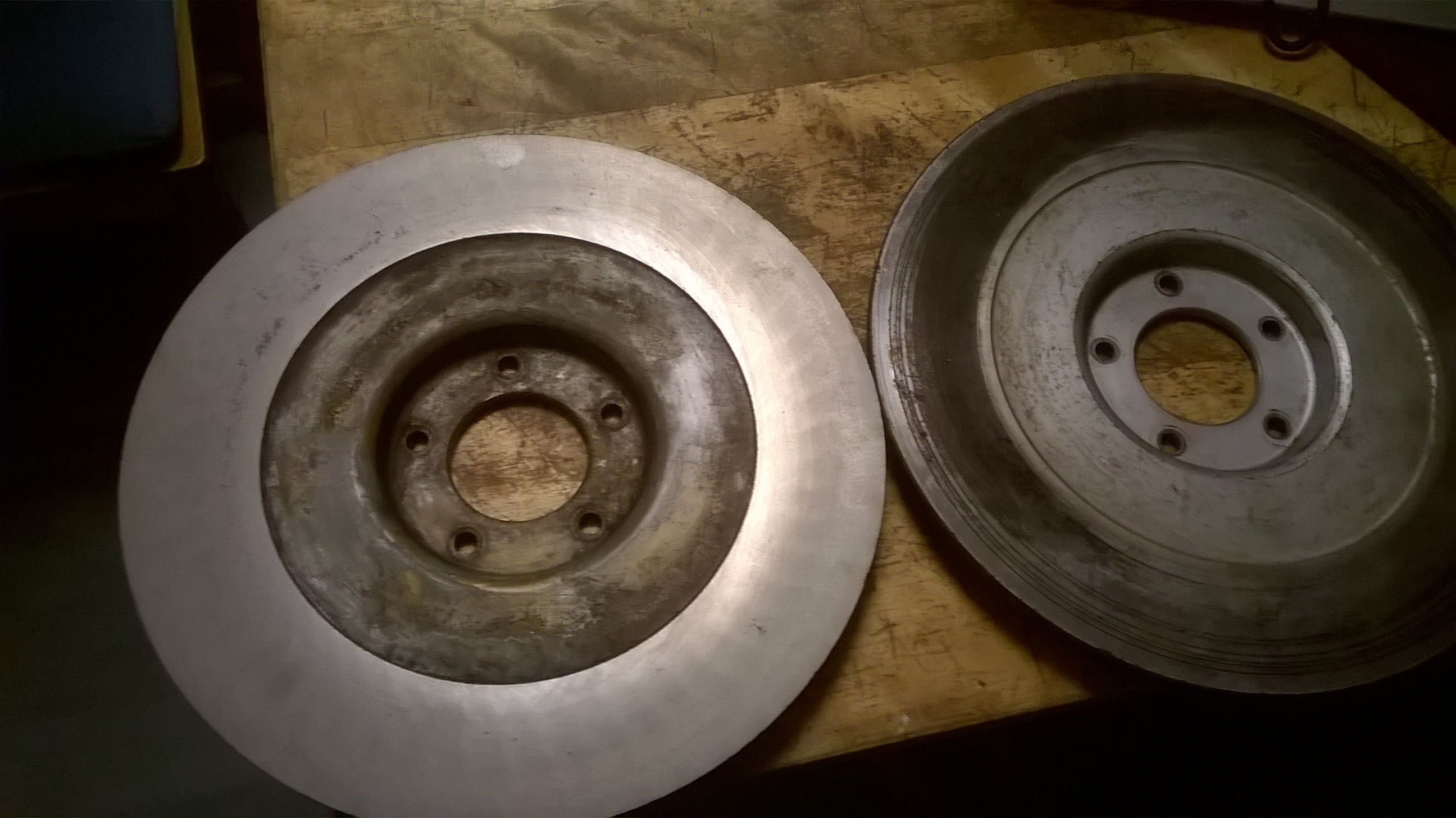

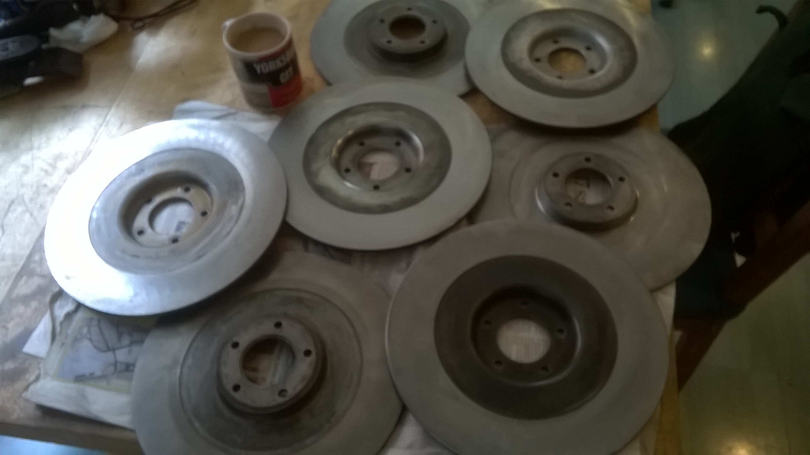

Thought i post some photos of the brake discs i have just refaced over the last few days. This all came about as i had a T160 disc to grind up for a client, and while the machine was set up to do disc grinding i thought i would go through the pile of worn and scabby looking discs that have accumulated.

Peter, how accurate is the thickness on those resurfaced discs please?

Disc thickness is the same…
Disc thickness is the same all the way round. Both sides of the disc are ground at the same setting without removing the disc from the machine, so ensuring the disc is true.

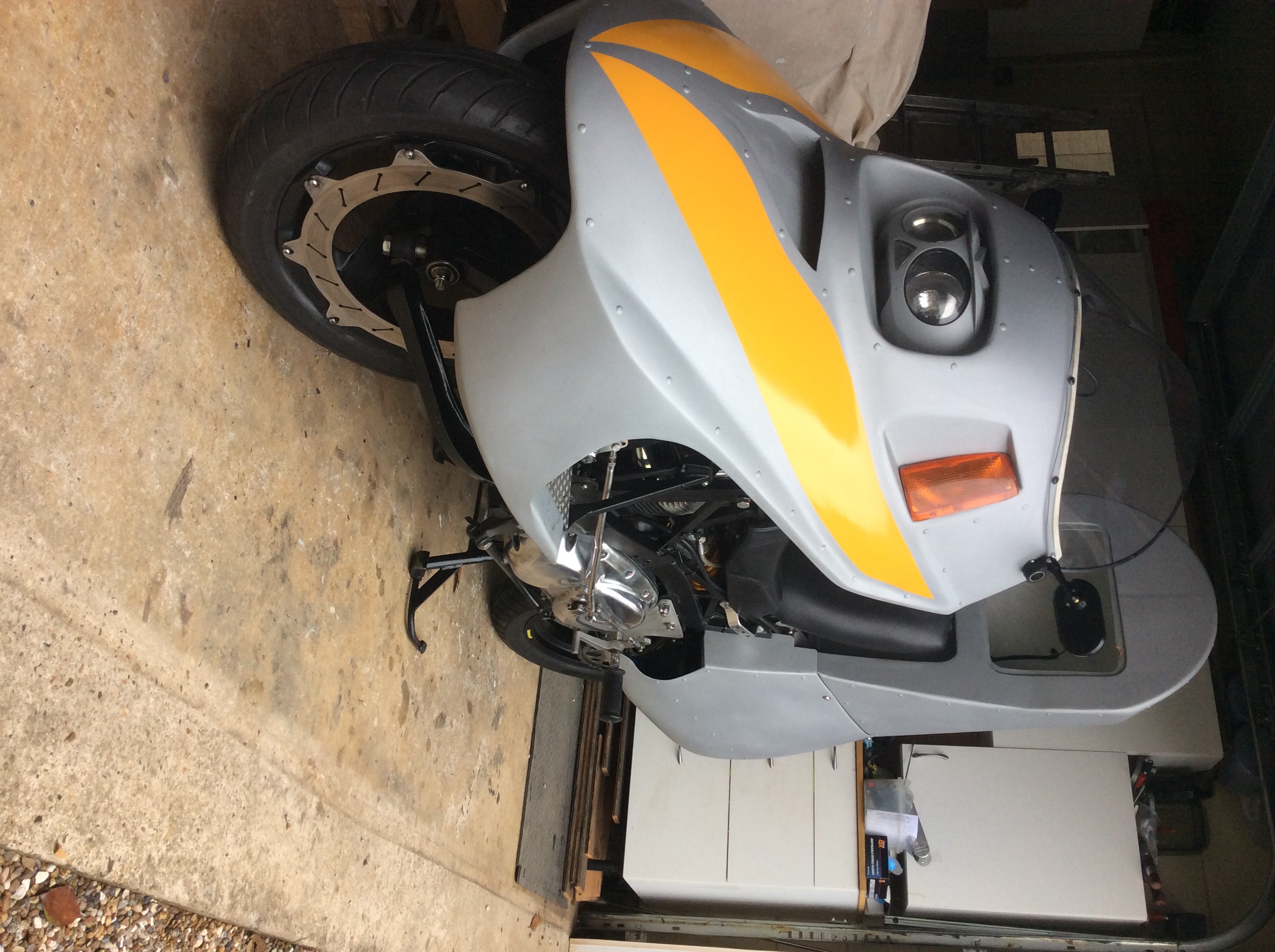

the bike was finished in 2016 and ridden to the Dordogne and again in 2018 , for a feet forward rally of like minded types. This time, we are meeting in southern Cherbourg peninsula. Planning to go to the Dead Man’s Corner museum and maybe others this time.Bike is satin silver.
Special
That looks amazing, different from the QL I've seen in photos. Crying out for Norton stickers! Would be quite an experience jumping from a Mk3 into that, same sound, entirely different surrounds and feel. The dual gear lever control is for stops I would imagine.
I know a custom bike show promoter who may be interested in that, an interesting alternative to the usual classic style shows. I'm showing my Mk3 for fun, not awards but next month not June...
bike
The only QL/ Q2 parts are the centre hub arms and front wheel/brakes. The frame is home made, using standard isolastics.
The seat back is luggage storage space.
The front fairing is as used on the feet forward Voyager prototype( slightly modified), designed by Royce Creasey.
There are two seating positions: head first and feet first, so there are two gear levers and two brake pedals.
It won a rosette at Ardingly a few years back, and Peter Williams presented it to me… respect!
