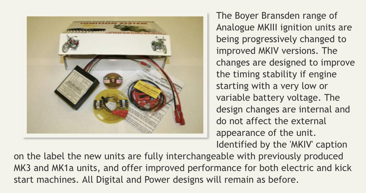

From reading forums, this seems to be a fairly basic fault with the Boyer Mk3 electronic ignition which has been corrected with the Mk4.
Can anyone confirm this, as I'm intending to buy the 'box' upgrade from Boyer?
Confirmed!
Yes, the MKIV is much improved, as detailed on their site - much more friendly now for electric start bikes!
It is not the MKIII at fault, it's just a limitation of the tech/design of a unit that's been around for nearly 40 years.
Don't be tempted to change just the transistor box - change the stator plate too.
