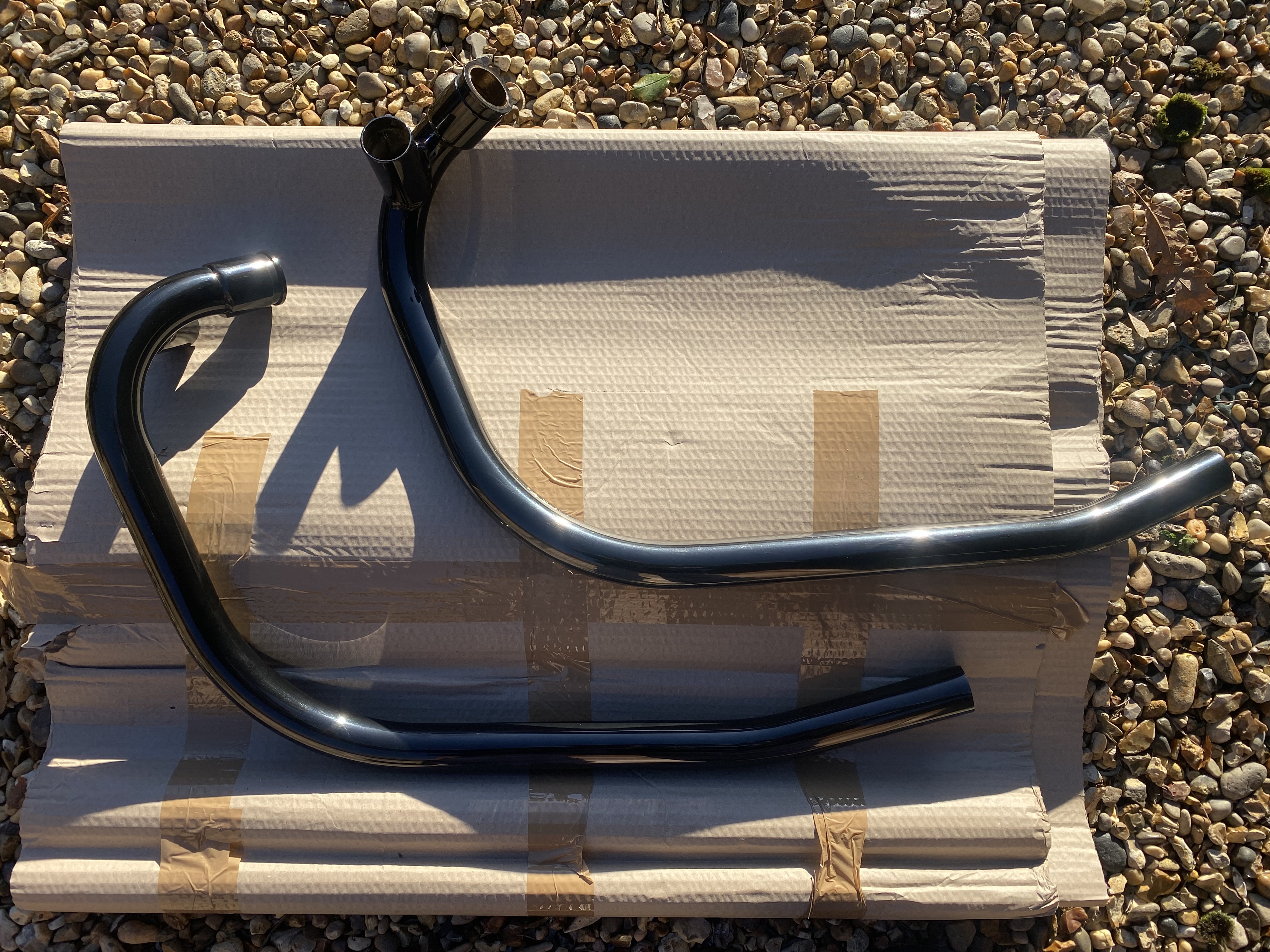

I found a supplier!!!
After lots of ringing around over the holiday period I came across Sam at Broadway Brass, aka Chrome Fix,in Birmingham who said they offered Black Chrome. I sent them a pair of new Mk2a balanced pipes and received the results back today - they did a first class job! They were expensive but their client service was excellent and they turned around the work in under three weeks as promised. The photo really doesn't do them justice.
I will certainly be using them again.
