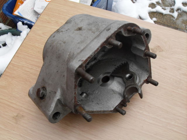

Attachment is a photo of an AMC gearbox shell. This is from a Norton but the drain plug is roughly in the same area on the hybrid's box. On the other side are the camplate shaft end nut andthe selector shaft end nut. Towards the bottom should be the camplate detent spring cover/nut which is generallya larger size than the others.
