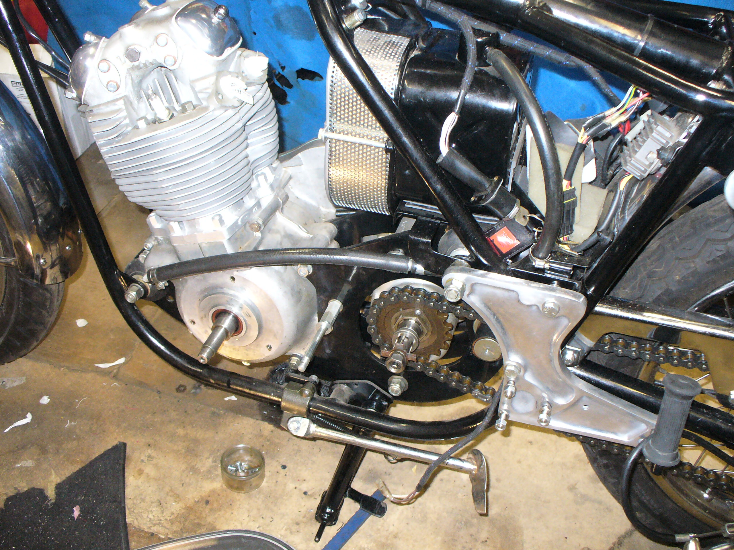

Alternator rotor stuck fast
69 Commando.
Stripping clutch cover side for engine removal.

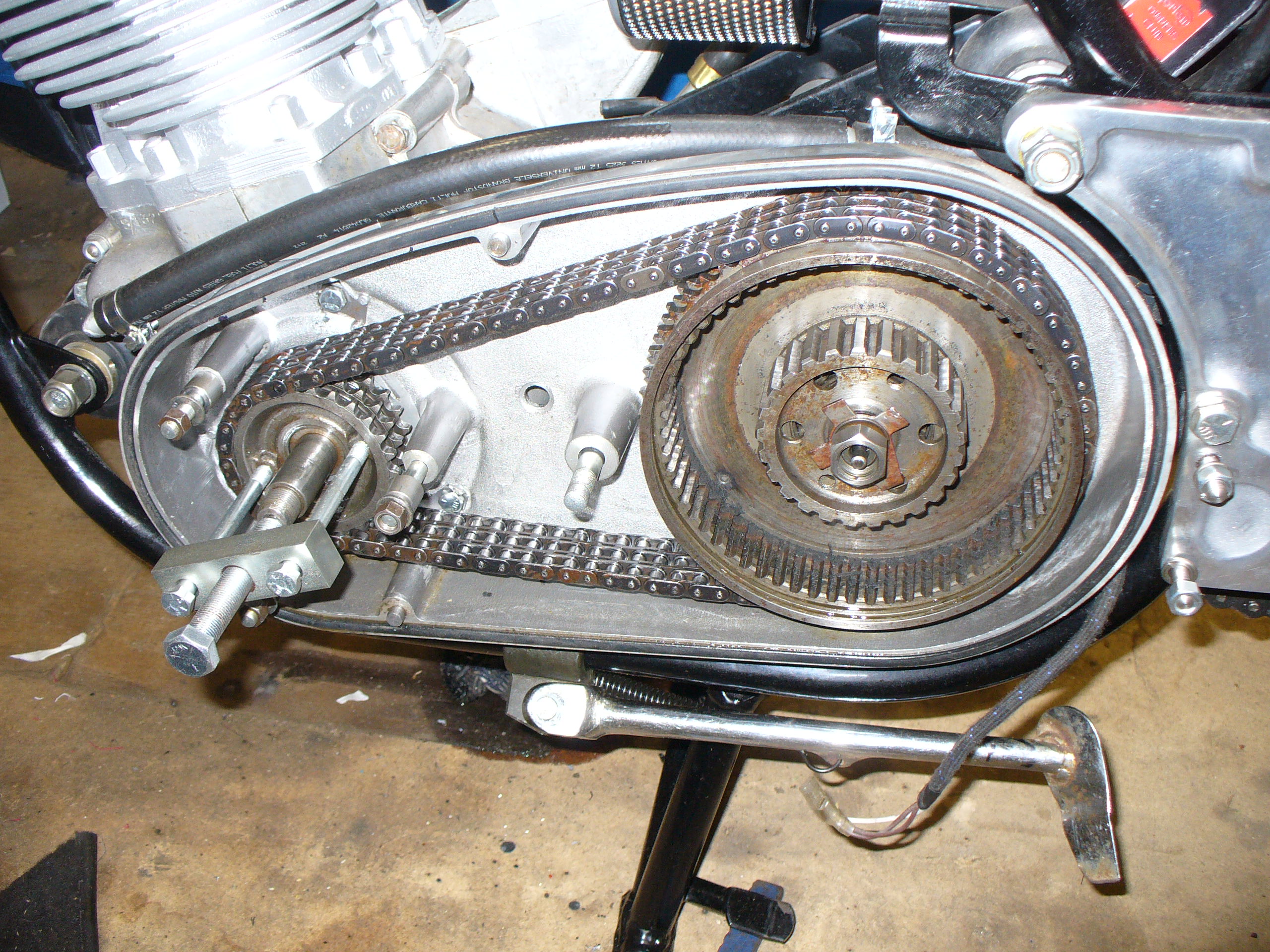

Looks like a replacement alternator rotor. Stuck fast. Tried a small 2 arm puller and two screwdrivers behind it but no luck.
Very little gap between the rotor and the triple sprockets and chain.
Suggestions welcome
Many Thanks
Eddie Cross

Can you get the triplex chain off? Does it have a split link? one of the links at the top near the clutch chain wheel is a different colour, sometimes meaning a split link, the clip might be at the rear of the chain next to the inner case. Use a mirror to check. If no split link try moving the box towards the engine, possibly getting more space by removing the top and bottom g/box bolts, the movement limited by the inner primary case. If you do get the chain off, it will give you more space to get a bigger/better/three leg puller in there. Report back please
Not original rotor and looks like the chaincase was fitted more recently than 1969, so unlikely to be rusted on. Warming rotor to 100C (spit test) ought to give your small puller a fighting chance.

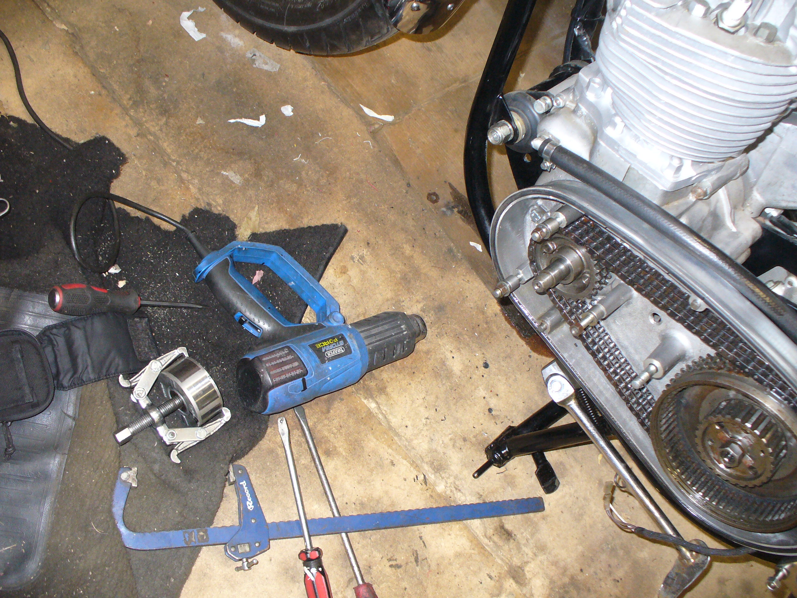

Broke out the heat gun this morning. Hot enough to move it out an 1/8" with two screwdrivers before it jammed again but just enough room to give my puny 2 jaw puller a fighting chance.
Now out. Inner crankshaft sprocket knew the game was up and came off easily with the sprocket puller.
