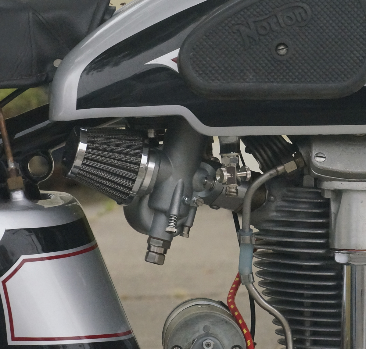

...a Monobloc or Concentric is that it's very easy to fit an air cleaner, in my mind a necessity. I recently started up my '48 Inter for the first time with a new Monobloc and she fired off after a few kicks and runs really well. I prefer the look of the Monobloc to the Concentric and believe it's a superior device in many ways. I poached jetting off someone else here and so far, so good.
389 Amal Monobloc Jetting for International Model 30:
1 5/32"
Main jet 340
Idle jet 30
Needle jet 106
Needle D middle notch
Throttle slide 3
 with Atlas manifold bored to correct size to get carb in same relationship to head.
carb

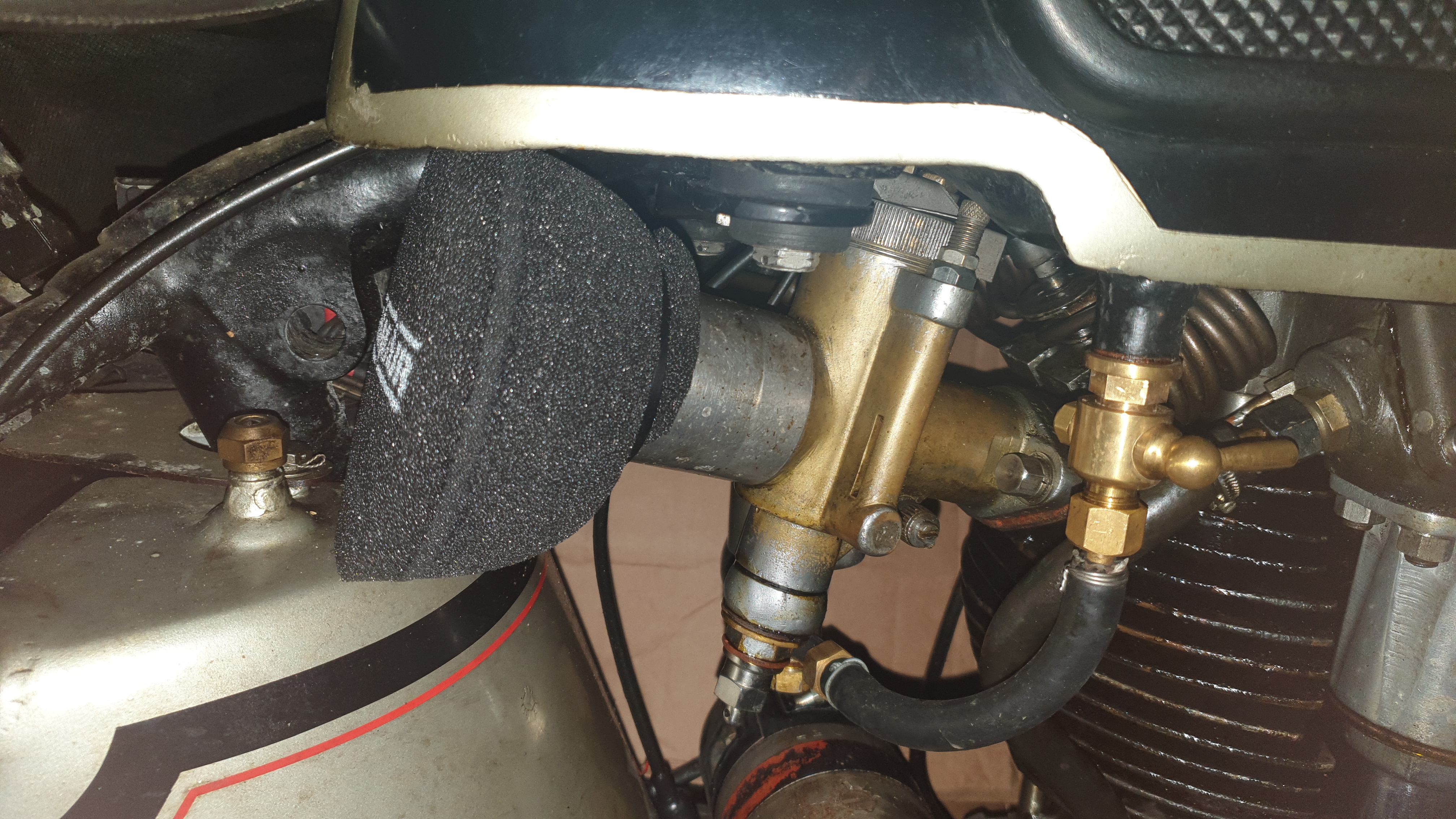

When I acquired my Inter about 18 months ago I had terrible starting problems. Now it seems to have been sorted, mostly by familiarity. The biggest improvements I made to the TT carb were
Careful adjustment of the pilot screw. It's a turn or more further out now to increase fuel on pick up

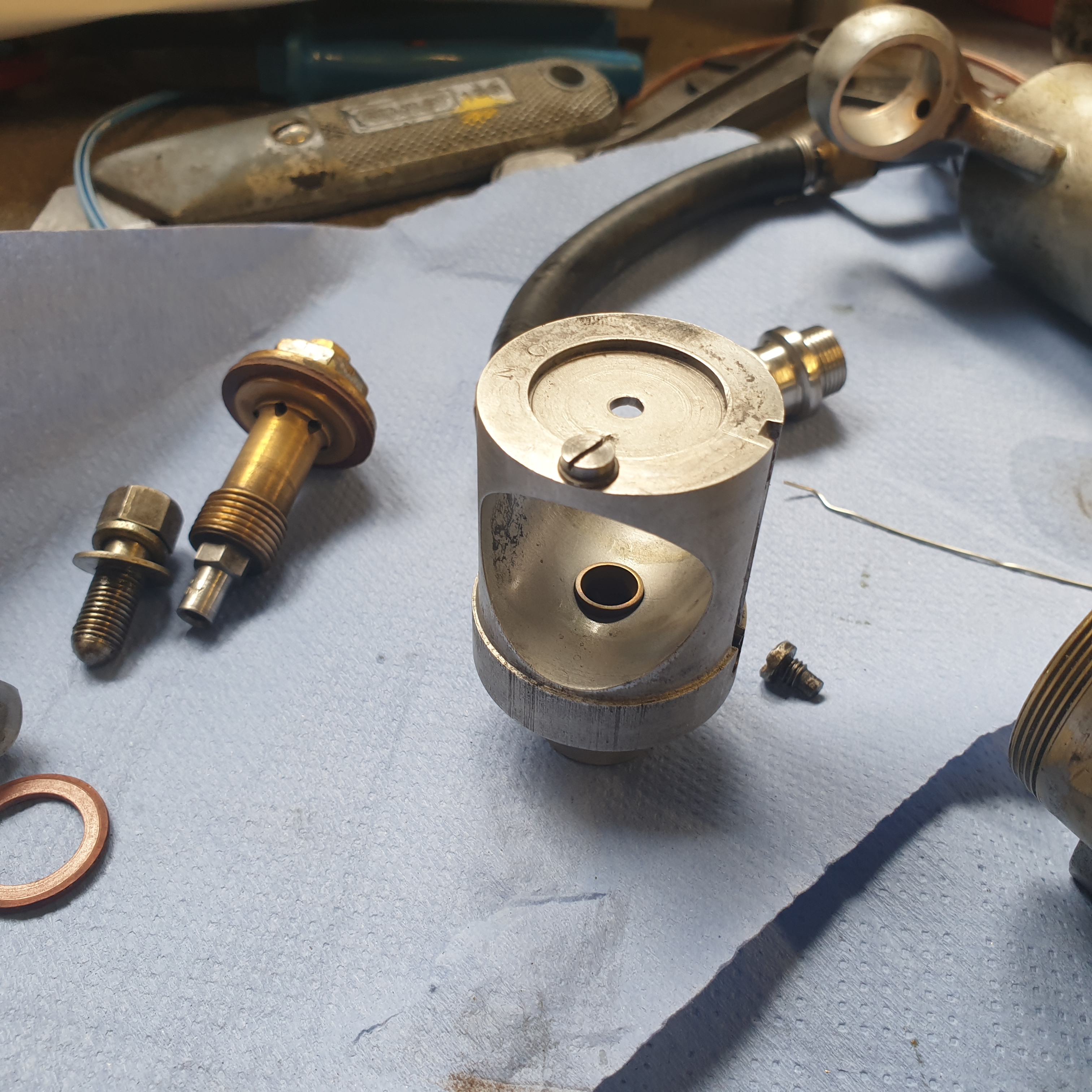

Most helpful, an effective throttle stop. Now when it gets going, it stays on a reliable tickover even when I get off to open and close the gate. Attached photo shows it.
Don't flood. Tickle to feel bowl is full, no more, and very small throttle.
My ignition is 37. Retard about1/4" as seen on the disc on top of the lever. Advance as soon as it fires and open throttle gently. Don't blip the throttle because that just gives it big gulps of lean mixture.
I currently have a foam sock type air filter on the intake stack. By Ramair.  Ugly thing but neutral colour and it's easy to remove.
If I were to change the carb, I think it would be to monobloc because they look a bit better to my eyes. The Amal 'standard' 289 is available at the correct size.  BUT the angled float chamber seems to be unavailable, so you'd need to fit your TT one...if it fits and if it's the correct level.

Dave; is the threaded jet block a through hole for the "stop" screw? and is there a reason for its radial position?  Its a mod I would like to incorporate with the new 5 slide.  My original 7 is drilled...
 Snow prevented a road test but it will come soon.

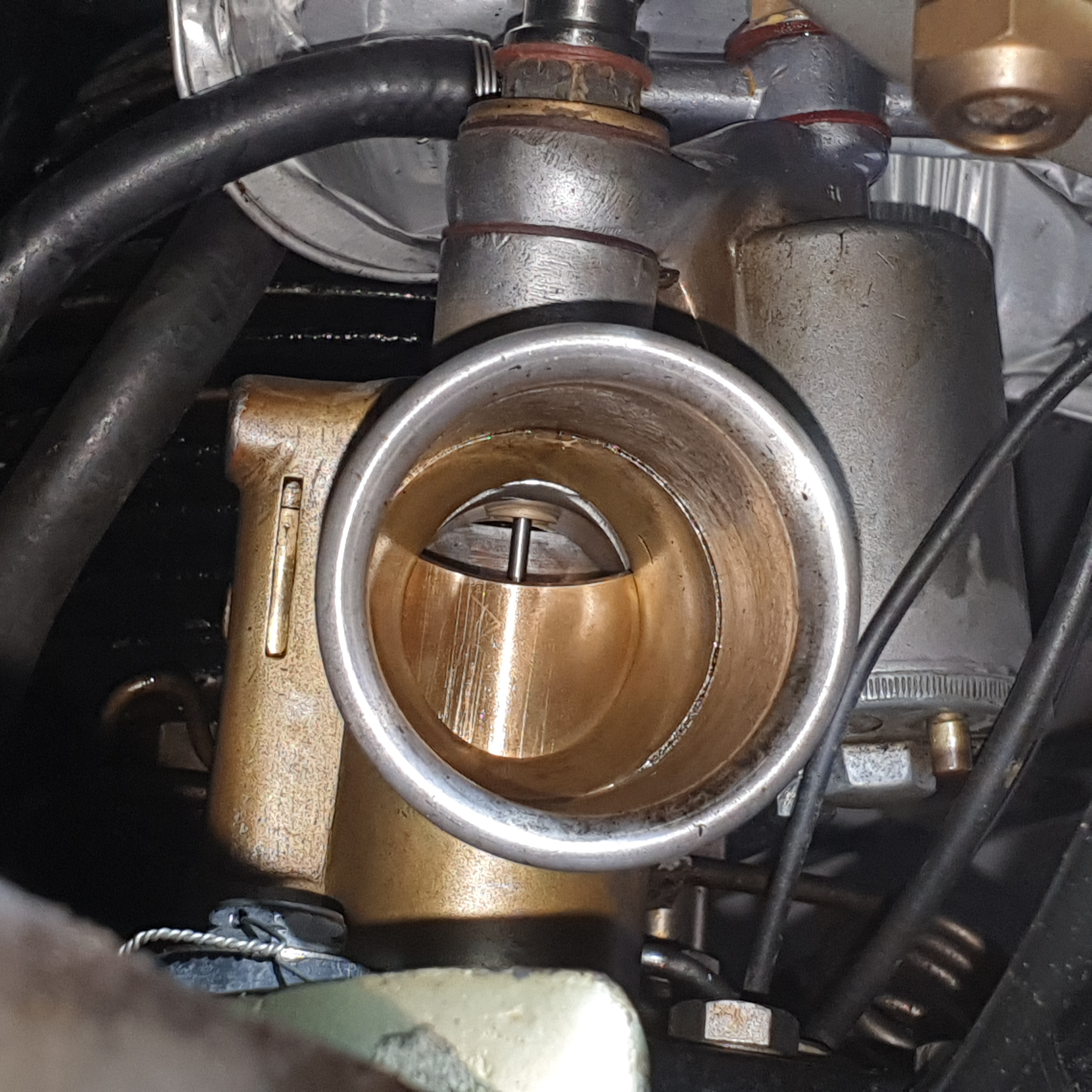

The little cheese head screw stops the slide from falling all the way down. There is a reason why it is so close to the edge, but I can't remember what it is! I think it becomes obvious once it is all in pieces. My PO fitted it but he didn't make it thick enough. I think you could pop a blob of blutak in (on the bench) and look for a small air gap...my tickover on advance is a bit quick (maybe 1200rpm) but falls to about 700 on retard. I'm sure it could be slower. I have a photo down the carb throat and I'll dig it out.
Some writers here talk about drilling a hole in the slide. But at about £70 each, I don't want anything irreversible. Now I can stop at the end of the road and wait for traffic etc, and not lose the motor if I make a hand signal. I don't think TT riders did much signalling.
