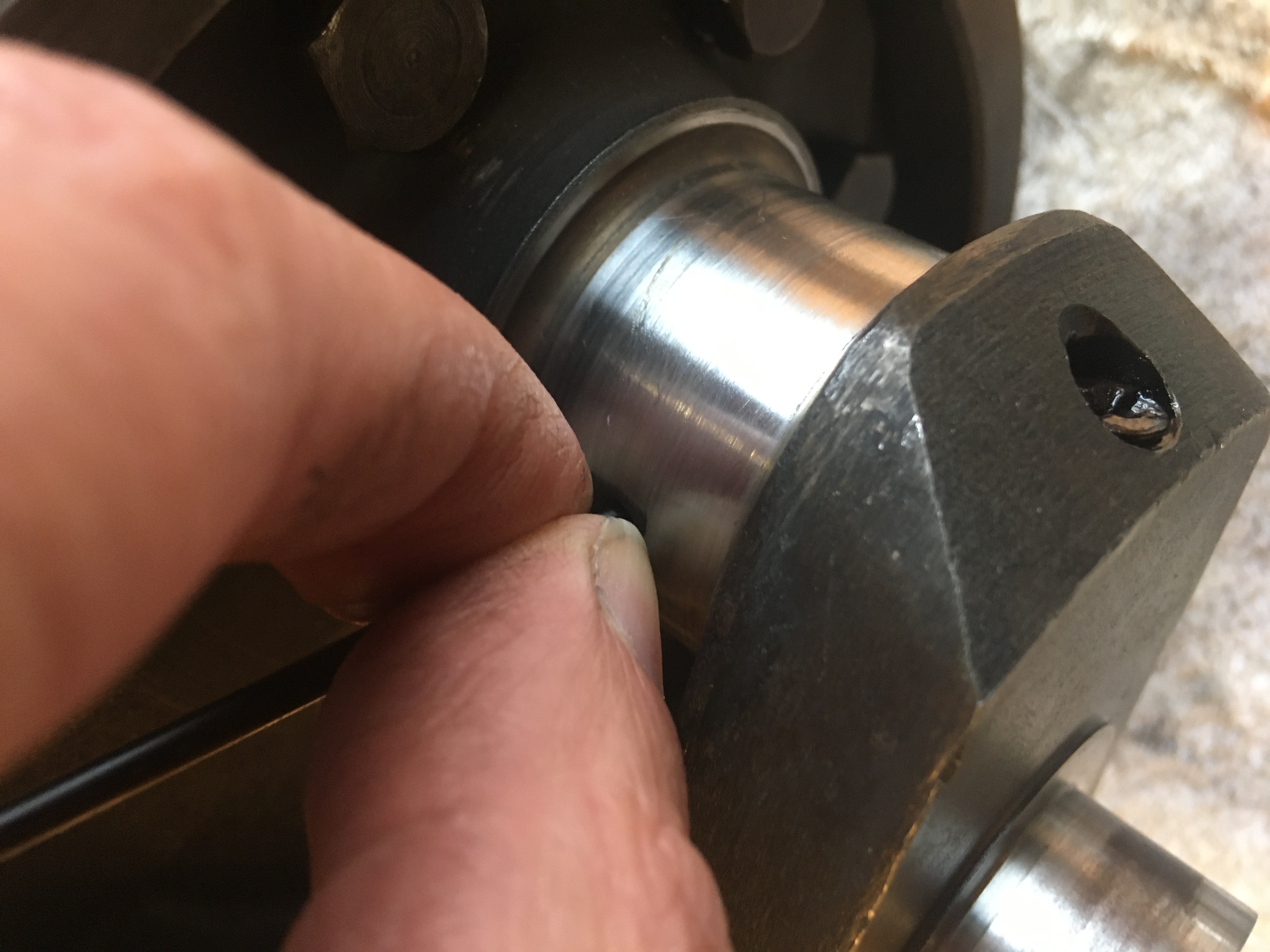

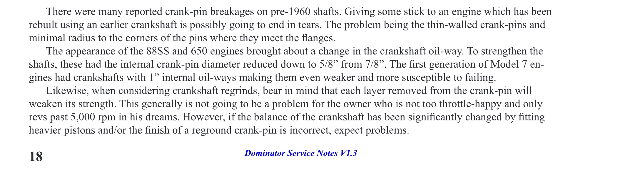

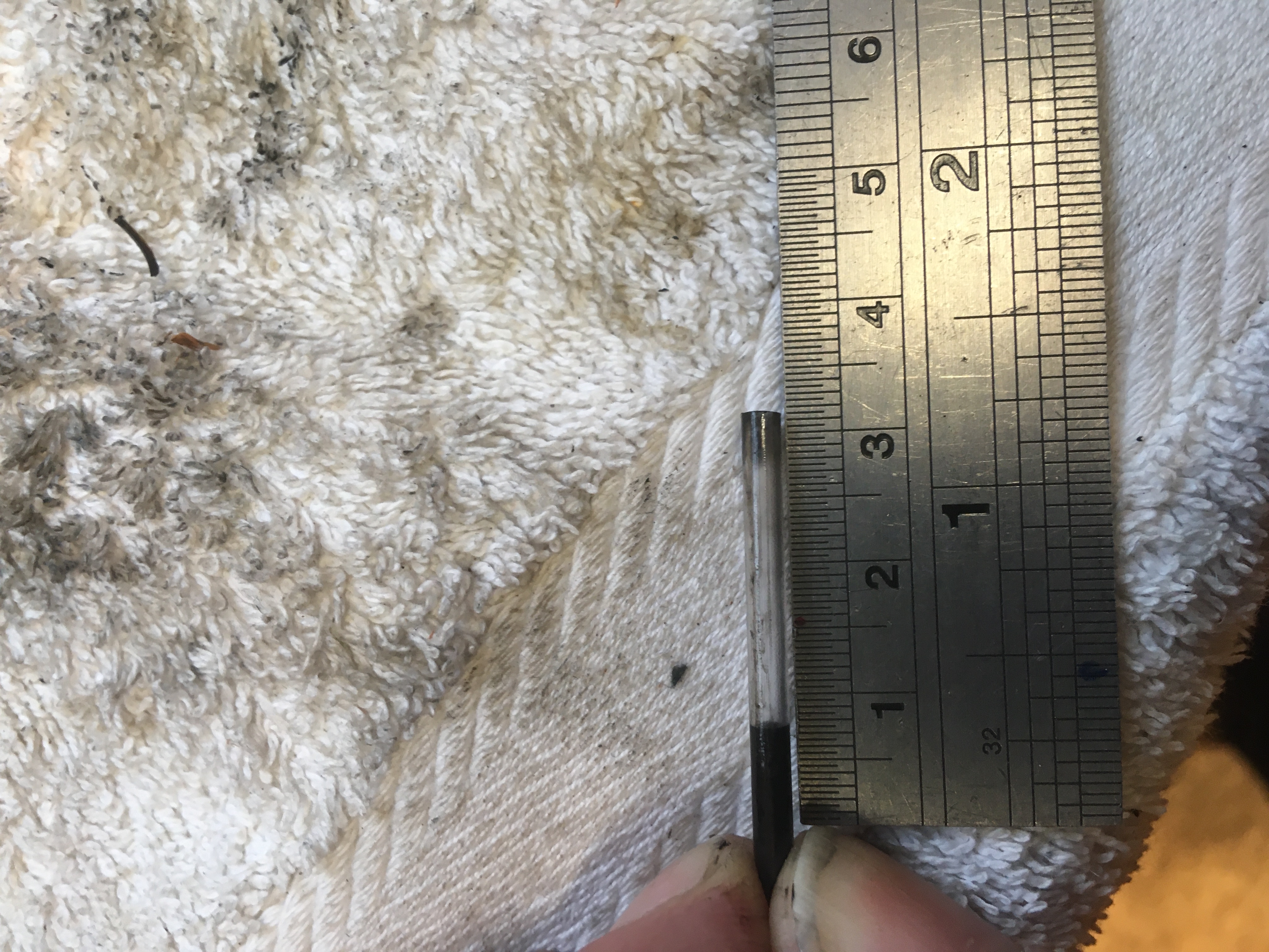

I'm searching for an 88 crank with a crank pin bore less than the crank I have which has a 1" bore. Referring to the text from the dominator service notes (see attached pics) Im led to believe that I have one the early weaker cranks and should replace it with a stronger one. Realising that it's unrealistic to ask vendors to strip cranks and measure the pin bore I've asked them to do a depth measurement from the journal face to the opposite inside face of the pin so that I can compare it to mine. Mine measures 31.5mm.
Norvil have a reconditioned crank that measures the same and Eldon at Owens has been through about 20 500 cranks (dynamo and alternator) and says they're all the same.
Can anyone confirm that the three bore sizes mentioned in the service notes existed??? Norvil seemed to think there were only two and only the SS had the thicker pins.

So I'm not necessarily looking for an 88SS crank according to the service notes which suggest the ss crank took the bore down to 5/8 from 7/8 and that only the very early cranks had the 1" bore that mine has. The service notes make me believe that the majority of standard 88 cranks have a bore of 7/8 (stronger than mine) yet the ones vendors have measured seem to be the same as mine. Either the service notes are wrong or the vendors are lying to me but judging by how exasperated they are getting I don't think that's the case!

For what it's worth, I have what I believe to be a standard 1959 88 crankshaft, which appears to be similar to your own, and to all the others that you mention above... it's pin bore is 1", it's OD 1.5", and the "depth" measurement you ask for is 1.25". It's definitely an alternator crank, so doesn't really fit in with the "really early" ones mentioned in the service notes. Probably not what you're wanting to hear, sorry! But fingers crossed, maybe someone else can chip in and give you some better news just in time for Christmas.
