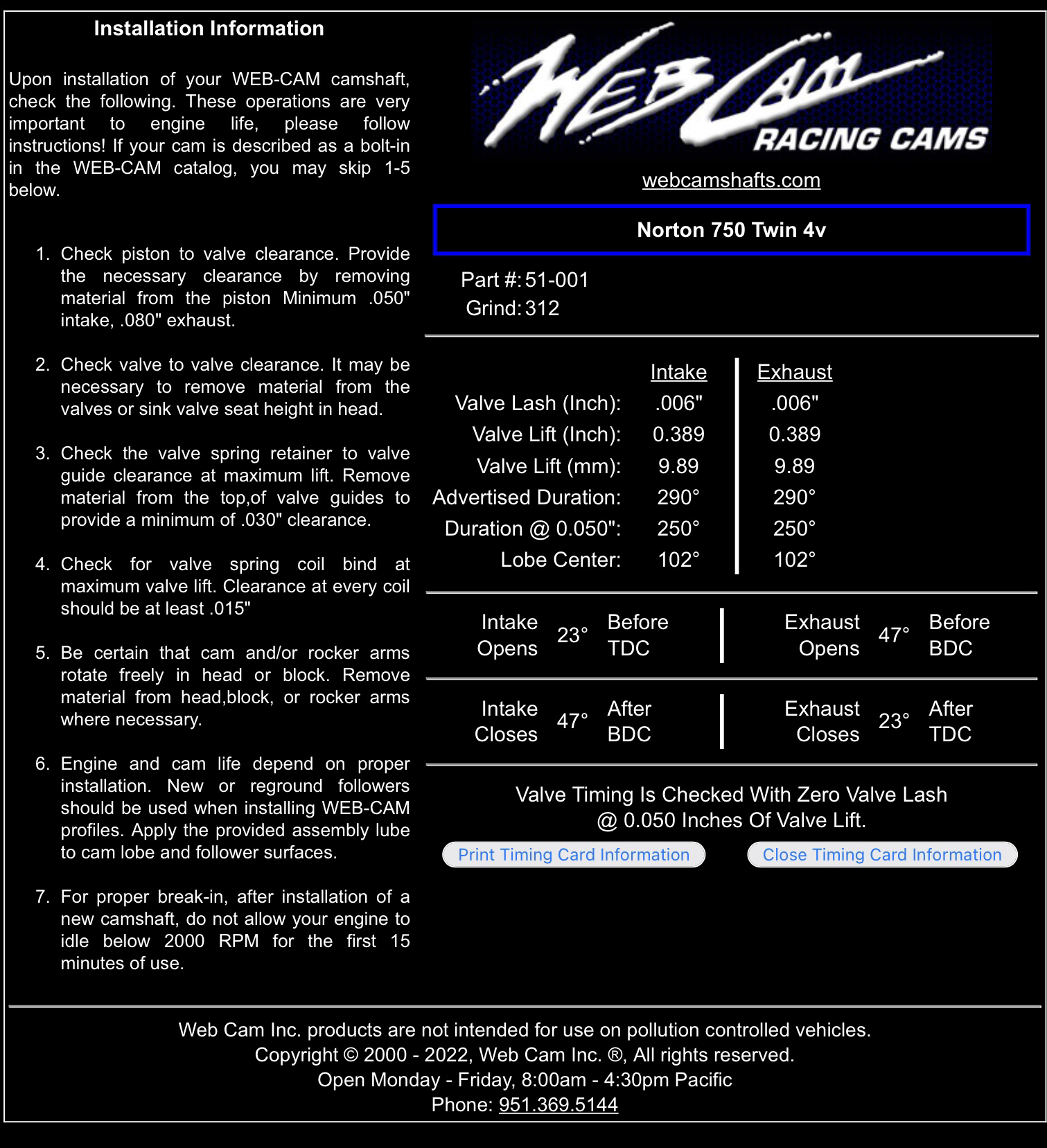

My cam and measured 8.5:1 compression Fullauto is the Web#312, recommended and bought in 2016 from Jim Comstock in the USA. Modern alternative to the cheaper standard 06-1084 cam but slightly more lift and duration with quiet valve clearances of 0.006" inlet and exhaust.
Drops straight in as per standard using the existing timing marks etc, no fiddling with cam timing required. Either cam would be a good choice.

Yes I noticed the valve clearances, no idea why they should be 0.016" standard is 0.006" inlets and 0.008" exhausts. Worth having a word with Newmans or RGM. The Web#312 specs are below to compare. It's a welded cam using an old cam supplied by the customer.
