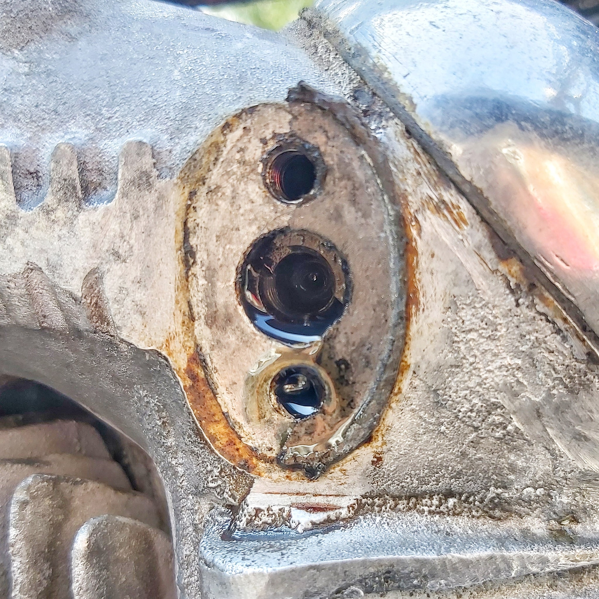

Hi Everyone came across an issue with my 1967 Norton 650SS today. The rocker spindles have been turning by themselves one worse than the others they also seem quite deeply set into the head which is why the tangs on the end caps were not engaging.
Ordered some of the locking type one piece end caps from RGM today.
Going to replace the rocker spindles but noticed on mine although plain that they do not have the flats. Just curious were these the original types going to order some with the flats next to the oil hole on them.
Popped the timing cover off an she's fitted with the 6 start oil pump.
Got my hands full with the commando rebuild hence going down the upgraded end cap route
Spindle came out by hand.

Coincidentally I found out on Monday that I have exactly the same types of spindles and , like you, could find no reference to this type. Although my bike is a 1964 650ss I do know that the head has been changed during my ownership.
The reason I was looking at the spindles was that mine could spin in the head and I wanted to check the position of the oil feed. I originally tried new spindle locking plates from AN but these still didn't engage. After bending one of these when trying to tap the 'tangs' out I looked for another solution. The RGM option that is described above was rather expensive but I found that Norvil do plates with deeper tangs and these do seem engage. These are slightly more expensive than the AN plates but way cheaper than the RGM option.

Hi Graham,Middletons appear to have the set screws ,the old brits tip with the wire probe is a good one. Less good is the Old Brits comment about head feeds as it does not apply to the high pressure top feeds of the late 650/750 featherbeds.

Thanks guys I really do appreciate the replies I actually have a set of the Norvil ones that I got for my Commando rebuild. Alas they didn't reach deep enough for the spindles that are in my ss and turning but do for my Commando. Once I got over the initial shock of seeing it after a huge dejavue moment relating to my Commando got the RGM ones ordered so that will be interesting to try.

It's interesting to see you have the same spindles Graham as no one seems to have come across them who I've spoken to I'm wondering if its something they did in early 67 before the did the ones with the flats interesting stuff.
I did spot on Norvil they do a spacer for the rockers when fitted with the flat type wondering if a set of those would help matters when I get a new set of spindles ordered.
I'm Curious about the spacer…
I'm Curious about the spacer you mention, Is it for use with the narrow later rockers if used in the earlier head?.If so ,will only be any use if buying new rockers.The new spindles may help with the loose fit as its often the harder material that wears most. I had thought of installing some shims at the blind end in the head.My spindles are without flats too.

Hoping to have the SS back on the road by next week one thing I am curious about though everyone 6 start oil pump so high pressure feed. noticed this in the manual
Just reading my 650ss manual part number p106/P
it will be noticed that the rocker spindles have a "flat" on one side. the spindles should be fitted with all flats facing inwards to the centre of the engine and slot spindle end lying horizontal.
Now as far as I an others are aware high pressure feed requires the spindle flats to be pointing outwards.
This sort of conflicting…
This sort of conflicting information comes about because the manual is describing the earlier set up . with a low pressure feed . Also AMC were still learning that the high pressure feed caused as many problems as it solved . I do wonder if the Commando had a sloping engine to look racy or if it solved the oil drainage problem that the HP system and hump in the middle of the head caused!!. If you want to fit inlet seals then you need Commando guides to retain them ,the guides may also be shorter to accommodate seals which if so would make them wear a bit faster!! .Improvements are not always good. I have modified and "improved" the low pressure feed on the 99 , time will tell. Testing,testing,-------.

Got the definitive answer on…
Got the definitive answer on this today Robert was done in 66 before they machined the flats on the spindles when they first went to the six start high pressure feed. Drove down to Norvil today an got the new type spindles to fit with the flats tomorrow from Norvil and a few other bits :) exciting stuff
Massive help fitting me in so I could get the parts should be back on the road this weekend!
Don't forget the longer…
Don't forget the longer bolts (set screws!) for the RGM conversion. It does not come with the kit and using the old ones will rip the threads out. far too short.

Hi Tom, I'm rebuilding our 67 Atlas and had exactly the same question. I have asked those who should know ,and they don't. I can only assume its an AMC mod in the last bit of production of the 650/Atlas. The RGM mod works on my 99 although you have to find some 3/4"or longer stainless hex head 1/4 Whit set screws as no Norton supplier stocks them . Google camera bolts. I have done the mod on the exhaust side only . They need several hot grub screw retightenings and have a tendency to throw off the cover cap (locktite when happy with the job). There is not another easy solution to the wear in the head. The 99 now runs much quieter. Turn the oil holes to point away from the pushrods (seems wrong!) but check oilway clear to ball end. If you don't do this, the High pressure system can deliver too much oil to the inlet side (which can't drain fast) and smoke the valves, The rockers need the oil to be forced to go along the bushes and not all to the ball ends ,excess oil on the exhaust side can drain down the push rod holes in the barrels and helps the cam. The wear has occurred thro the rocker bushes not getting oil and tightening on the spindles. The above set up will fix this. On the low pressure system (99 or early 650) its different if any one is doing one. I have bought 1" camera bolts and cut down to use all the alloy thread ,don't overtighten!!. If you suffer smoky valves you can fit commando guides with seals to the inlets.If the inlet side is not worn you can with care tap the plate tags out a bit more. Perhaps someone will make some side plates with bigger tags ?? The Commando situation is also different as the sloping engine drains oil better down the tunnels.
