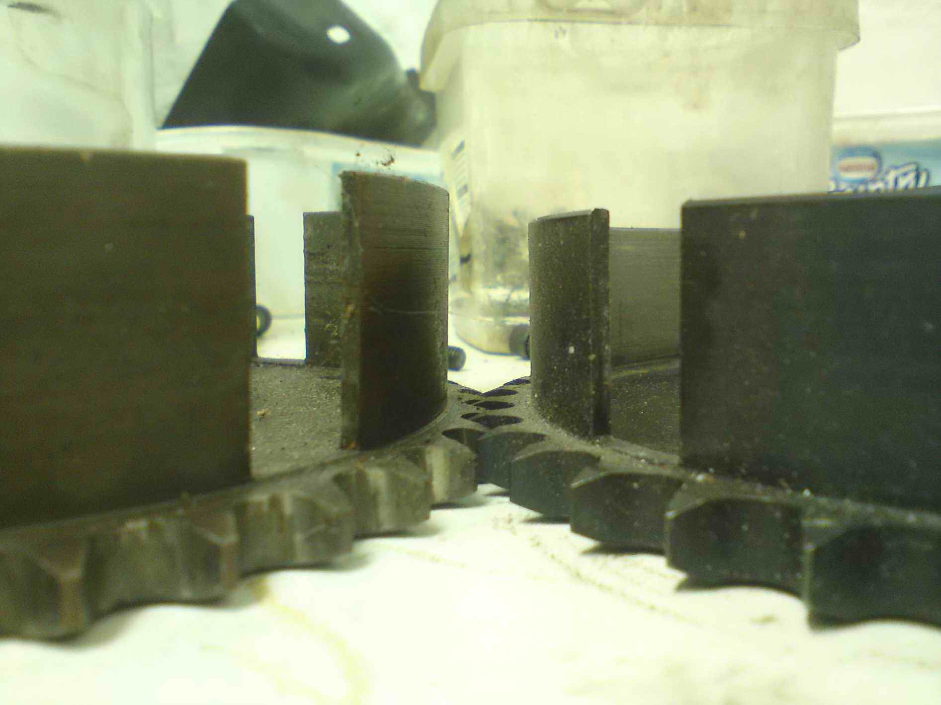

I have a damaged clutch basket on my mercury and seem unable to locate a eplacement. RGM sold me one which takes 4 plates (friction and metal). My unit is a 5 plate clutch. I have attached a pic of the two baskets to show the difference in size.
Any ideas?
Any ideas? hello dominic If you send the basket too me I will get it sort for you and send it back so you can use it again My friend As A engineering workshop As done theses Clutch Baskets Before . Hope this Helps you , Yours Anna J Dixon east yorkshire branch for more info Email me at annajeannette@btinternet.com

Thanks Anna. Email sent.

Hello Dominic How the clutch basket I welded up for you , I did not get a reply from you are you Ok , Yours Anna J
Hi Anna I did send you an…
Hi Anna
I did send you an email at the end of August thanking you for the work done. The basket seems fine. At last the bike is moving under its own steam.
thank you once again
regards
Dominic
Hello dominic Well done If…
Hello dominic Well done If it fails again then RGM Motors have some new ones in stock Hope this help yours anna j
Dominic,
Dommi/ES2 clutch baskets are available as of today (really!) from Andover Norton, newly made in the UK, not India, after an absence of about 20 years. The other clutch parts we currently don't carry, i.e. those for the clutch centre, to follow very shortly.
