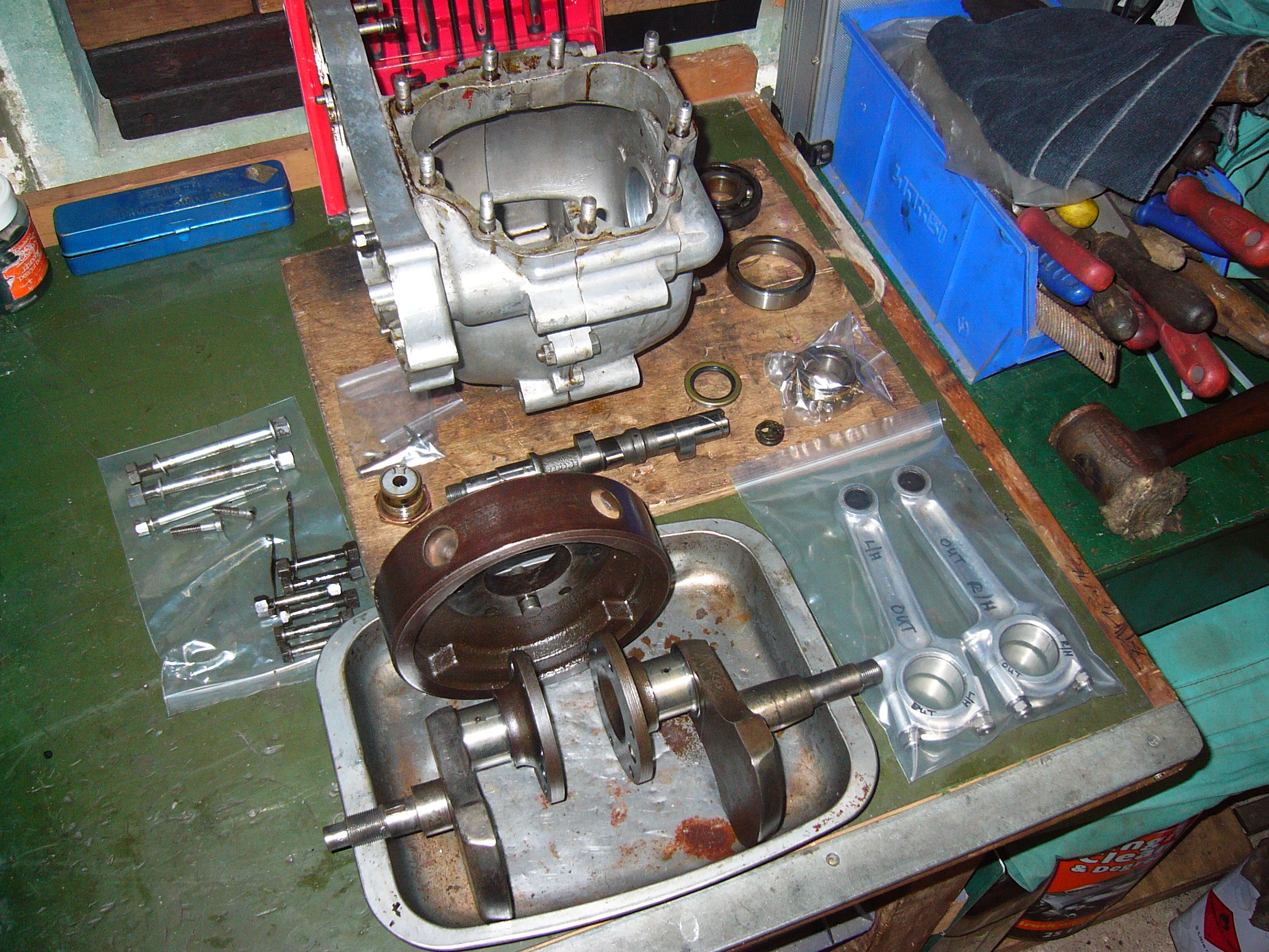

Another thing I had no idea about ! Not having rebuilt a Norton motor before I have had pretty well , no, everything done on the bottom end and am waiting at the moment for the head to come back having had everything done to that. I did have the crank apart to check the `sludge trap` but didn`t measure it as up until now thought they were all the same . I was actually amazed at the size /volume of it and thought how much oil it would take to fill it up before the big end gets any lubrication . I dont really want to pull it all apart again just to check the size. Someone else had built the motor before I got it ( Badly ) so it unknown what crank he may have used . Am I in a fix ?Photo gives an idea of the crank .
In reply to by wayne_rudolph
The issue of lubricating the big end journals is overcome in the main by setting the crank at bottom dead centre and filling the cavity from the end of the timing side shaft using an oil filled grease gun until you can feel the effort from pumping building up telling you you are forcing the oil into every nook and cranny. The later this is carried out during the build before the timing cover is replaced will be the most beneficial before the oil has time to bleed away into the sump.

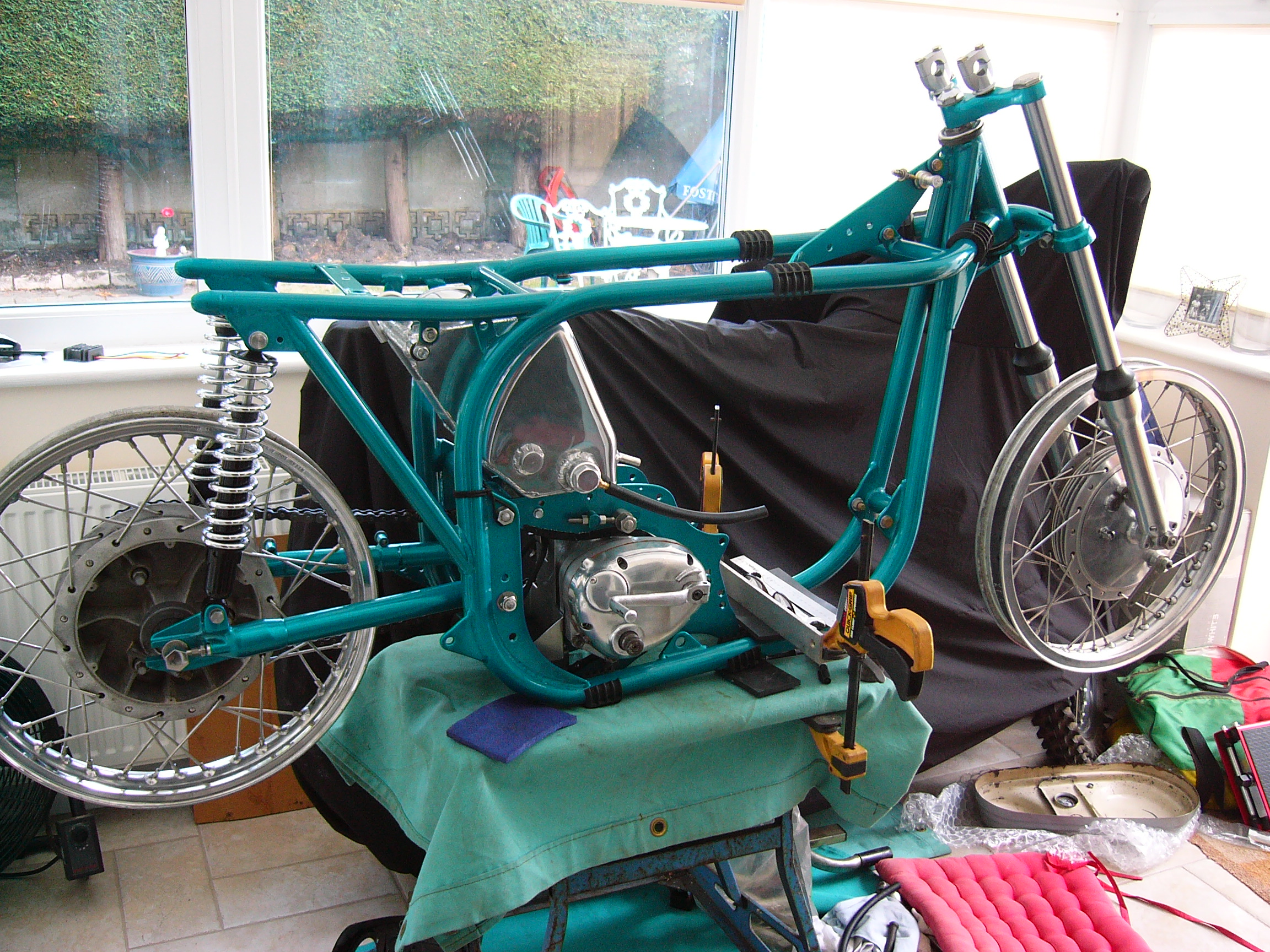

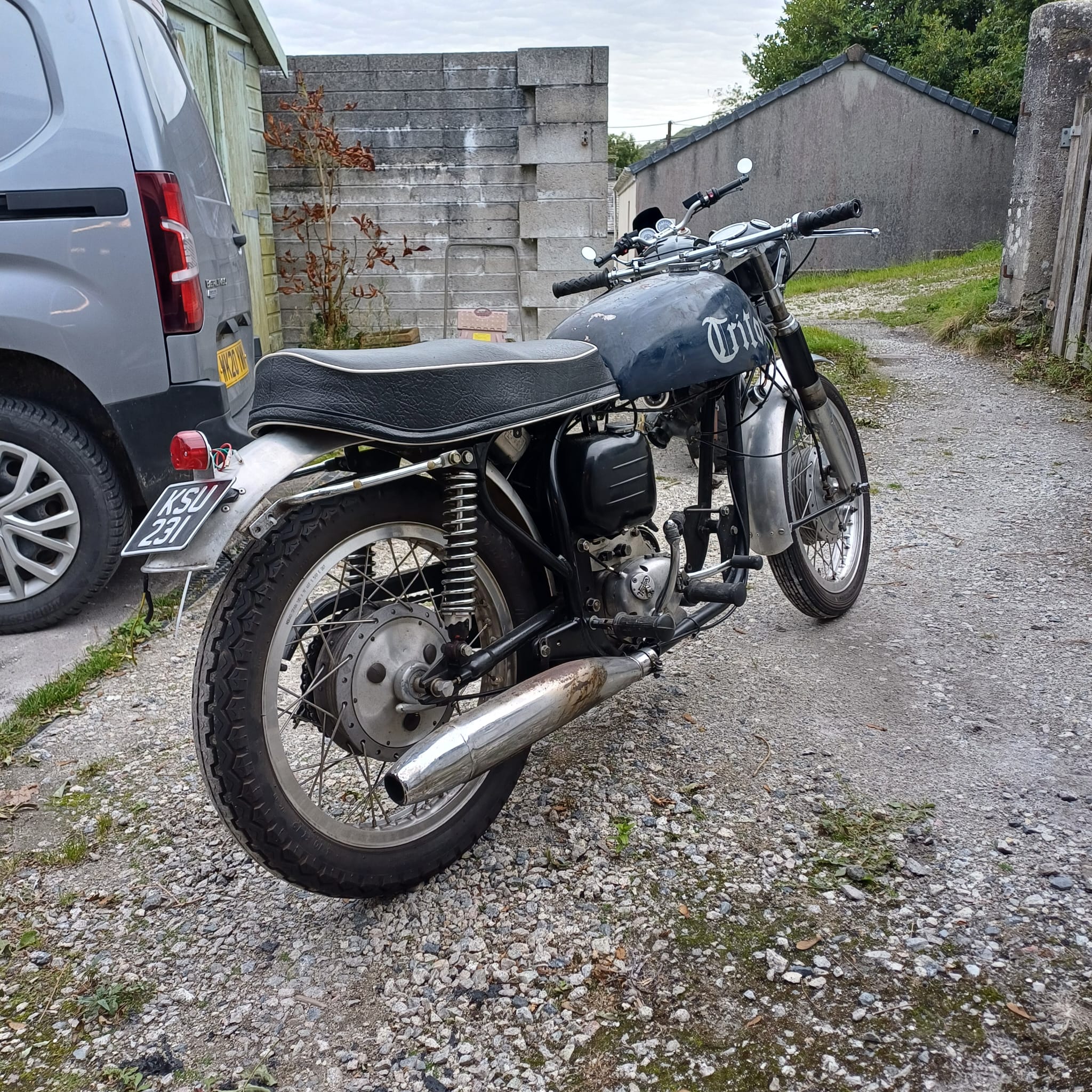

im also trying to determine just how bad these are. I have a 1" oilway dynamo crank in my engine. I've completely rebuilt the engine with new liners pistons and rods. The rods and pistons are heavier than the originals and the crank has been reground to -10. Perhaps there are many similar engines out there revving away happily without issue. Or we both own disasters waiting to happen. Who knows!
Thanks for the Links you sent me . I`m a bit annoyed with myself having thought I had read up on all the pitfalls of Norton engines and now find this potential failure point looming over me .. It does seem likely that I may have a 1" dia oilway crank and worse than yours my regrind was -020" ! It`s a long way from being a complete bike and the nippy Cafe racer it was intended to be ! Photo attached showing the `Money Pit ` .....
