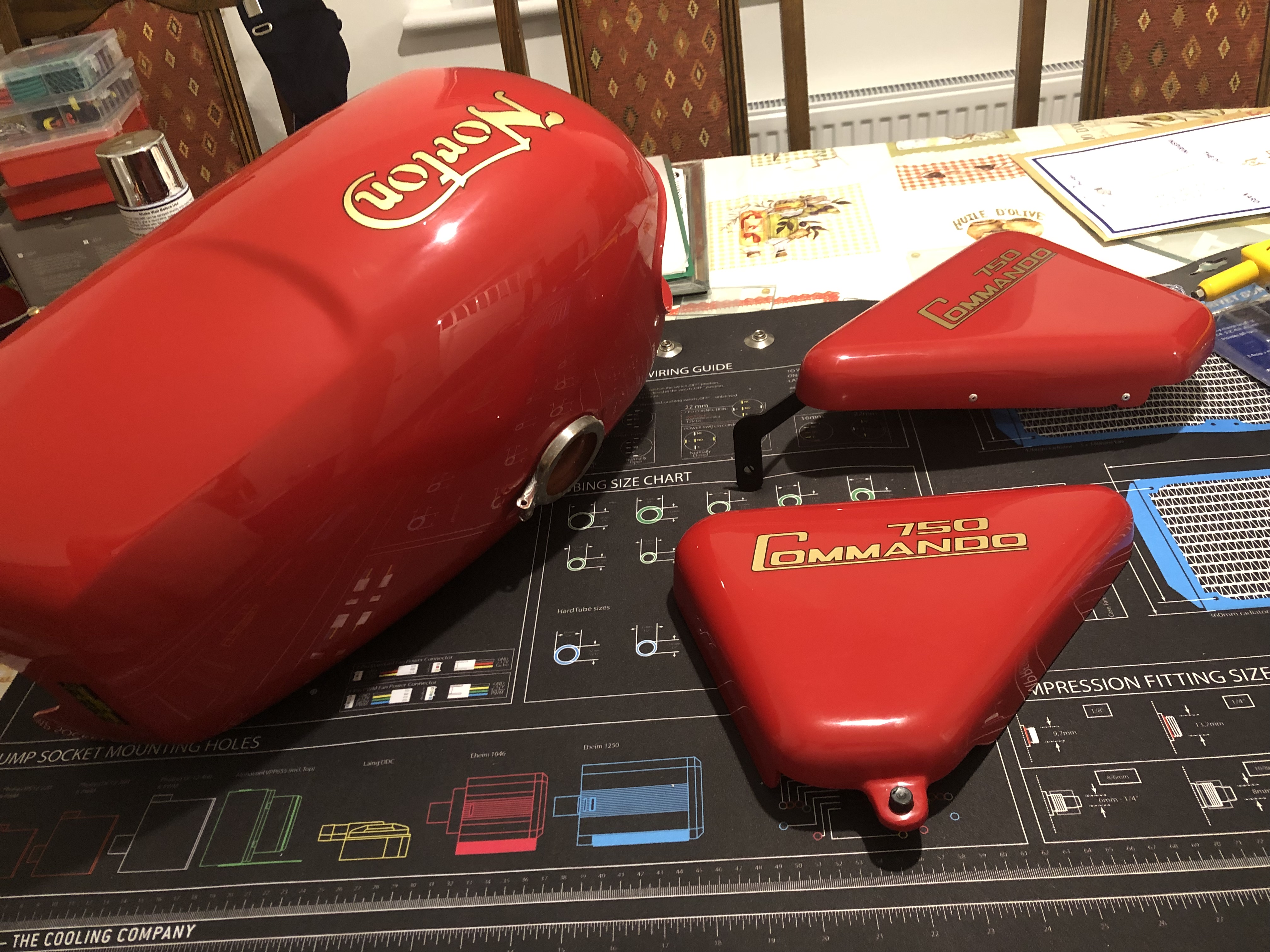

OOH very posh, nice job.
Are you happy with the quality of the paint. The paint job looks good. Do you think the RS paints come close to the original Signal Red or are you just happy with what you have done.
Sorry for the belated response.  I am happy with the signal red paint finish from RS and so was the professional who helped me.  However he didnt like the clear coat that is supposed to be fuel resistant and used his regular brand.
I have the original fibrglass fuel tank and tbh its hard to compare since there is so much depth in the new steel tank colour (maybe i will try get you a side by side comparison but not sure if it will help).
Looks nice:
I have two of these red gel coat fiberglass tanks. The screen shot of just sprayed sitting on the table has a metalic look to it. The solid signal red is also very close to the plain  red of the white/blue/red JPS 74/75 scheme.
Don't know why the NOC tech article makes no mention of the factory parts book names and codes?
