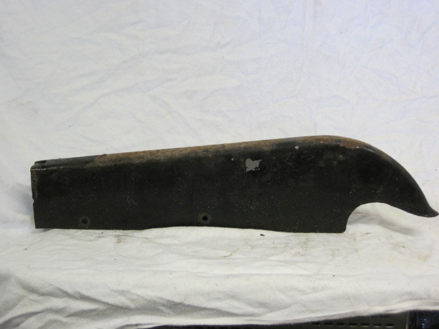

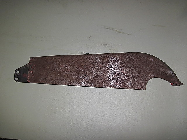

Here you go, 58 & 59/6…
Seems I have to load each…
Seems I have to load each one seperately!
Attachments 59-SA.JPG- Log in to post comments
.....................again…
.....................again!
Attachments CG-59.JPG- Log in to post comments
Yep - that looks right to…
Yep - that looks right to me! My 1959 99 had the fully enclosed chainguard optional extra. I removed the bottom section when I changed to a 3/8" rear chain in 1965 because it clanged against the guard! Of course, I lost that bottom section over the last 46 years and had to hunt for a replacement afterI decided to put the bike (for "bike", read "pile of rust"!)back as it was "ex-works" concours (I'm not there yet!). I found an oldfull guard in pretty good nick at a Stafford Show a few years back, wot only cost me £40! I now have a full plus the top half of a full one! It was just as cheap as buying a repro standard guard. I know that they are great at collecting dirt and oil and spreading it all over the chain! No probs as I won't be riding it in the rain - or when it's dusty...or cold...or too hot..........! LOL!!

Hi, Thanks for the prompt replies this has answered my question very well, the 1954 domi chainguard I have is different to the 58/59 photos that you posted.
The frame is at the sand blasters so I will have to wait till it comes back to check which swingarm I have as I do not remember.

Hi Andy, I believe the chainguard you require is part number 21832. I have the parts book for 1959, it also lists the fully enclosed chainguard under âoptional equipmentâ part number ERCC7.I checked my 1961 parts book and the numbers for both are the same. Therefore the same chainguard was used on wideline and slimline frames. I have an original one fitted to my 1961 Model 50 and a reproduction one fitted on my 1957 model 99. The reproduction one is an exact copy (you would not tell the difference when comparing the two together).NOC Spares list a reproduction 21832 chainguard at £35, but are currently out of stock.The item currently on eBay looks the same but the picture only shows the rear end.
Hope this helpsRegards Alan
