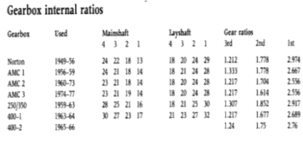

Another point to bear in mind is the gearbox type fitted to the bike. Post Laydown Gearbox (1956) but pre 1960 bikes most likelyhad an AMC 1 gearbox with a 24 toothmainshaft output gear. After this year, the AMC 2 was fitted and this had a 23 tooth gear. This difference of one tooth makes a big difference to the gap betweenthe first and top gear ratios. In the AMC 2 box the first 3 gears are now raised and the previous large gap between 3rd and top closed up.
The AMC 2 gearbox is a much better to use with the later engines. They have the power to pull away despite the higher first gearing. Earlier lowered powered twins will struggle a bit unless the engine sprocket fitted is no greater than 20 teeth.
Or...................you fit a smaller gearbox sprocket and then have fun and gameswith the rear chain.Checkout the attachment for internal gearing of Norton Boxes.
