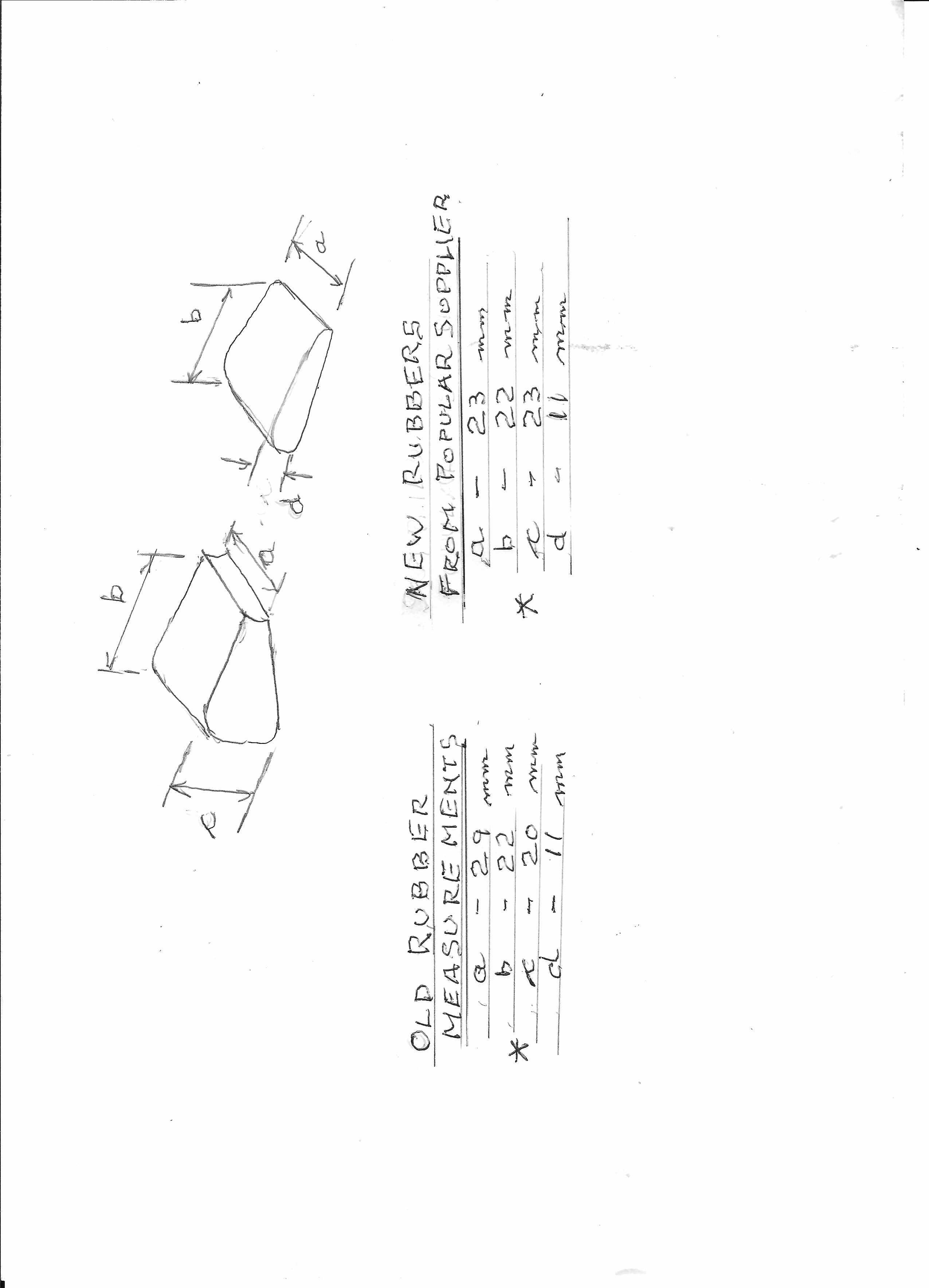

The new “rubbers” – bought from a known supplier – are totally wrong. The attached sketch shows the differences from the original. In addition, they are extremely hard, can hardly be compressed at all. They resemble plastic more than rubber.
The larger is 3mm wider than it should be, so if fitted, the smaller would have to be 3 mm thinner. It isn’t so I have tried to cut off the 3 mm while leaving the shape as it should be. The material cannot be cut, it has to be sliced with a very sharp knife.

Metric dimensions are…
Metric dimensions are confusing here! Dimension 'a' in the metal is one inch (25.4mm). The rubbers are approximately 7/8" when new. That allows them to expand sideways when they are squeezed. Eventually they fall apart but before that one of mine expanded sideways to more than 25mm. I cut the sides down with a craft knife, and re-fitted them because mine were swollen but not rotten, and the new ones I bought were far too stiff to fit, even with the correct tools.
