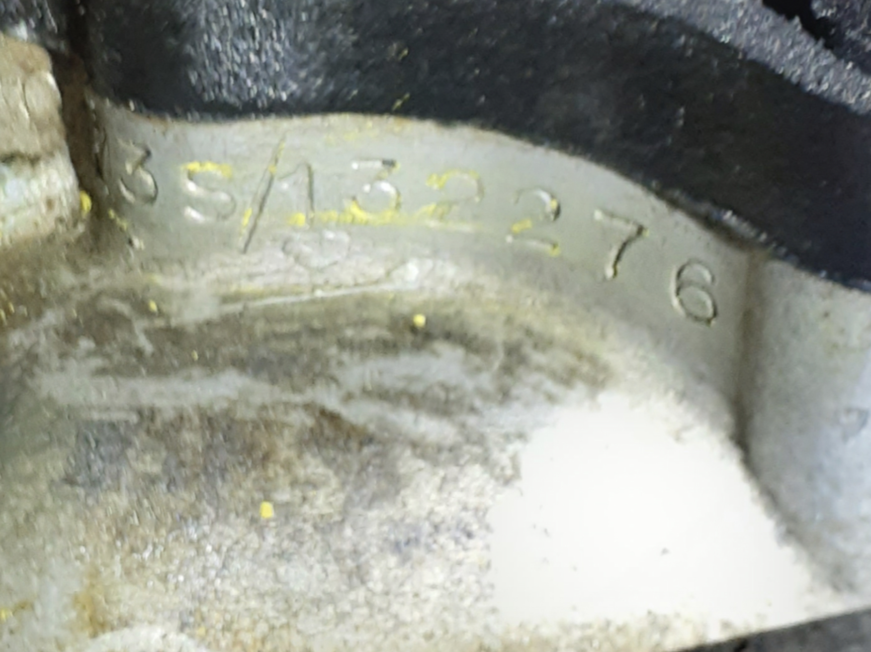

I am ourchasing now bike 2M3S 132276
I need to know now if possible, if this is an S type.

1. Verify with published range of vin/SN which only means it is "possibly" original "S" ...Other body styles were shipped within the same range of SN.
2. Verify with factory historical records if it "was" shipped as "S".
Records
My own Commando records suggest that 2M3S 132276 was built before May 1969 but according to Steve Wilson's Norton Motorcycles Book, the 'S' model production started in September 1969 with 133668.
But he then contradicts this in his year sub-notes by stating that in February 1969 the 750 Mk11 series and first 'S' type commenced production with Commando 131257.
