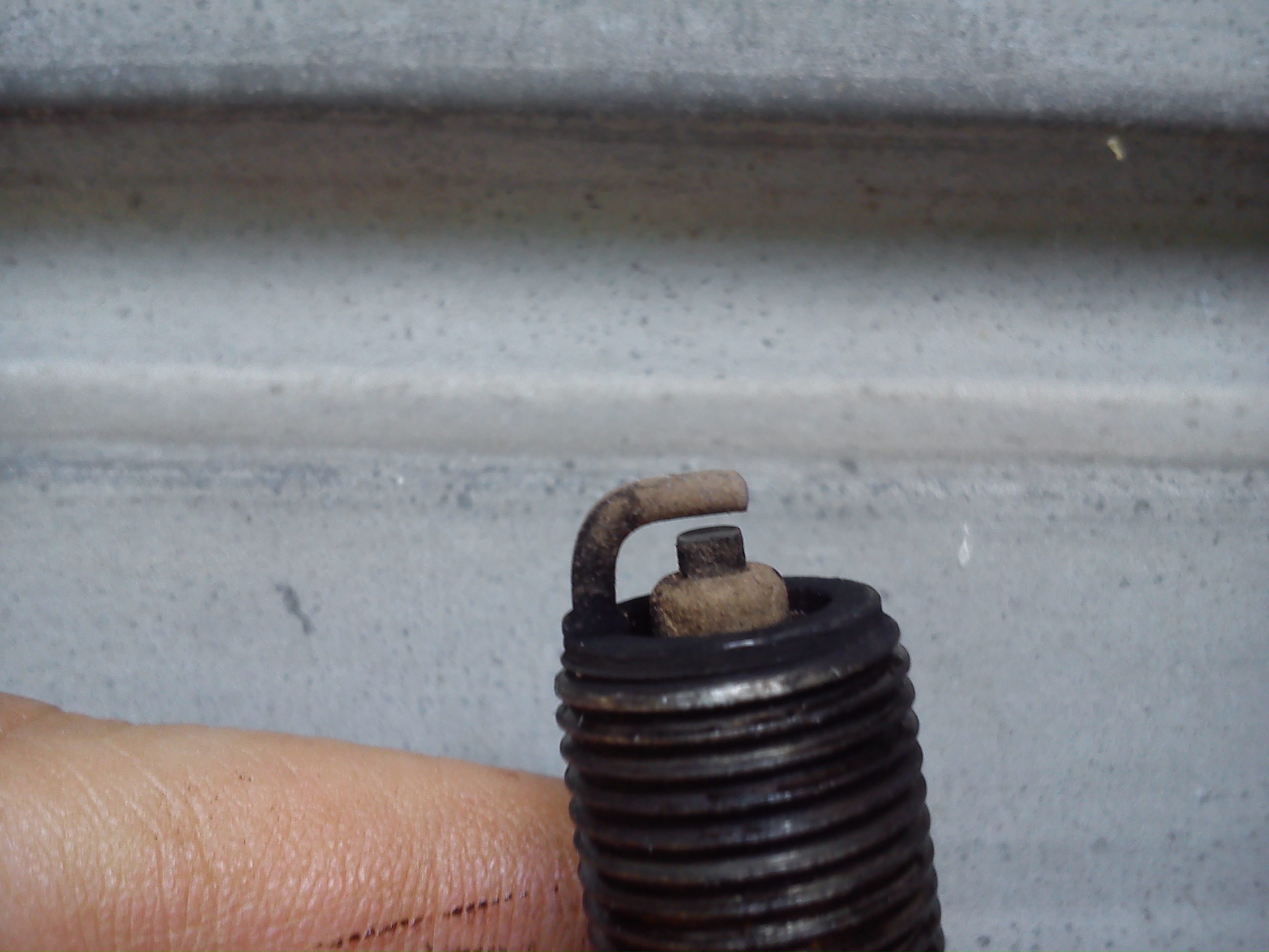

Hi advice welcomed Here is the situation. 72 750 fettling to get back on the road.
1) Carbs replaced with new Amal 932s. Plrobem of intermittent misfire when cold and occasionally when accelerating from 2000 to 4000 rpm (seems ok over that but I dont ussually hold it at that for long)
2) Repalced the Champion N7YC with N6YC. Took four kicks not the usual one t or two to start. Same misfire symptoms as above. No difference really.
Checked plugs after a 20 minute run up and down the rev range. New plug's N6YC electrodes are now white Pic1. N7YC that were in the bike when bought a month ago Pic2
It seems that I am now running a weak mixture even though no changes have been made to the carbs. Any thoughts? Thanks Nick

Hello well hear some Spark plugs that self clean NGK BR7ET or Bosch W7LTCR these are both mid range heat, suits your Commando Engine But Check them out first,, yours Anna J
Hi Tony and Anna,
Thanks both for your info. I tracked down a pair of NGK BP7ES plugets and got NGK equivalents in the palladium version. Havent had a chance to try them yet Friday is the next chance. I will track down the Bosch plugs too. I think it is worth trying to find the best to suit the bike and the nasty fuel we use. Nick

Hello the NGK BR7ET are Three point spark plugs like Bosch ones , there Self Cleaning for this nasty fuel we now have to use , Happy riding in the sun , yours anna J
Hi all, Chabged the plugs for NGK Palladium versions of the BPR7ES. Miraculously, NO Misfire! Great news. However:
1) Right hand plug white (ish) but definetly lean.
2) Left hand plug more of a tan colour so OK but still the lean side of ideal?

Now I AM confused!! Took her for MOT about five miles city traffic slow speeds. No misfire but did cut out a couple of times.
Plugs out Pic1 is right side - white colour
Pic 2 Black!
The needle jets are both in mid notch position. Pilot adjusted as per the service manual. How is it possible to have such a variation between cylinders? New carbs after all? Nick

Hi Baz, thanks th commando has two coils. It would seem more logical for the difference in plug colour to be electrics than fuel.as there is such a stark contrast. I will see how to check the coil output and see if there is a difference. They both look old but not damaged as far as I can tell. Cheers Nick

Have you done a compression test?All other things are symmetrical ( or near enough) so maybe the issue is much simpler that subtle benefits ( alleged) of usind different plugs etc..

Hi Tony, as I havent got to the bottom of this I hope the wise heads still proffer their five bobs worth! I am on plug comparison mission, 2 types of Champion, 2 types of NGK. I am working on getting the Bosch ones recommended by Anna, I reckon I have some more detective work to do. Trouble is that plug colour is our only window we have to see what combustion has been like.
The suppressor caps are always coming loose in my experience, try WD40 and a pair of grips?
I am beginning to suspect the advance / retard on the Boyer is an issue. Anyone with opinions on this problem with electronic ignition?
Last thing ..... I forgot to mention that I am running with open carbs (no aircleaner). Is this not part of the issue?
Cheers Nick

I had a similar experience last year with a new pair of Amals 932 (not premiers) for my mk3 850 - set them up exactly as the old ones but the bike ran poorly - I checked all the jets and channels - eventually took them off and put the the new slides and float bowl assemblies back on the old carbs and put them back on - it ran as sweet as a nut (and still like that after 3K miles) - can only assume there was a bad batch of Amal castings.
Hi Alan,
I had a similar problem (850 mk2) with a weak mixture on one cylinder and stuttering, bad starting etc, after fitting new 932 carb bodies. I eventually gave up trying to fix the problemand refitted the old worn original carbs and theproblem was cured.
Later I read a post on access norton refering to poorly made amal carb bodies, the problem being that the small core plug which is pressed in from underneath the carb body (next to the main jet) was not sealed properlyand allowed additional air to be drawn into themixing chamber.
That explained the weak mixture, stuttering and poor starting. Also the faulty carb would not respond well to mixture screw adjustment.
Hope this helps Nick.
Thanks for this info Nick - I can see the plug which covers the pilot jet outlets so will give them some sort of leak test - Alan
