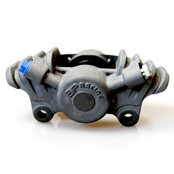

The previous owner of my 750 Commando '72 has swapped out the OE Disc Calliper for an AP Racing Classic CP2696-38E0 Calliper.
The pads now need replacing so can anyone suggest a suitable pad as all I can find so far are high performance track orientated pads. The bike is solely used on the road so do not need anything too aggressive.
EBC FA016 in the base kevlar/organic version. You'll find them listed for T140/T160. You could also go for the sintered HH version for a but more stopping power but they'll wear your disc out.
