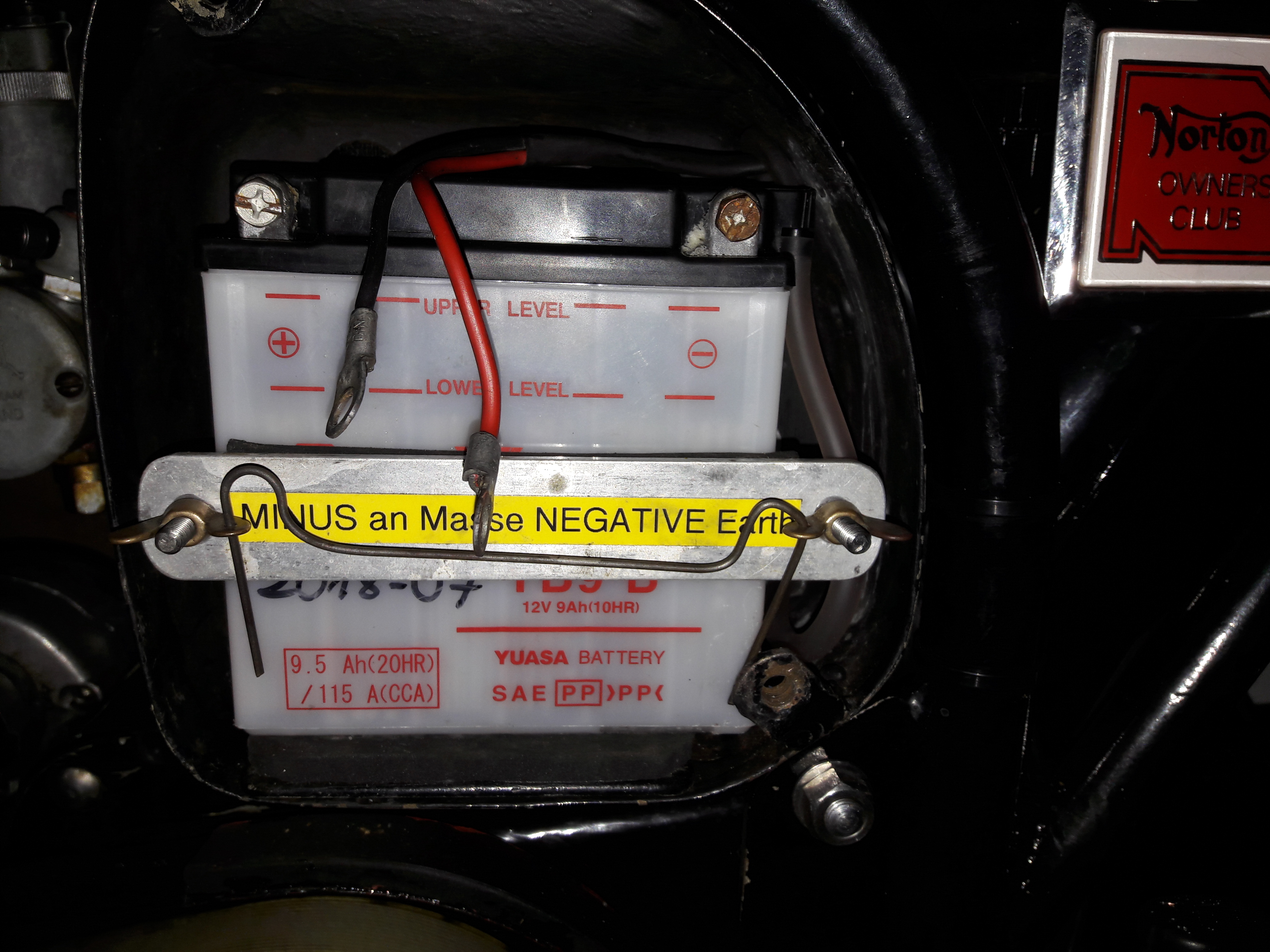

My bracket for the battery is non standard

Hi Len - I owned a '66 650SS like yours with a mag and 12v Zener diode set up.  That had two 6v Exide batteries in series tucked neatly in the standard battery box.  It also had a neatly designed clamping arrangement to stop the batteries chafing.   One of the terminals came very close to the bracket as I recall and I had to keep it greased up to stop it causing a short circuit. It did work very well and I would say more reliably than later bikes with a huge blue- topped Lucas 12v offering.  I'd go for a Yuasa and I'd say 9Ah is adequate unless you're running heated gloves, suit, seat, coffee machine etc.   Cheers, Howard
