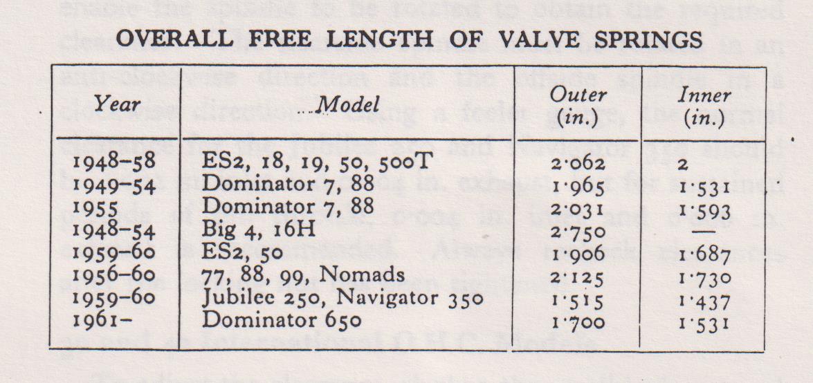

Attachment shows the official measurements up to 1962. Note that there are 3 versions for the Model 88 and a 4th if you include the later 88SS.
The SS versions are stated to be 1.70" and 1.53" long and they might well have been to start with but around the end of the 70s owners started to find that new replacements that were shorter. This difference was explained as a means of preventing certain Commando cylinder heads from becoming coil-bound, on full lift, due to their exotic camshafts. I wonder how many uninformed Norton owners thought their valves springs were faulty or dying and changed them by mistake.
Also worth a mention for those who like mixing and matching cylinder head chunks, there are two versions of the spring bucket seat floating around. A thick and thinner version. Throw these into the pot of heat resisting washers...also two thickness.....and that these themselves were not fitted to all models. Then the fun can only really be beaten by dropping a collect on a very messy floor.
