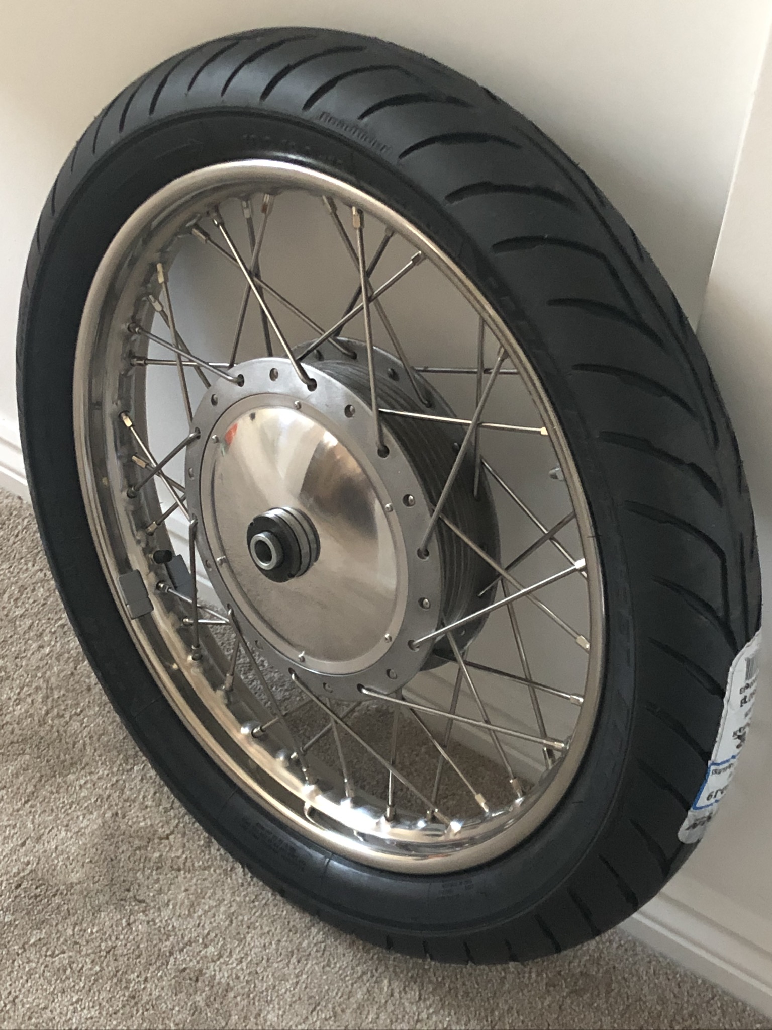

Avon’s I have a 72 Commando now with new WM2 Devon rims they have Avon’s front and rear. I love the handling compared to the TT’s. Not doing high mileage on this bike so can’t comment there and tyre life not really a concern to me. Rather have the ride. And agree to whoever commented that the 72 does feel light at the front end and turns in quickly with the Avon’s.
