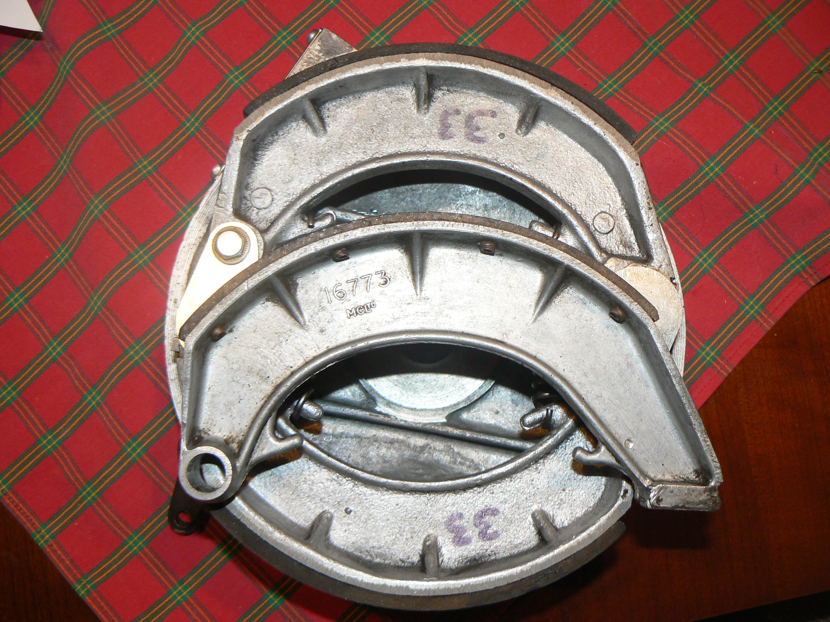

In photos of tickle brake plates they appear to use std norton SLS dommy shoes. These are different to Commando TLS  shoes.
RGM do some John Tickle spare/reproduction parts i think. Have you looked at their website
After some study I am pretty  sure that std dommy shoes were used . Look closely at the shapes of the shoe where the linings stop .8"  Dommy ones are angled at both ends . Commando ones follow the lining arc at one end.  Makes little sense to have shoes specially cast when there was perfectly suitable items already on the market. I have recently bought SH sets of both SLS and TLS shoes  to have spare sets ready and re-lined, so am getting very familiar with the differences..   A set of SH  part worn shoes was used while waiting for re-lined to come back and found to give better sls braking than  a  restored 650 SS with  TLS brake that nearly rammed my 99  up the chuff !.

Interestingly, most of the shoes advertised on E-bay  do  NOT fit a  std Dommy 8" front brake.  they are either rears (7")   or   TLS Commando .  Also linings on E-bay will not provide decent braking

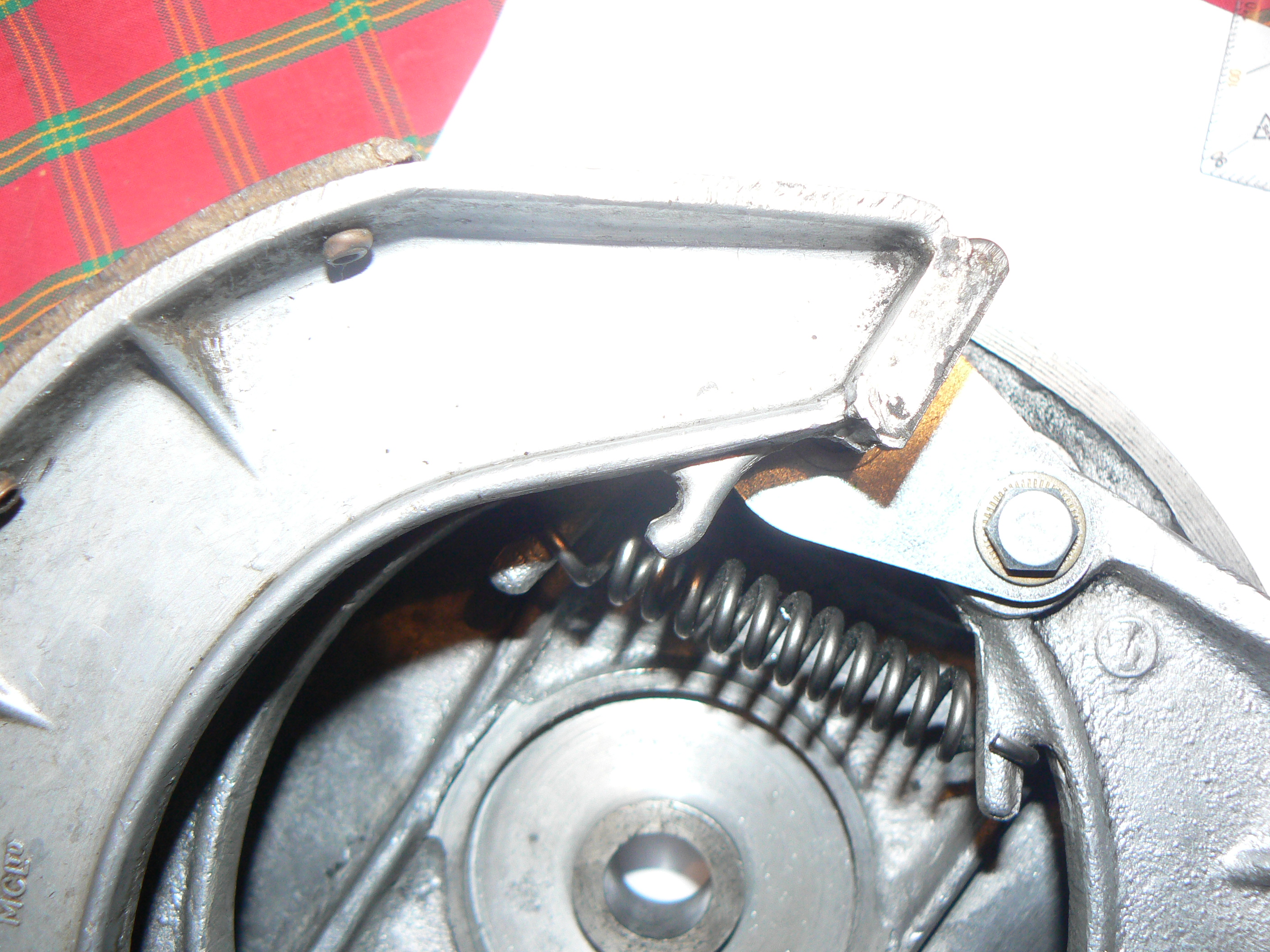

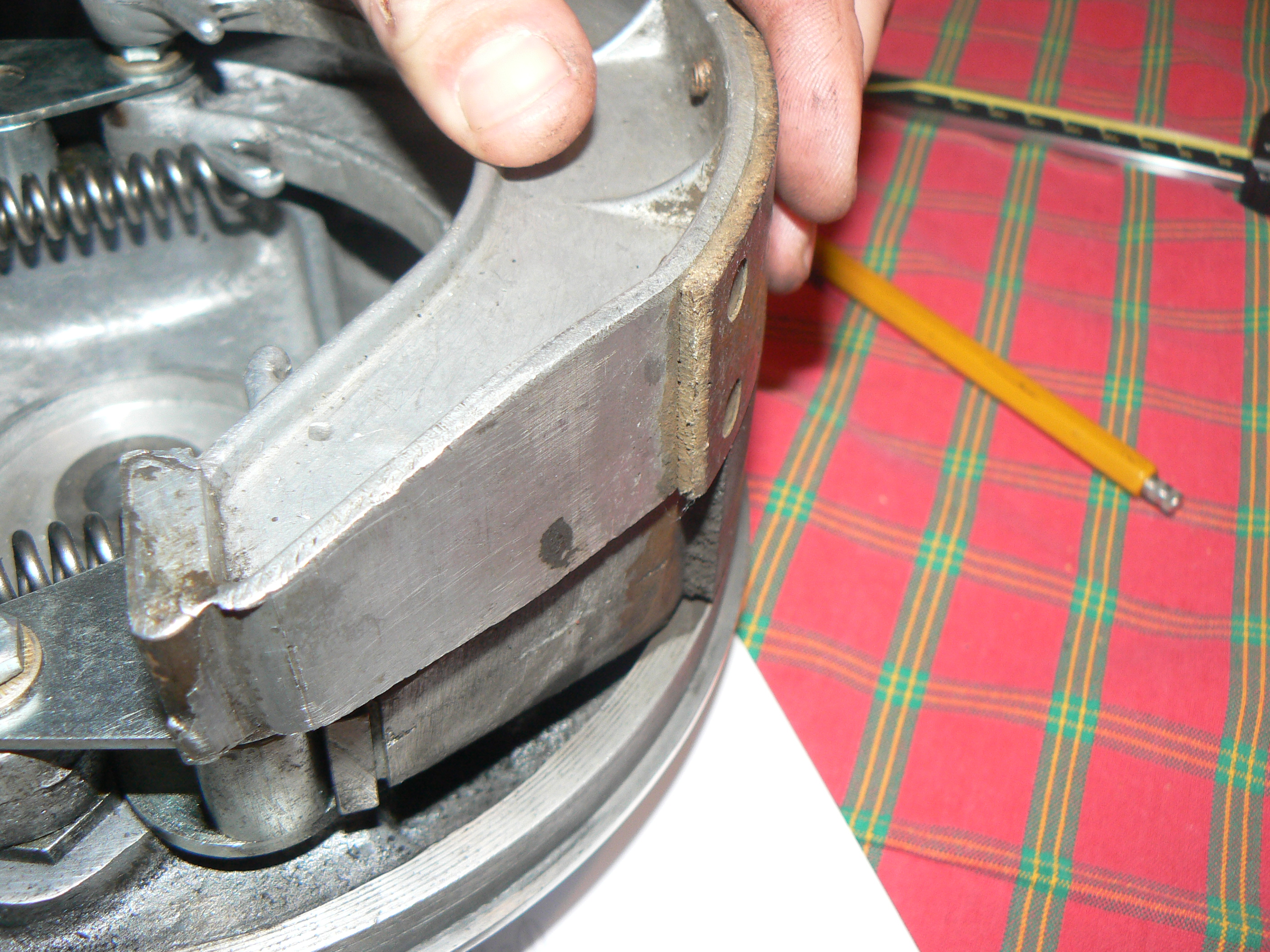

Commando tls operating arms will not work on your John Tickle plate as they are different and I don't think they could be adapted. The arms on my Tickle brake arm are made from flat bar so could probably made from scratch quite easily. I can upload pictures next week if it would help.
graham
thanks for info it is not necessari tomorow i will go to someone who have complete brake in czech republic and i will copy parts and make new ,shoes i will use from sls norton.
