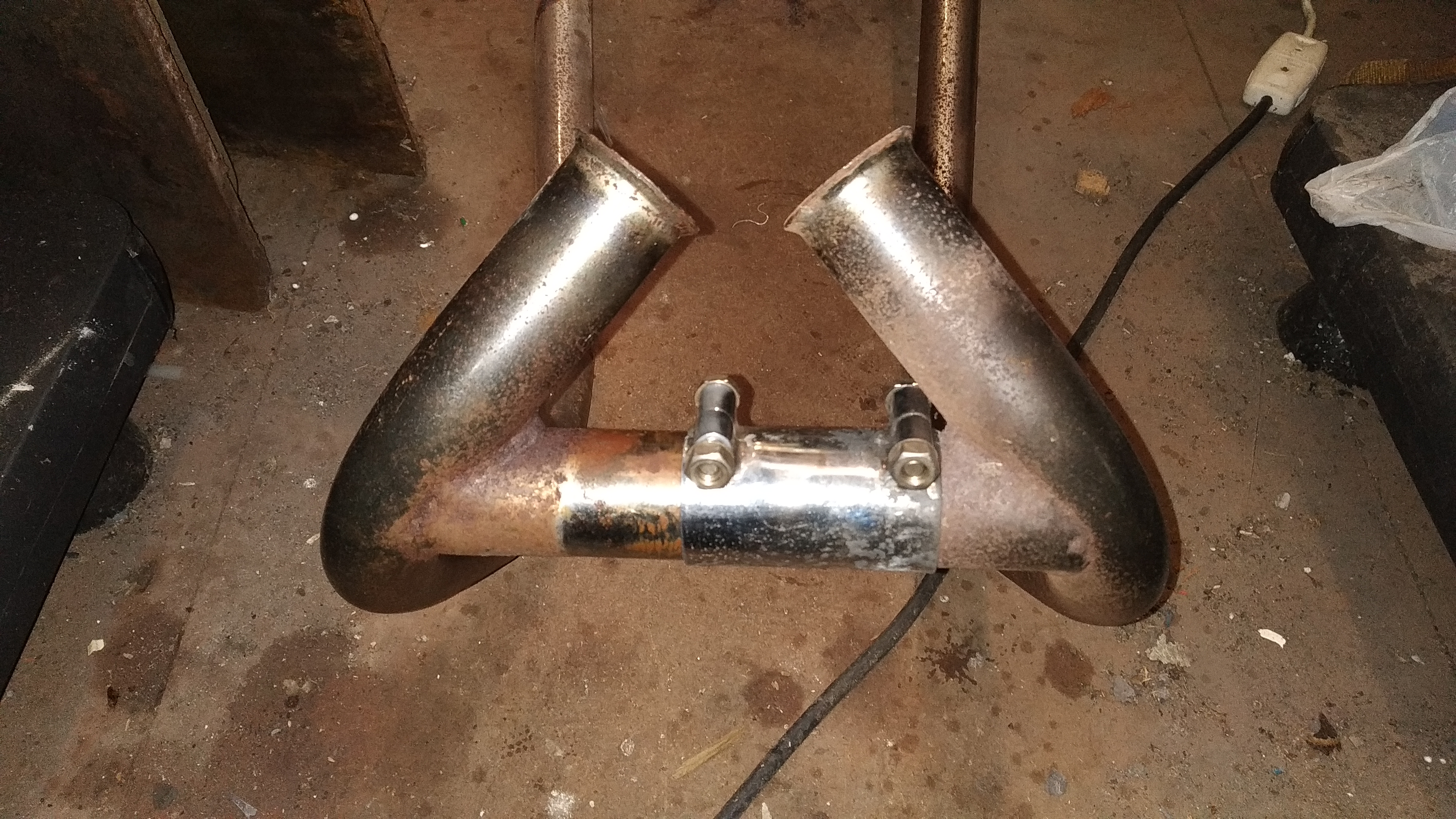

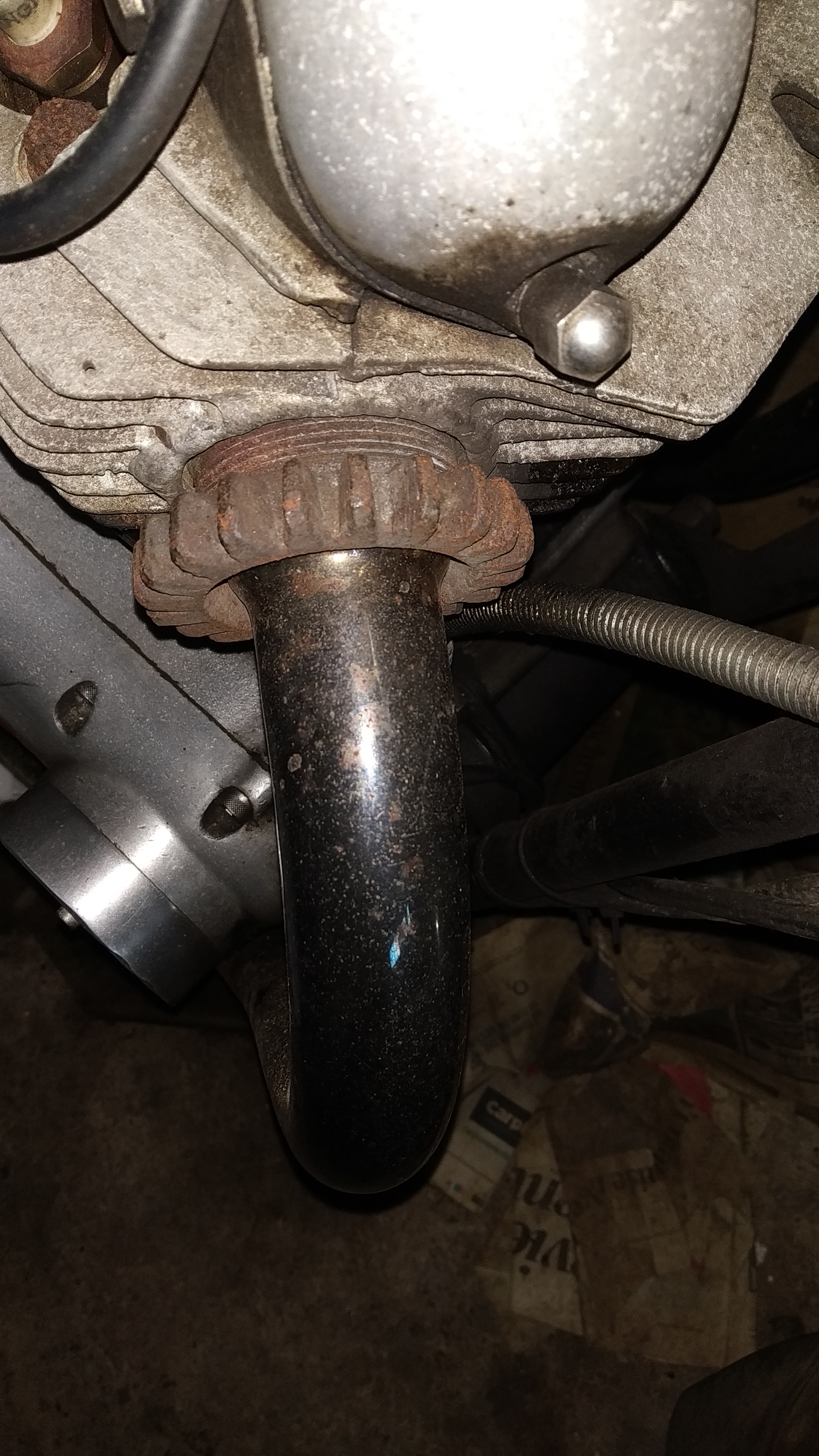

Photos attached are of set of MK3 pipes with balance pipe and a set of unbalanced pipes current on the bike but due to be replaced. Neither have that step in the pipe but it has been seen before.
https://www.accessnorton.com/NortonCommando/exhaust-headers-down-pipes.31173/
MK3 Balanced
Primary side
Timing side
Note that I retained the spherical seat from the MK3 setup for the unbalanced set with the flange type earlier unbalanced pipes, I find I can then move the pipe around a bit more and ensure the kickstart missed the timing side pipe by tucking it in more. Hence you can see the timing side one does not come out exactly straight, if I did not use the spherical seat it would come out straight.
