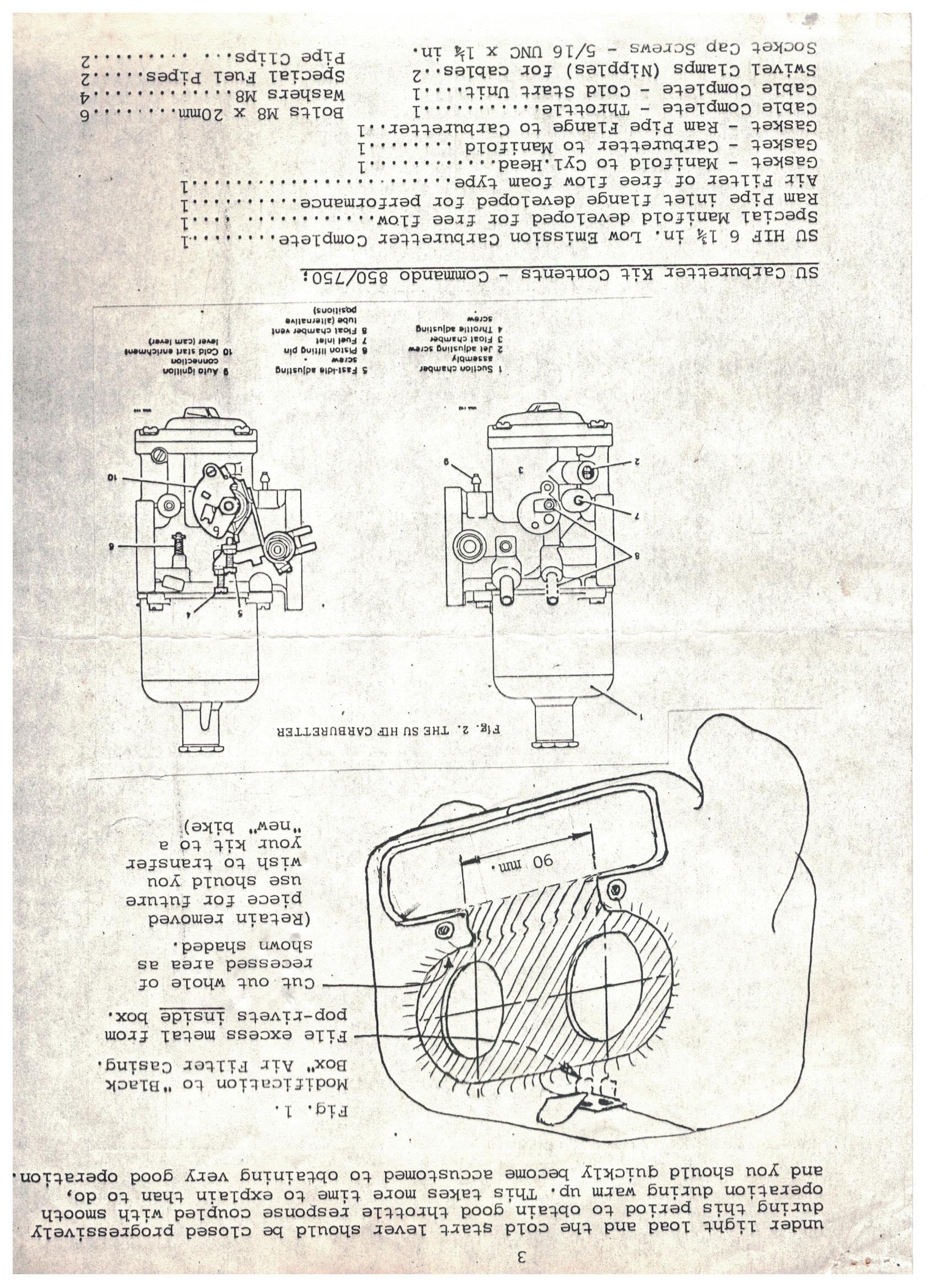

SU carb settings
This may help. It says start at 2 turns out. Sorry, but not had time to look at mine yet.
R
Instructions
Thanks for the instructions, very useful, mine have completly faded!
