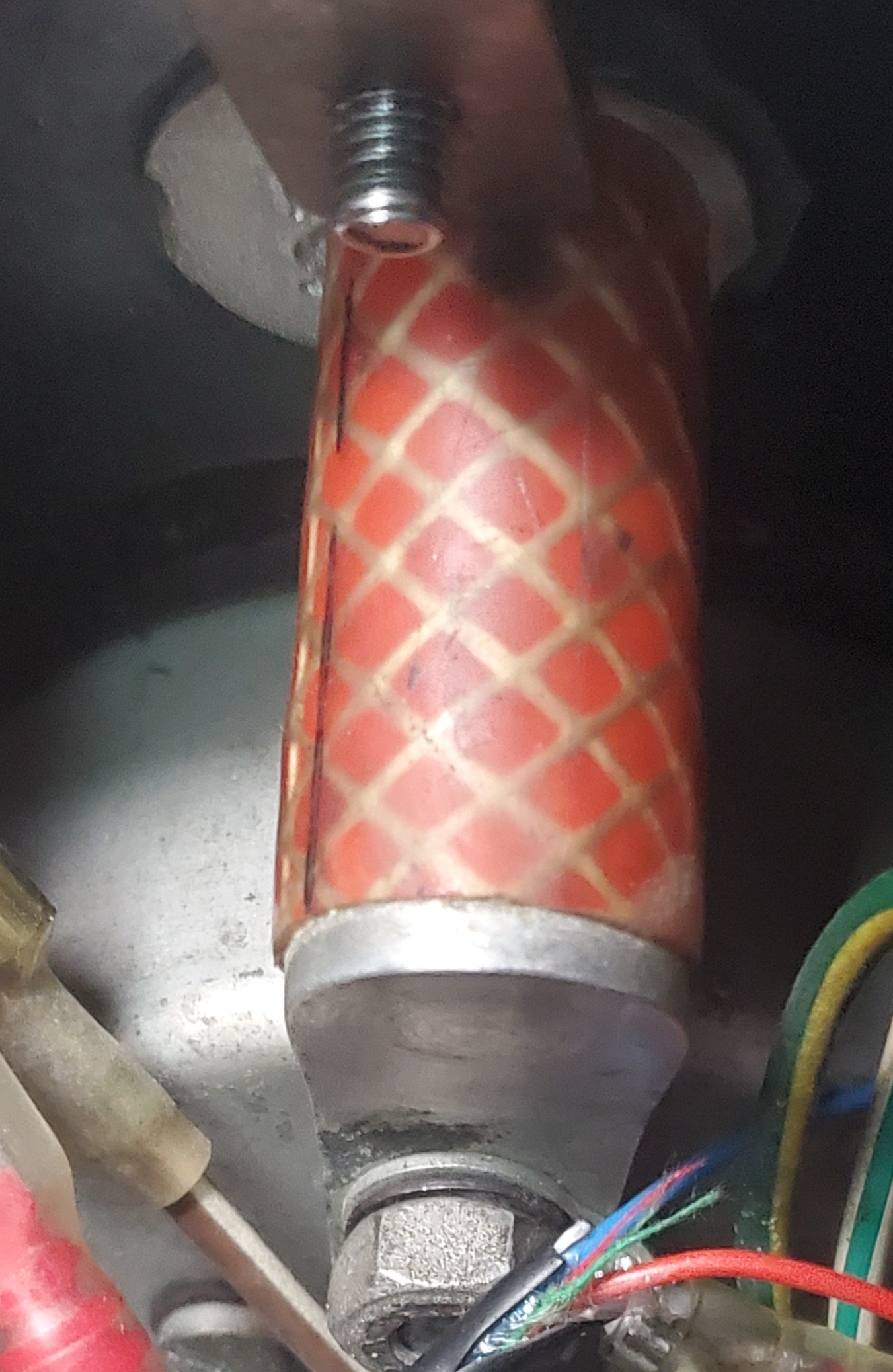

My PO made up a support from below.  Alloy bar attached below speedo fixing and plastic tube to hold it in place.
