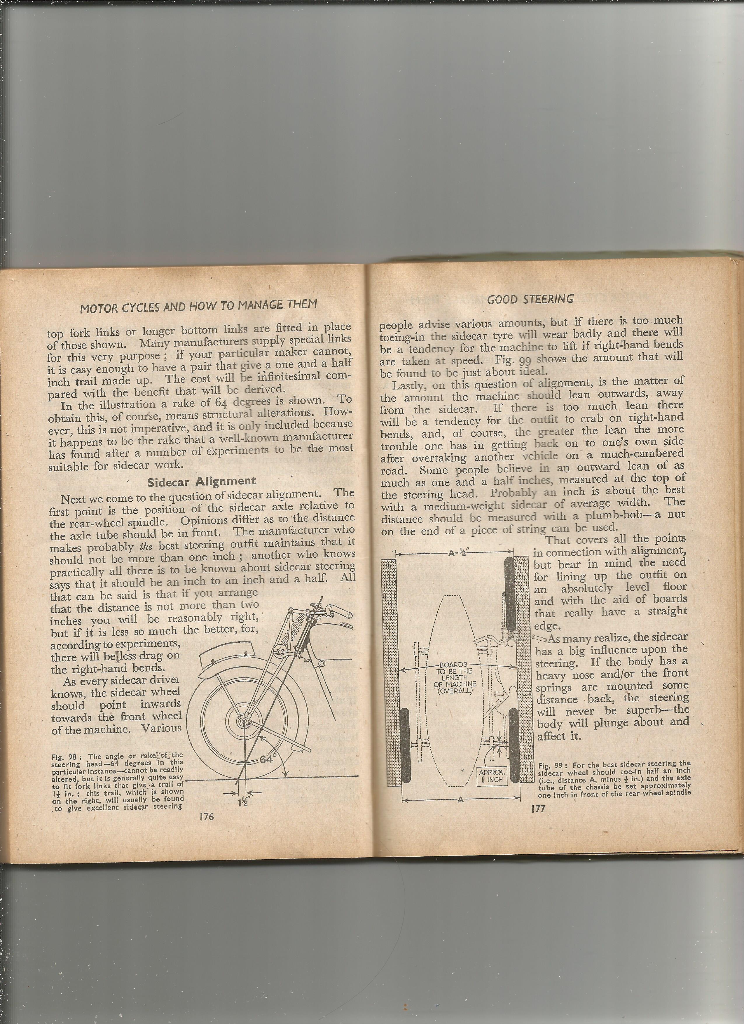

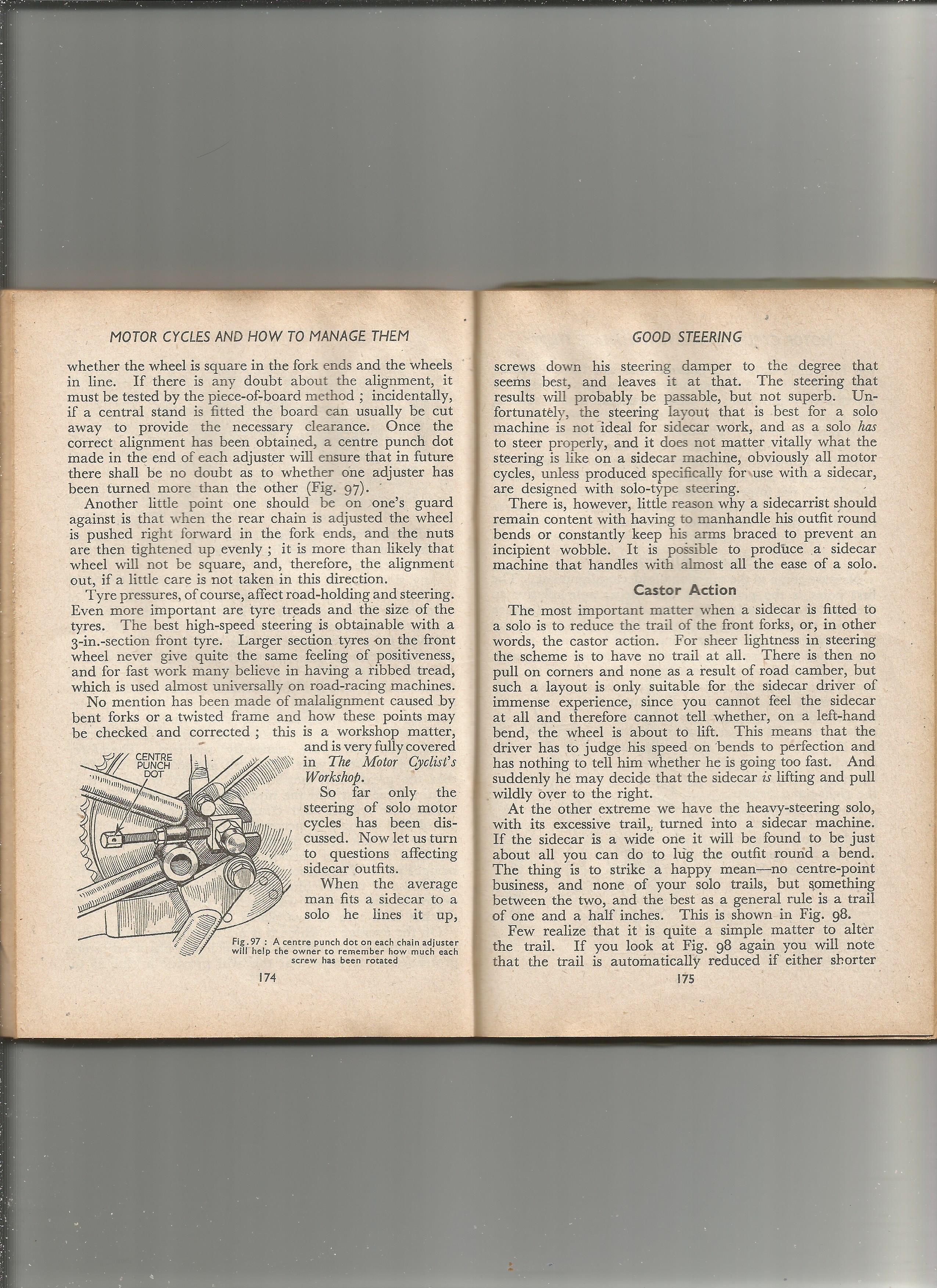

Hi again John,
   I found out one of my dad's old books this morning with some info on sidecar set-up which you might find useful, and have attached below. There seems to be many badly set-up outfits nowadays and I think people believe everything just bolts up equally without realising the forces involved. This is a very old book, but all the measurements are relevant to featherbed and all conventional framed outfits. Read fully and you will get an idea of how the castor angle and trail can be changed to stabilize and make the steering easier. If you are new to sidecar driving, don't overdo those left-handers !
